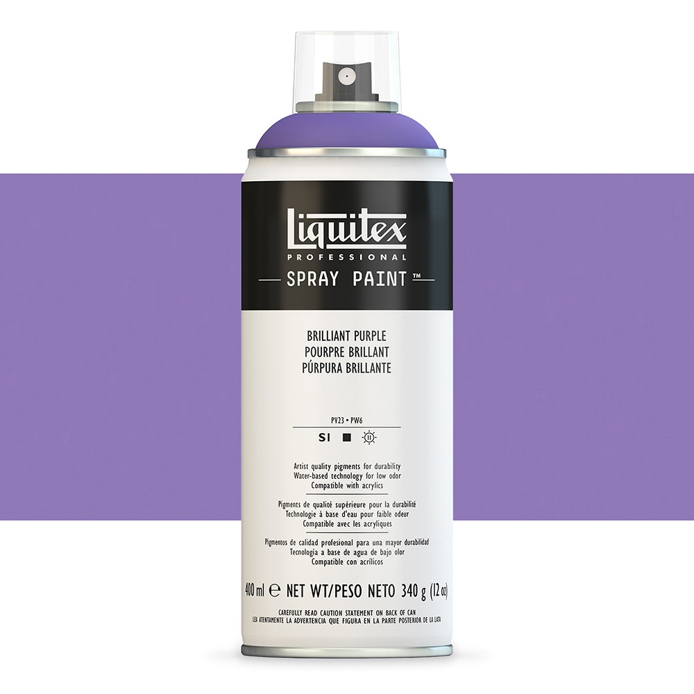

    I have landed on a colour:

    Although I have the "spray booth" now on the balcony... I still think a low odour water based spray will make my neighbours happier
    Since I have two pick guards (I hand made one for the previous JZ-6 out of ply wood), I am going to spray one in the Liquitex "Parchment" and just see which I prefer...
    Sprayed the pick guard today. Loving it already.
