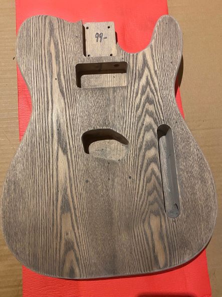

    Well, I have to be honest - I'm a bit deflated with the "prepping the body" stage. I feel like more and more effort is producing diminishing results.
    There's a lot to it, obviously and perhaps I was a bit naïve in not realising how much would be required.
    Thanks again for all those of you who gave me advice on body work up until now (and apologies for missing some of that advice along the way).
    I've sanded, applied timbermate, sanded some more, applied more timbermate, sanded some more on top of that and then done more sanding. But the body that I've received has a lot of blemishes and I have spent many hours trying to sand those out. My fear is that I will end up sanding in more disasters than I am fixing and, to be honest, I'm done.
    At the very least I think I've brought out the grain in the ash (and perhaps learnt a little along the way).

    The photo isn't 100% accurate as it really isn't that dark - but, sigh, I suppose I should sand it back some more, huh?

    Personally, I think the grain is looking pretty good as it is right now. Not sure it would go well with a Coolangatta Gold colour, but that may be subjective.
    Also worth noting the regularly reported issues with dingo tone finishes. This is a good time to think twice before committing.
  8. #18
    Dingo Tone seems to have around a 50% success rate. When it works, it's fine, but by all accounts it seems very sensitive to temperature and humidity (or it maybe that different batches end up with different properties) and if they aren't in just the right window when applied, it can take ages to go hard. Sometimes it just stays tacky for ever.
    If you still want to use it I'd definitely test it on some scrap wood first (use all the coats and let dry between each coat) before applying it to the guitar.
    And yes, use the same finish on the maple board as on the back of the neck (regardless of what finish you chose to apply).
    Your timbermate is pretty dark. The main grain pattern lines are also pretty close together, which is making it look even darker. For a good Springsteen butterscotch finish, you'd really need a different body, ideally swamp ash with a much wider-spaced grain pattern so there's a lot more basic wood and less grain. And maybe have used a lighter colour Timbermate. For more authenticity I'd use an amber tint nitro spray as well for the colour, not stain.
    Why not give up on the Springsteen Esquire look for this one and concentrate on making the most of what you have? The next one can always be the Springsteen one.
