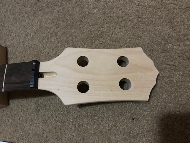

    My PBG custom order has arrived - 3 months early.
    I got a SSR-4 - 34 inch neck and a PB-4 hardware kit. I have also picked up a JB type pickup and a bridge cover along the way.
    Today I cut and sanded the headstock
ID:	40865   Click image for larger version.

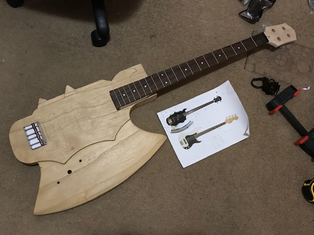

    coming along well! I'll be trailing a fair bit behind you. My kit arrived the day I went into surgery. My Brother picked it up from the post office for me, but hasn't been able to drop it off and now he's in lock down . I have all the hardware for it, and the paint, just need the kit!I ran the laminated blade blank through the thicknesser today... your axe is gunna be sooo much lighter!

    Looking good, Trevor. It's going to be interesting to see that blade come together. From what I'm seeing on my project, the finishing on paulownia toughens it up somewhat, but that's a bloody thin edge...
