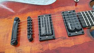

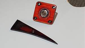

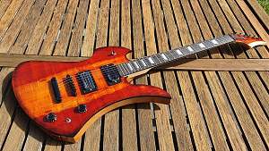

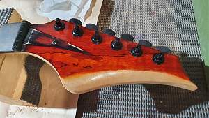

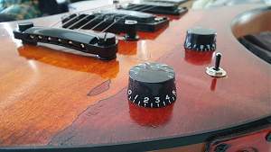

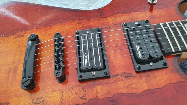

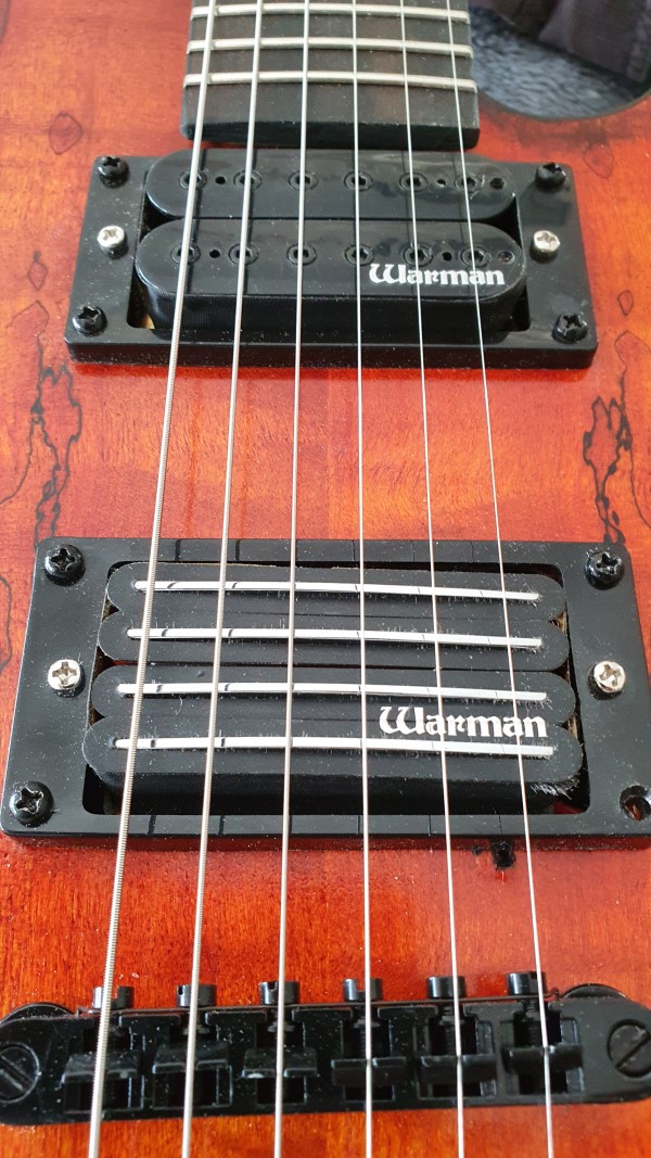

    Here is my special order mockingbird,
    24 fret, spalted maple top with black binding.
    I have fitted a pair of Warman pickups with split coil push pull pots.
    Mini toggle is set up to switch between .22 and .47 caps and also kill switch.
    Top is Crimson stain and finished with a clear lacquer.

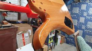

    A few more pics

    Johnbamb Mockingbird
    It’s nice to see some of the weirdo shapes getting a look in, we’ve got a couple this month that are refreshing to see. Some lovely custom touches with the jack plate and TRC and a cohesive approach to colour and finish. Looks to be a missing screw on one of the pickup surrounds? Otherwise a very solid effort.
    I really like the colour of the body, but was surprised to see grain – it looked like gloss at first. Definitely set up to be a player’s guitar.
    Crazy good looking top with the spalt and grain showing through the stain. Love the contrast with the natural back and echoes of both on the headstock. Nice hardware upgrades and feature touches. A really striking guitar.
    Incredible use of a great spalt top. The subtle burst suits the guitar well. You might want to clean the steel wool bits off your pickups. They can cause havoc.
