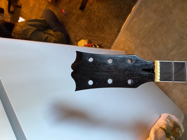

    so I had seen one of thise videos already in all my searching. I have already started on the method I have chosen. I have been hand sanding for several hours to get the black dialed back to show the quilting. Its not going to be the exact finish i desired, but I think its going to look very good, I also hand carved the headstock to match the LP look. Here are some pictures up to this far.Attachment 40005Attachment 40006Attachment 40007Attachment 40008Attachment 40009

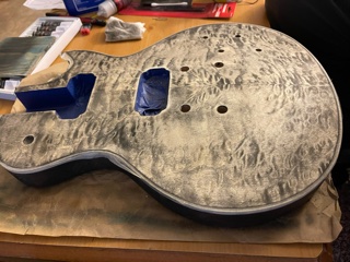

    So first I used a water based ink to lay my black down. It was an ink for craft rubber stamps. I then used 220 (USA) grit to rough it back, and finished with 320 (USA) grit. It is a pretty fine grit, so it took me a while to sand it back. But on the plus side it didn't eat through the Veneer, and it is finish sanded at the same time.
    And thank you for the complement, I have been very nervous about messing it up.

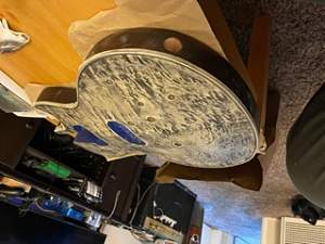

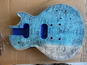

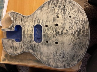

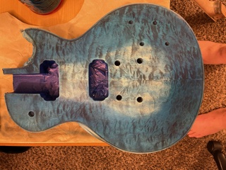

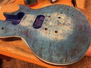

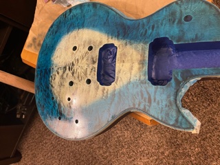

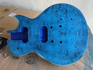

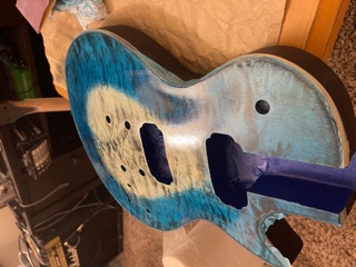

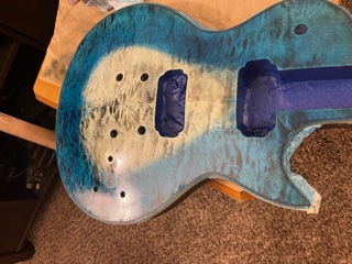

    Thank you, so I have been very busy today as you'll see by the pictures. I figure out to get the exact finish i was seeking in the first place. So the black was straight forward, black it and sand it back to show the grain. I accidentally figured out how to get the white, i meant to do a wipe down with my mineral spirits, and used my acetone instead. Well it turns out that the acetone does a bleach like effect. I then airbrushed cyan blue, this also was a water based ink meant for craft rubber stamps, and sanded the blue back to reveal the silver. I am still getting the final tone where I want it. But here are the update pictures for today.Click image for larger version.

ID:	40019Click image for larger version.
Name:	image0 - Copy (4).jpeg
ID:	40017Click image for larger version.
ID:	40020Click image for larger version.
  5. #14
    Member MadMike's Avatar
    Mar 2021
    California, United States of America
    11
ID:	40022Click image for larger version.
Name:	image0 - Copy (3).jpeg
ID:	40023Click image for larger version.
Name:	image2 - Copy.jpeg
ID:	40024Click image for larger version.
Name:	image1 - Copy (3).jpeg
ID:	40025Click image for larger version.

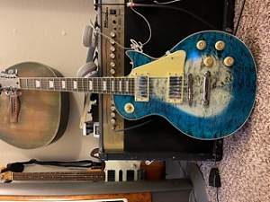

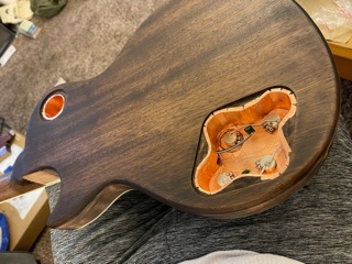

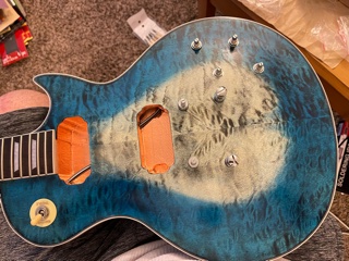

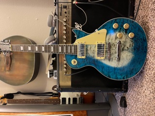

    Ok so sorry I haven't posted the past couple days, I've been very busy. But I have made some major strides in my guitar. So I have made a couple changes to my original staining of the body and neck. I had some scuffs in the neck, so I went back and resanded it. I decided I like the wood grain showing, so i did this fancy two tone job on the neck. I sprayed 18 coats of polyurethane / mineral spirits mix. I set my neck. and have assembled it while I am waiting for the clears to cure so i can buff it out. I still have to put my EMG pickups, but I will wait till I buff it out. I have one fret that buzzes, the 2nd fret, will be easy fix. She has a supper low action, sounds awesome, and looks goodClick image for larger version.
ID:	40076Click image for larger version.
ID:	40077Click image for larger version.
ID:	40078Click image for larger version.
ID:	40079Click image for larger version.
ID:	40080 to boot. Here are some pictures to catch you guys up.
ID:	40081Click image for larger version.
ID:	40082Click image for larger version.
ID:	40083Click image for larger version.
ID:	40084Click image for larger version.

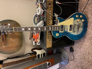

    Here is one more picture for now, of my guitar hanging with my other babies. I'll be back at it in about two weeks, I need to let the clear cure before I start buffing it.
    I am so impressed by this guitar. The sound it makes is amazing, the playability, the feel of, I just can go on and on about what I love about this guitar.Click image for larger version.
