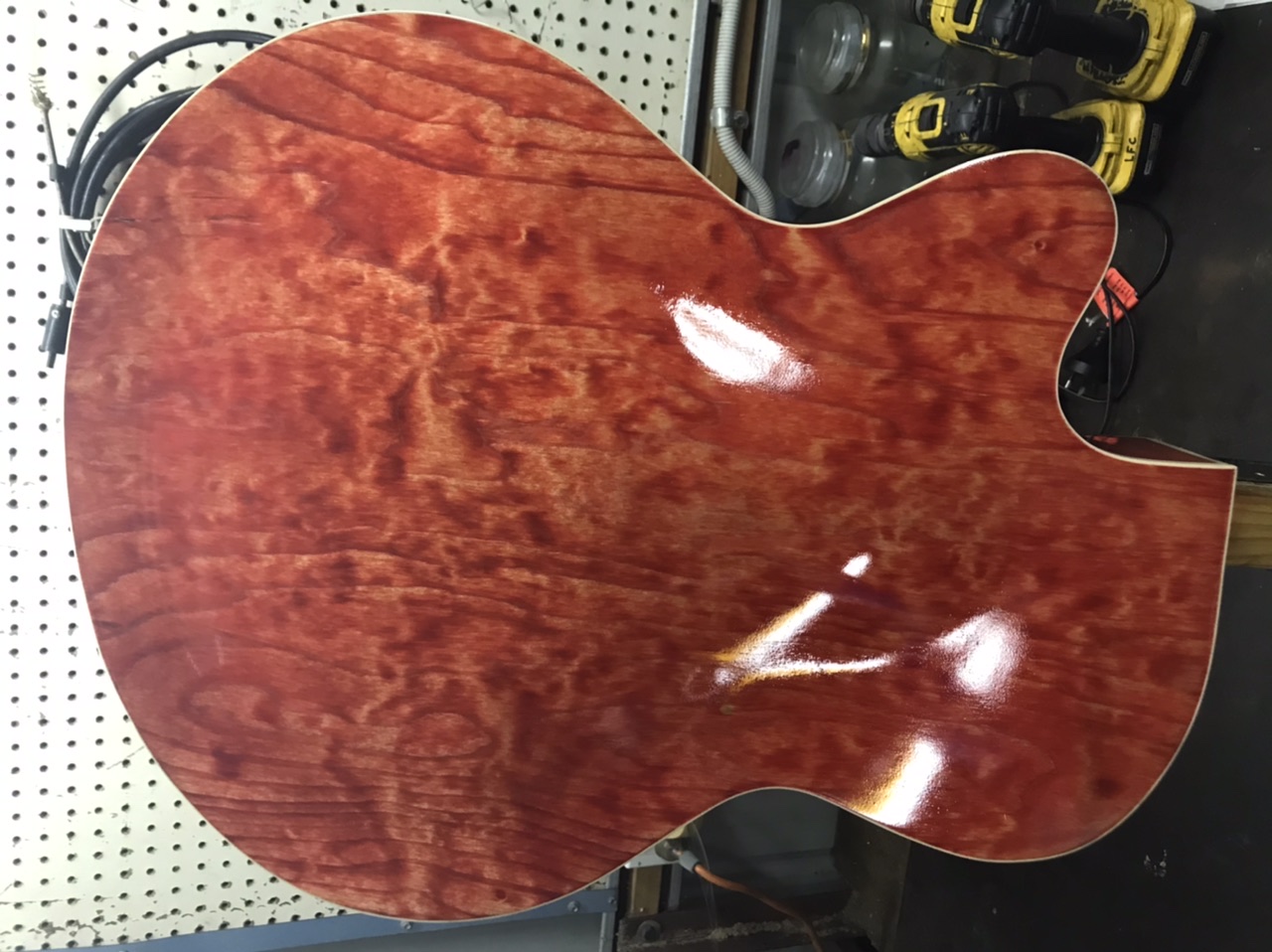

    Thanks. The body is coming up better than I hoped for. Starting to look really good. Got a couple of the intensifying coats on and got a fraction darker in the red which made the lighter grain stand out. Not quite how I was picturing it but am liking it a lot. Got a few days off so hoping to get a clear coat or two over it by the end of the week.

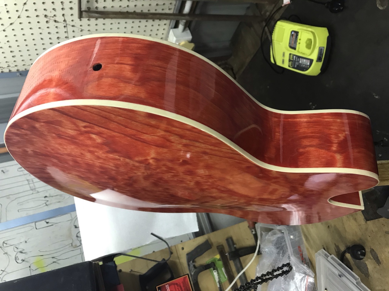

ID:	39593so this is yesterday’s effort on the body - a couple of clear coats over the dingo process. No rub back yet. Probably a couple more coats and a final polish will see me pretty happy I reckon. Still undecided on the neck.

    Oh that is looking superb Rossco! I love the grain feature on the back, some really nice shine there too. Great Job!
    1,979
    That is nice! Love the grain and the colour.
  6. #16
    The photos really don't do it justice. It is starting to come up pretty f*&*^n nice . I think I have scored pretty damn well on this kit!!! Thank u pitbull!!!
  7. #17
    Very nice!
    What are you using for the clear?
    I'm not really a hollow body fan, but that's definitely a looker!
  8. #18
    Mentor dozymuppet's Avatar
    Jun 2020
    842
    That's some amazing detail and depth.
  9. #19
    Mentor robin's Avatar
    Brisbane
    1,513
    That looks delicious Rossco.
  10. #20
    The clear is Cabots exterior in gloss. I have used this before on a few timber pool table parts and once it has properly cured does not seem to attract dust or finger prints any more than any other finish. Thanks for the comments.
