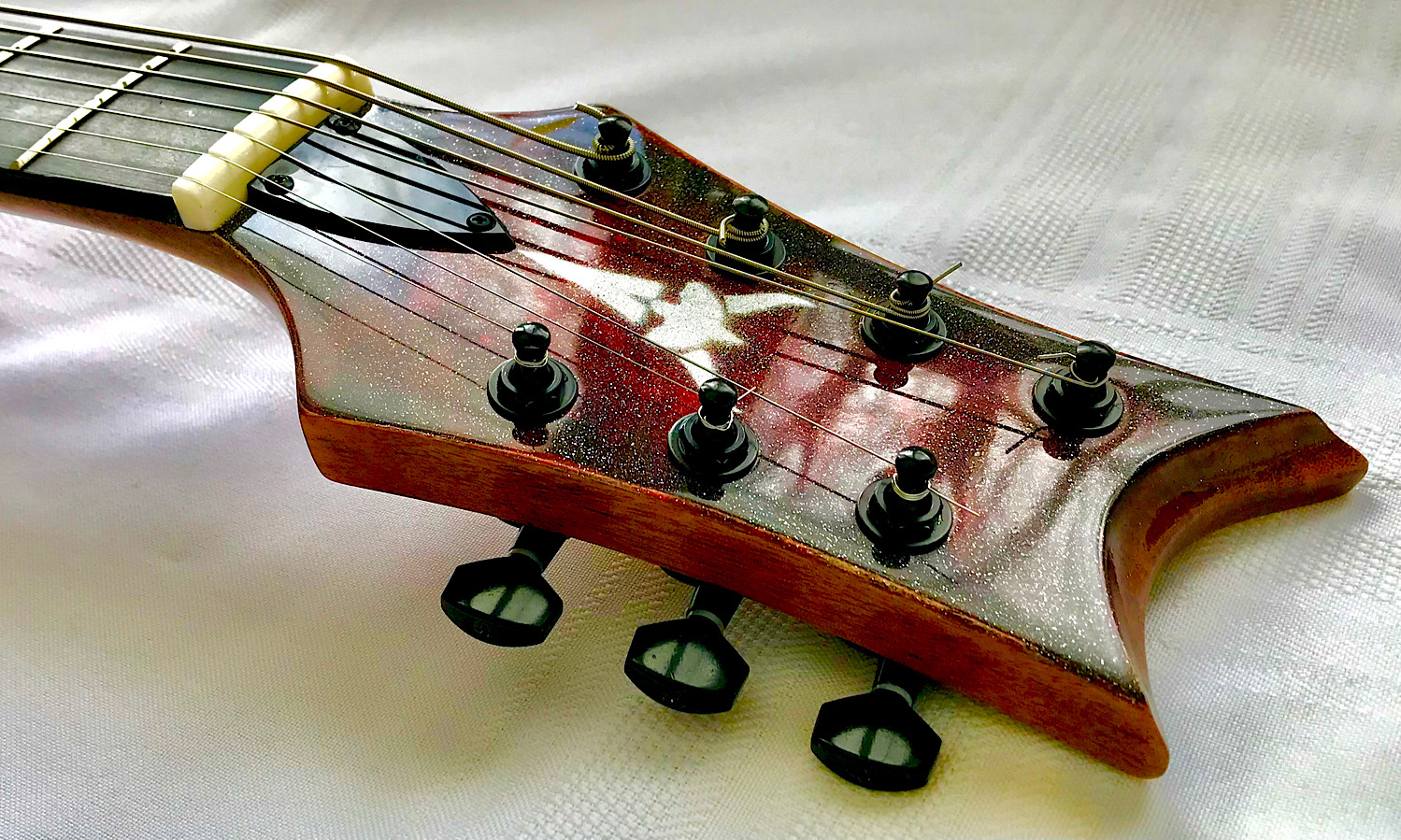

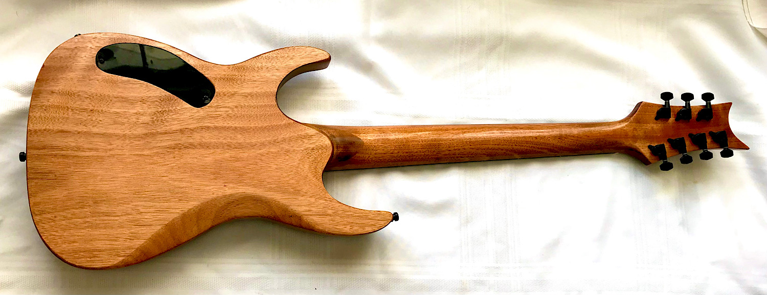

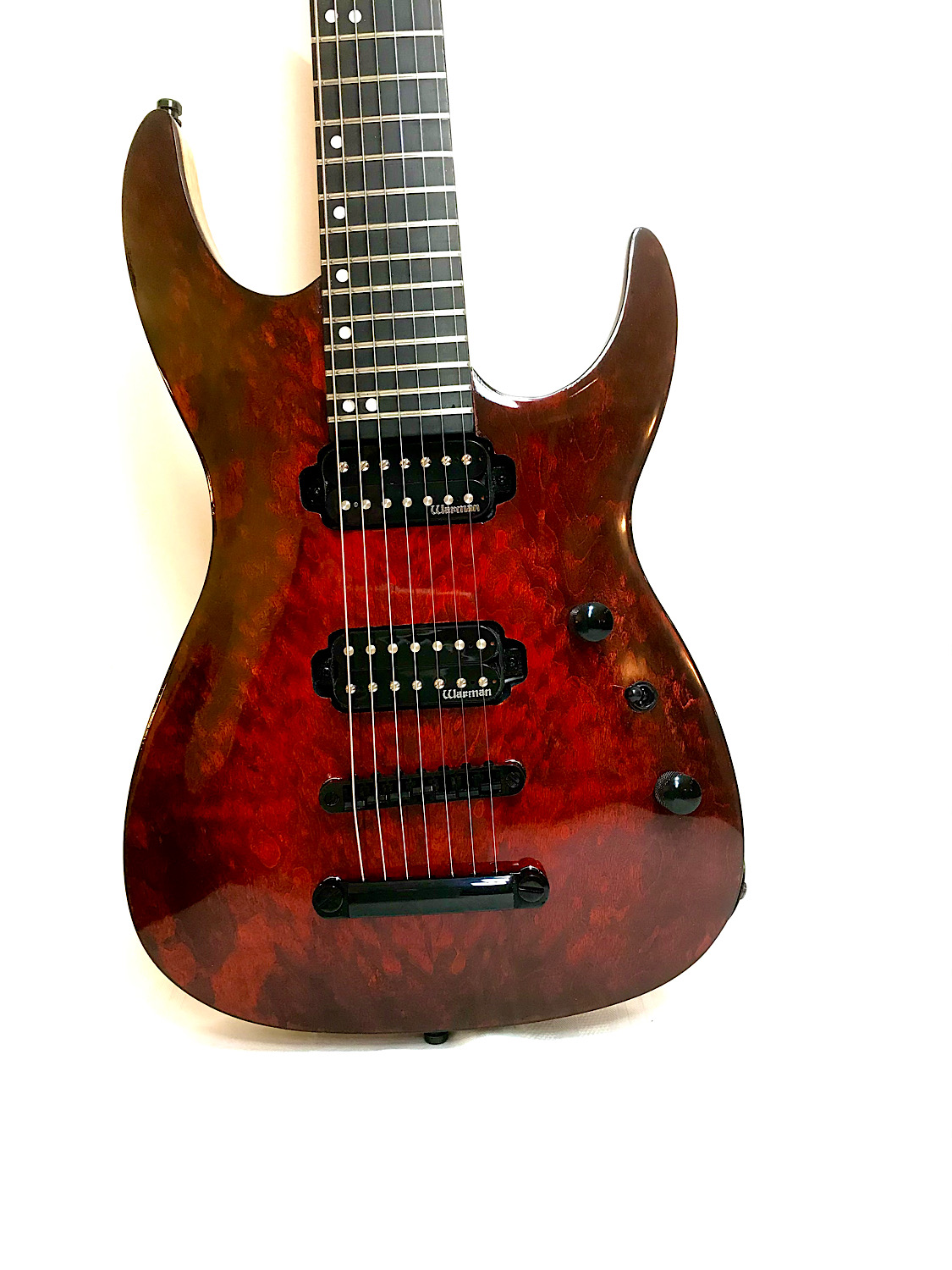

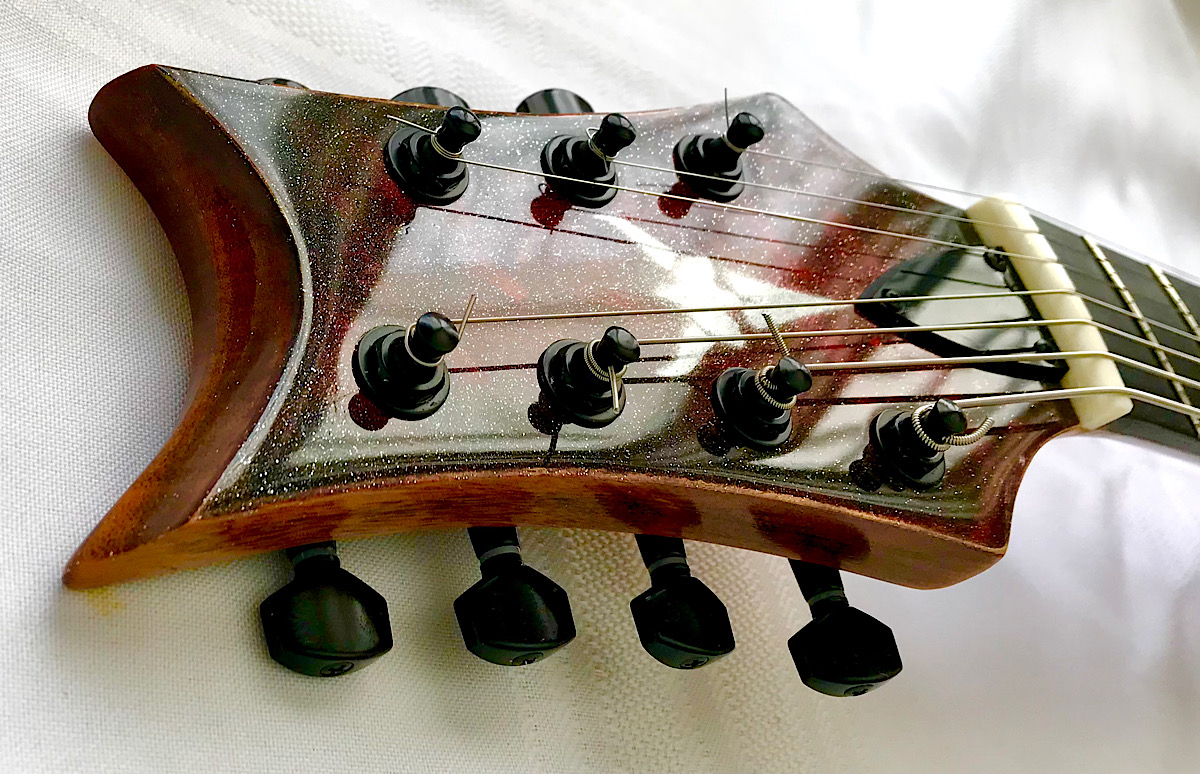

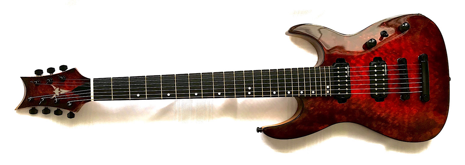

    My GS-7Q

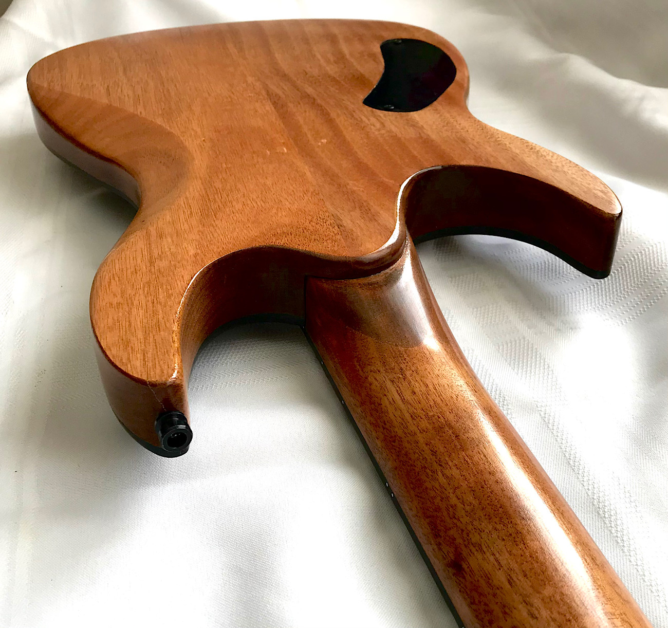

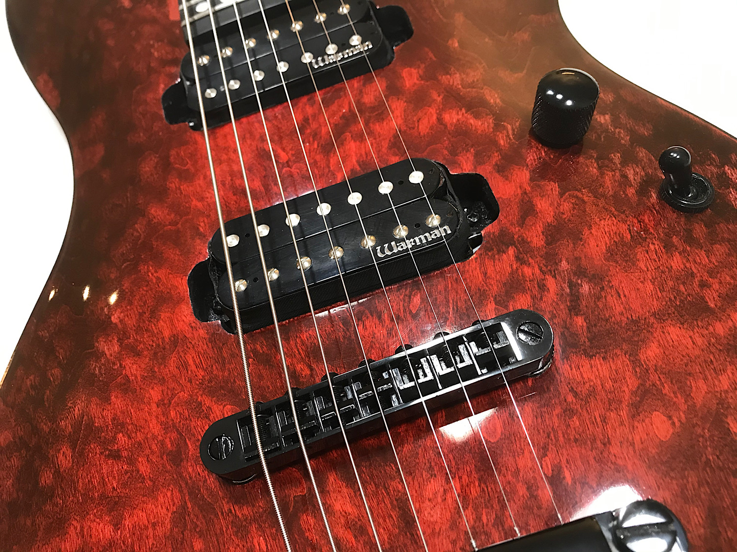

    Finish on this guitar was a homemade wipe-on poly. Pickups upgraded with Warman Deadly Sinners set, direct mounted into the modified cavity. All pots and wiring upgraded. Neck heel modified to better fit the neck pocket.

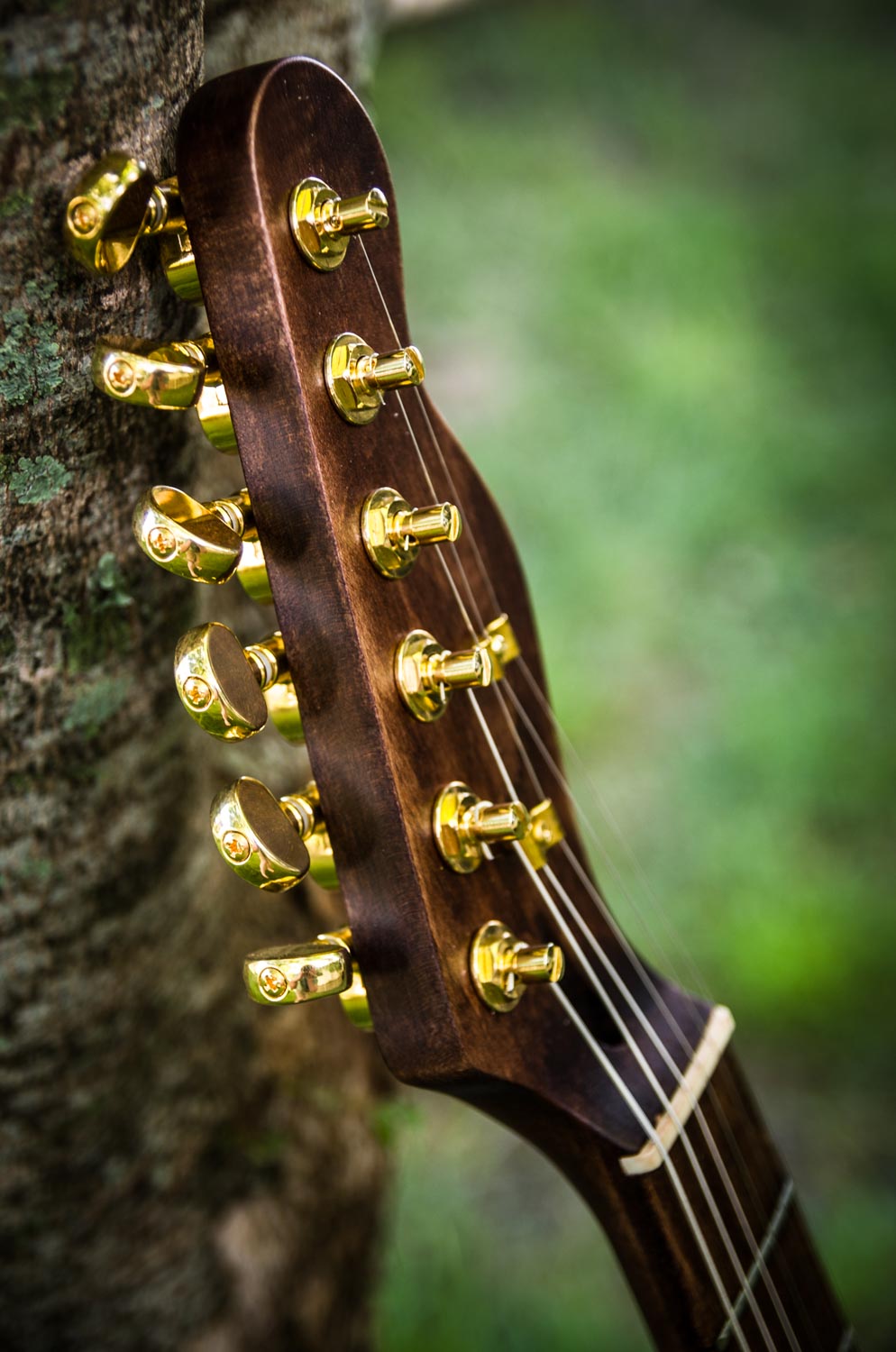

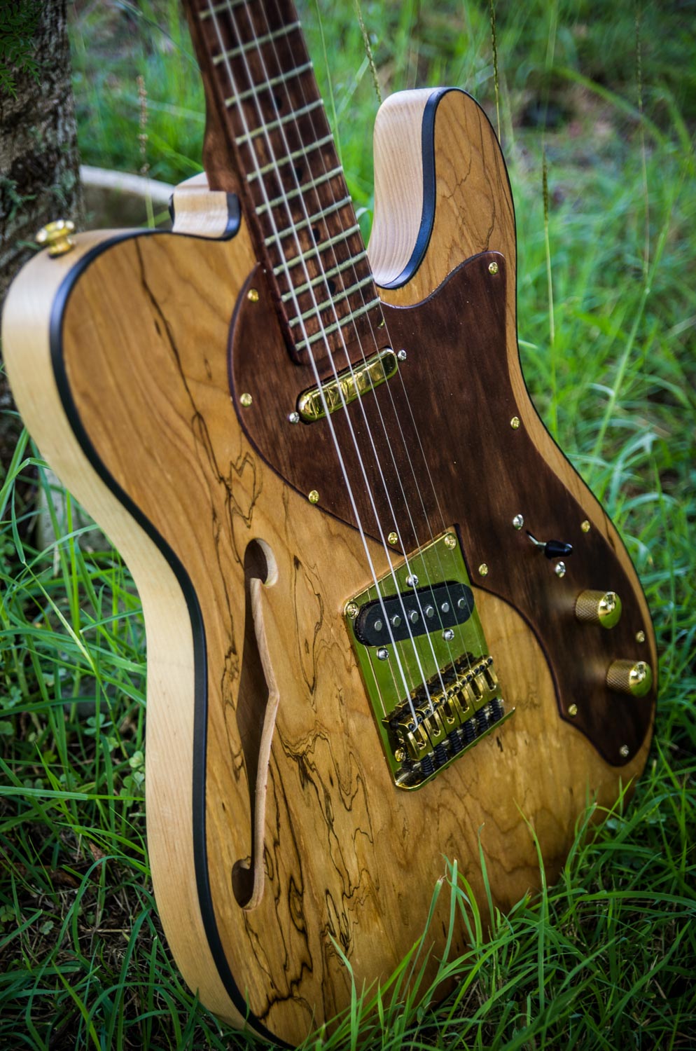

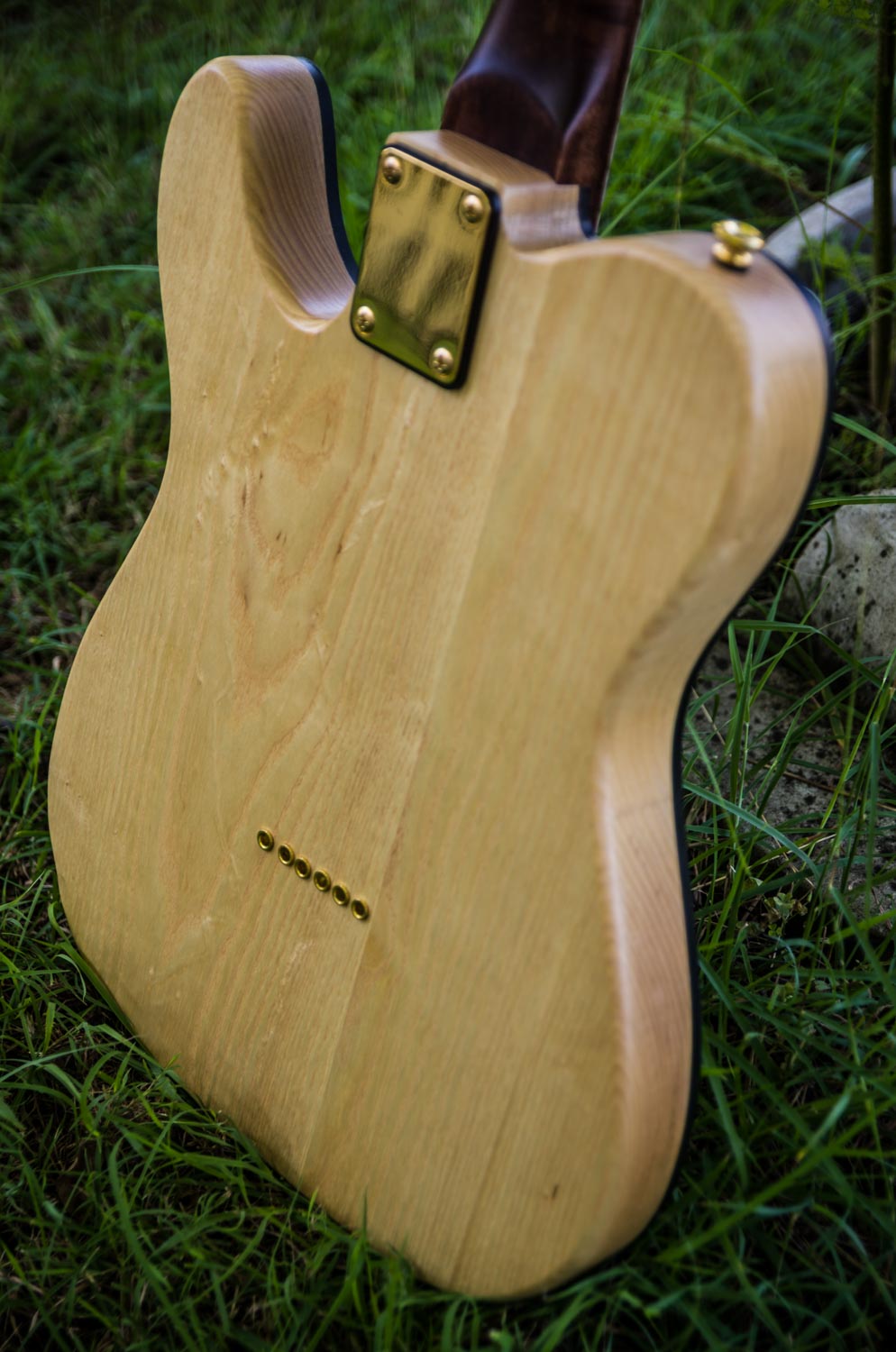

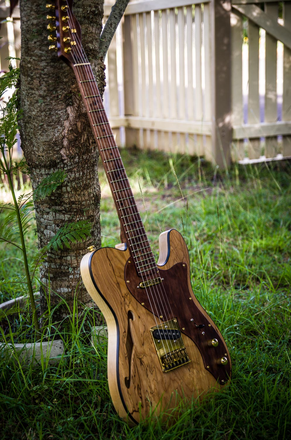

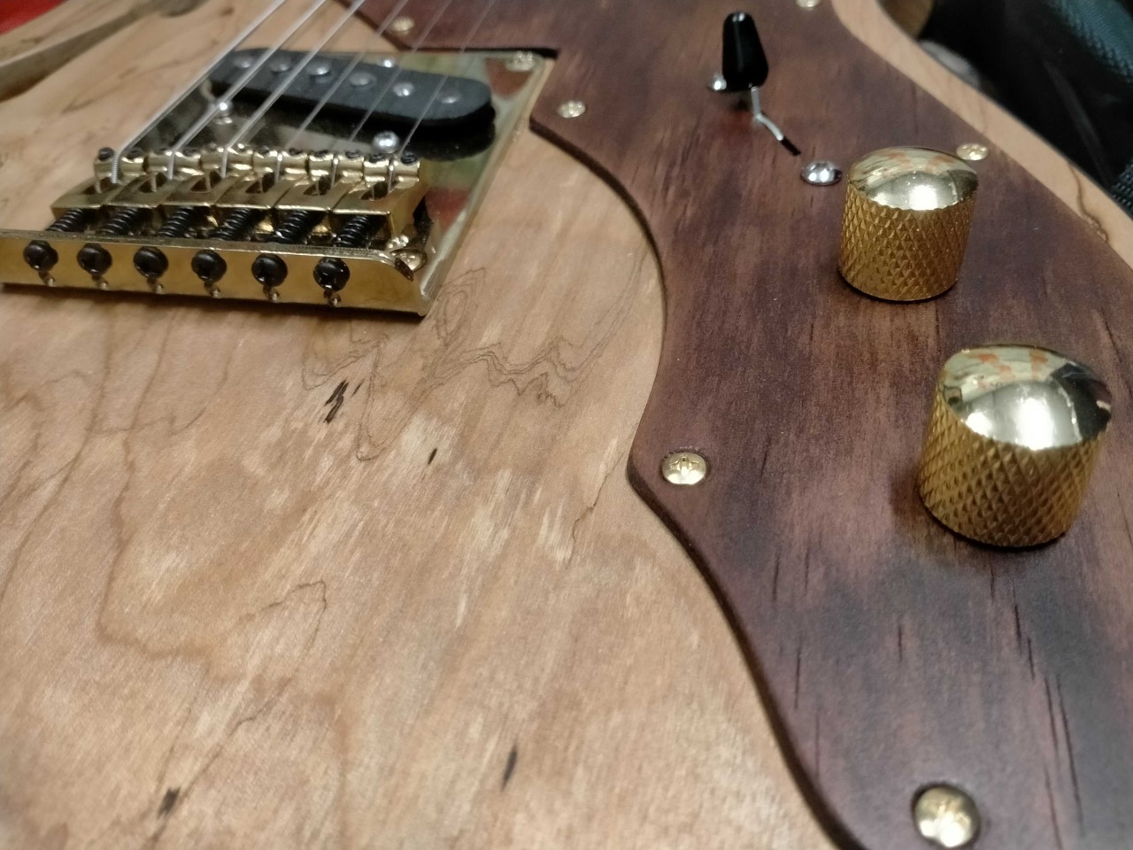

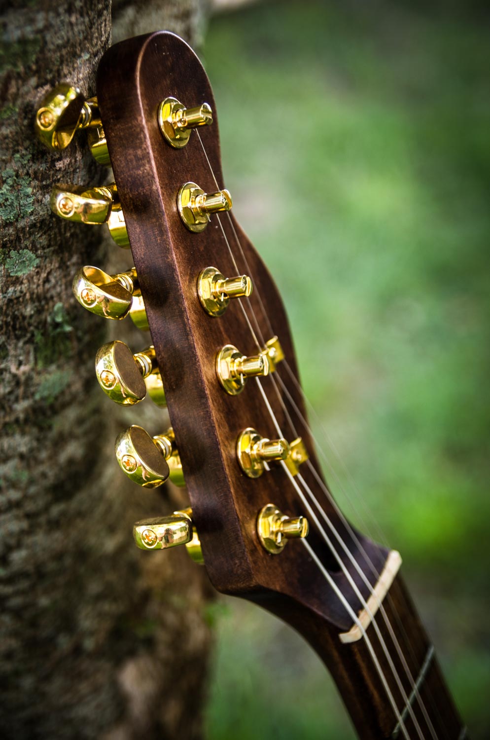

    This is my ATL-1SB kit, and it's my first Pitbull build. It features a stained neck & headstock, and custom plywood pickguard that I made. The finish is a thin satin polyurethane, which is thin enough that you can still feel plenty of grain.
    The guitar is built for live gigs, and includes the following upgrades:
    - Tonerider Hot Classic pickups
    - bone nut
    - Grover locking tuners
    - converted to string-through setup
    - fully shielded internals
    - full size Alpha pots, Switchcraft jack and Fender-style selector switch
    - shielded pickup wire feed tube for easy maintenance

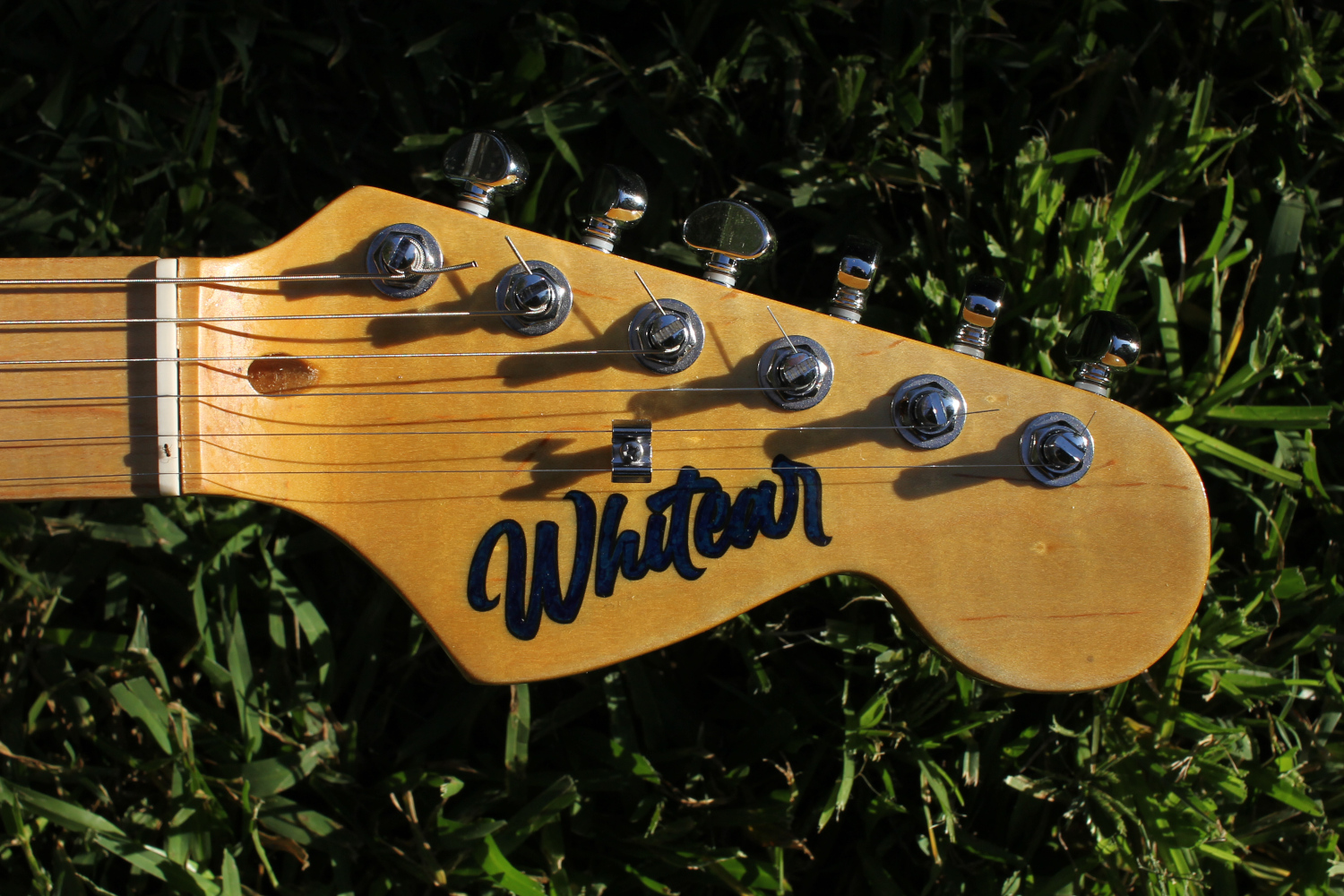

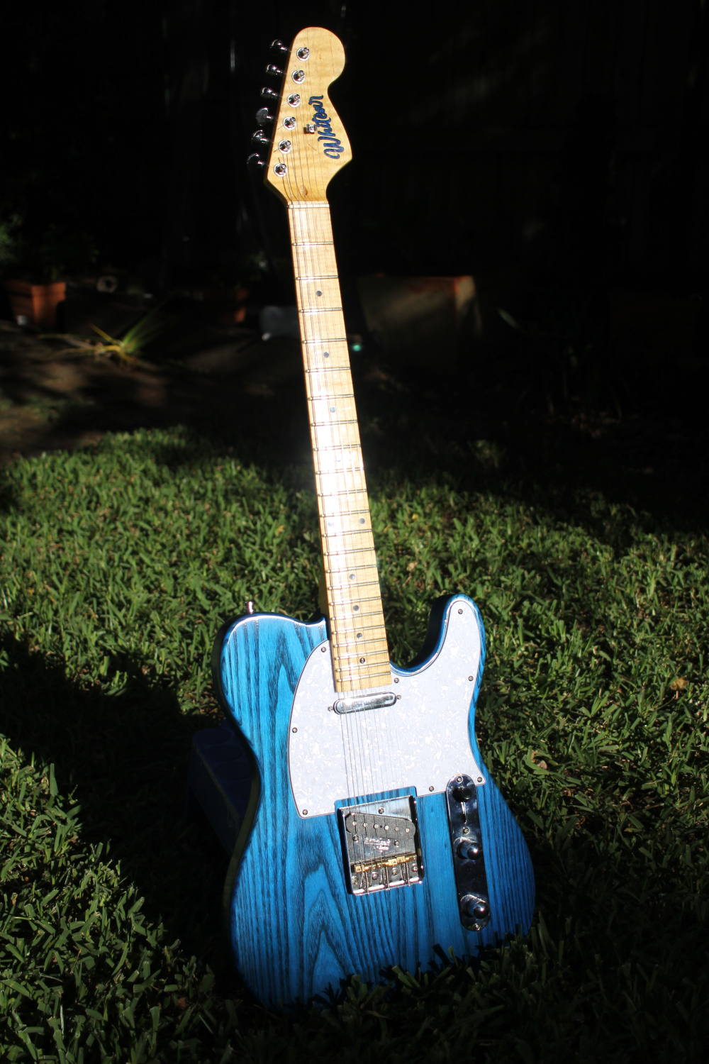

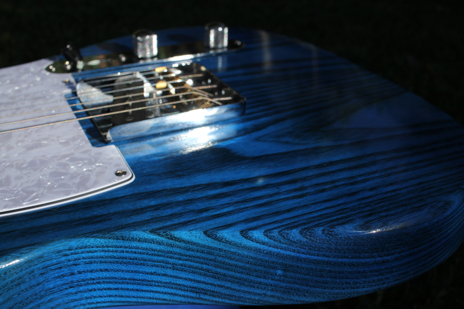

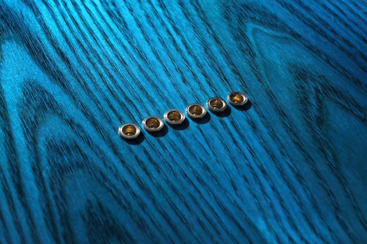

    Here's my DTL-1, finished in transparent blue nitro.
    Upgrades are:
    • Grover looking tuners
    • Bone nut
    • Tonerider Hot Classic pickups
    • Wilkinson bridge w/ string through
    • Pearloid pick guard
    • Strap locks
    • Oak Grigsby 4-way switch, 0.022uF Orage drop tone cap
    • Electrosocket

    5: Eric67's GS-7Q
    Nice classic colours and beautiful finish. Hard to fault.
    It's a beautiful deep colour on the top and headstock, and the black hardware matches nicely. I really like the more subtle colour of the back and neck too. Is that glue or factory filler in the crack line on the upper horn? Nice mods and build choices. Well done.
    Finish looks real clean. I’m not sure the headstock needed the sparkles though.
    6: Kman42's ATL-1SB
    Very rustic feel with this one. Love the classic styling, which really gives full value to the grain. Nicely done. Can’t believe this doesn’t have a logo to own it.
    This is a nice TL. The grain with the natural wood tones and dark neck and pickguard are just fantastic. Topped off with the gold hardware and... wow. Ferrules are aligned well but some minor inconsistency in the spacing. Definitely something I'd pick up and play in a store. Awesome.
    The neck colour & pickguard really add something special to this guitar.

    8: Johnwhitear's DTL-1
    Very nice finish with the blue nitro, matched with the white plastics. The neck has just the right amount of yellow. The string thru looks perfect, great and alignment and spacing. That alone deserves applause. Great upgrades and overall build qulaity.
    Love the depth in the blue – not normally a colour I’m a fan of, but when done well, starts the creative juices flowing for a blue guitar to own myself. Nicely done logo and the whole thing comes together well.
    A great colour choice which really suits this guitar. Not as flash as some guitars, but very beautiful nonetheless.
