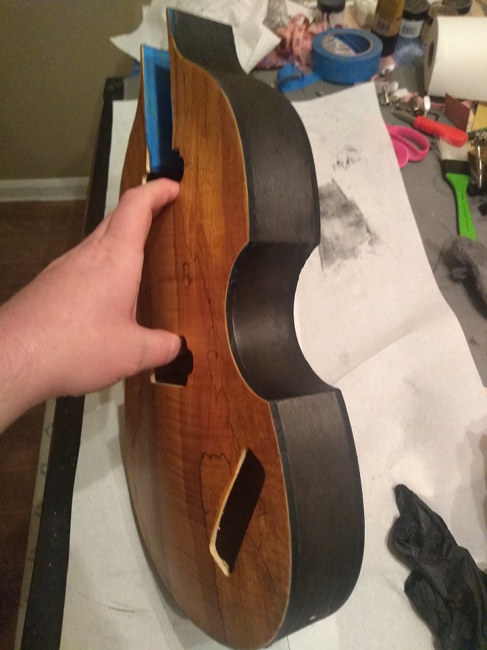

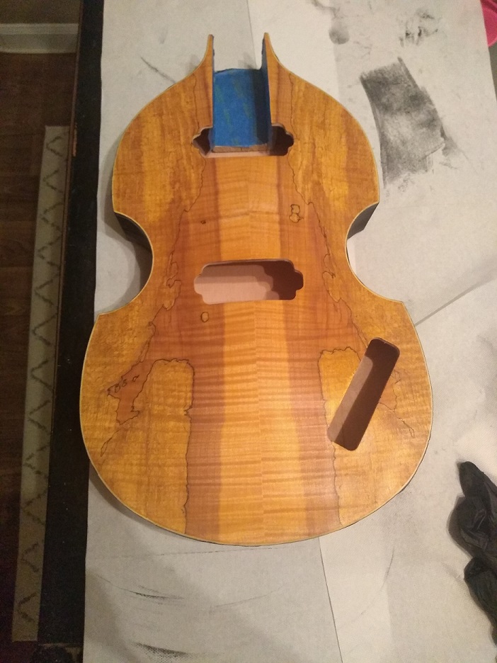

    So I've come to enjoy to come to enjoy the color on the body. As I applied a few more coats more of the gold highlight in the stain became more evident, and it gives it a very nice effect, albeit it's very difficult to see in pictures.
    I'm having an issue now where on the last coat of stain I applied, I started noticing it was leaving what looked like small dings in the body. I can use sandpaper to lightly sand, and they disappear after running over the spots a couple times, but this makes the stain a little uneven in the areas that need to be sanded. When I've gone back over it to add color back to those spots, I end up with more small dings I have to sand out.
    My (very amateur) belief is that due to maple being a hard, closed grain wood, maybe it's taken as much stain as it can and these are uneven spots where stain is just sitting on the existing stain and not being absorbed properly. Also, what would be my best approach? I'm thinking I may just need to reapply stain across the body, and then lightly sand the whole body, instead of just those areas, to get an even color and just leave it as is once I'm done and apply finish after it dries. I was also thinking (possibly insanely), to lightly apply stain with a high grit sand paper to apply stain while also preventing these spots from appearing, but I wanted to check with you brilliant folks first.
    Thank you in advance for any advice!
    Member c0ffinspire89's Avatar
    Feb 2020
    Kansas City
    76

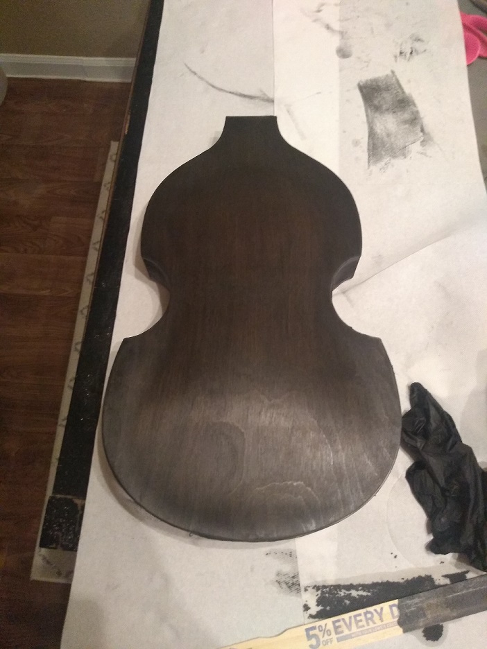

    The issue with the stain on the front is pretty`much resolved. After sanding I used a small brush to brush stain into the problem areas, which did not require more sanding to correct. I moved onto the black for the back and sides and oh my lanta it turned out great! It's a very rich, glossy black color, I couldn't be happier. I'm going to give it several days to dry and then apply some of the gold highlight coat I used on the front to add a gold glossiness to the back and sides. The neck will get the same treatment once it's ready to go. I'm thinking Tru-Oil over the body and neck once it's all complete, I think the colors will really pop.

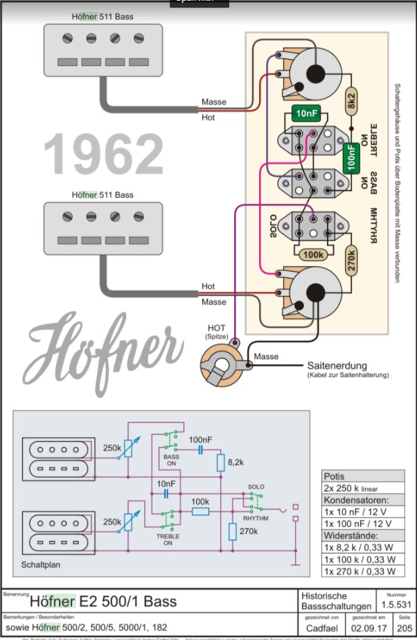

    I would be careful about ordering the Bartos without doing some very careful measurements. OEM Hofners have a pickup that is slightly about 7mm wider across the body and 5mm skinnier than a Rickenbacker pup. My guess is that the pups that come with the kit are standard mini-humbuckers that are closer to the Ric size, so they may fit, but I'd check first.

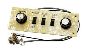

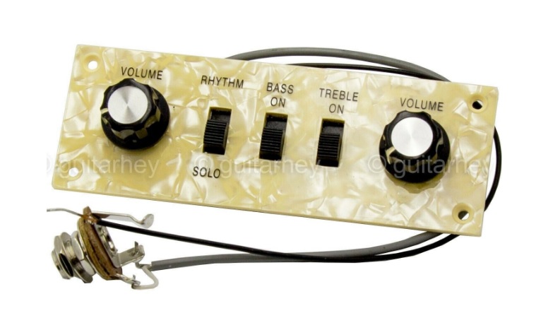

    I am not sure what sort of control panel the kit comes with, but I am curious. Here's what the OEM panel looks like...
Name:	Screenshot 2020-10-12 162037.jpg
    It has a kind of unique array of caps and resistors, that I am guessing are optimized for the Hofner pups.
    From what I can make out of the kit, the panel is a simplified version of the OEM. One volume for each pup. One switch to turn on/off each pickup. One switch to engage/disengage a tone cap. That should work pretty well with the Bartolinis. You may want to try different tone cap values, but aside from that you shouldn't have to change the panel.

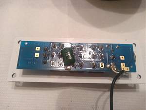

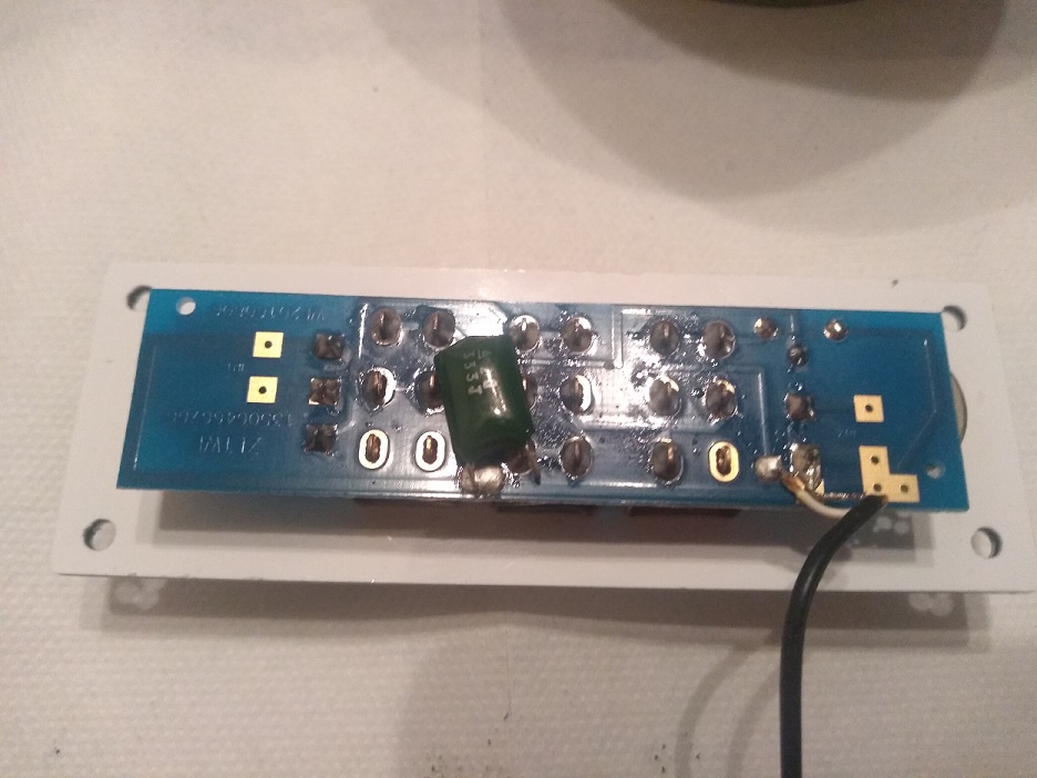

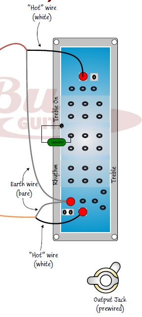

    I had been considering a 500k push/pull pot for the bridge pickup, but based on fender3x's recommendation I may leave the bridge pickup as a humbucker to get a full sound rather than mostly treble with low volume. The only issue I see trying to take the control panel apart is it seems like the pots are soldered into the circuit board. Would that be as simple as desoldering the joints holding the pot in place and then removing it? I can add a picture later if that helps
    As far as the measurements go for the Bartolini's, they are definitely different sized than the pickups that came with the kit, but I think they could still work. The pickups from the kit were mini humbuckers, but the cavities were routed for full size humbuckers. The length on the Bartolini's is perfect, but the width is a little narrow. I would probably need to create new pickup rings, but I think I could make it work.

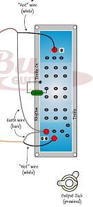

    Fender3x, thank you for providing that wiring diagram! I've found a few online that people had sketched together, but that seems like a very versatile sound, especially when adjusting tone caps as you mentioned. The control panel that was provided with the kit is much more basic, but I purchased a vintage style control panel with nothing wired up yet. Below is a picture of the original one provided with the kit, along with a picture of the wiring diagram from the Pitbull website.
