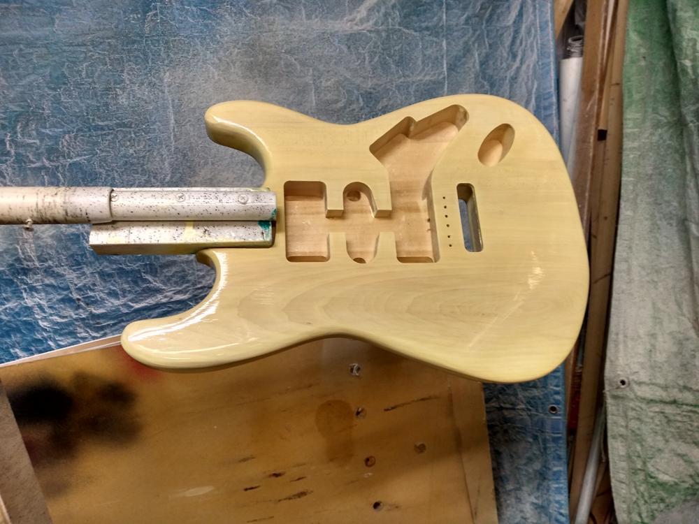

    Recovered after much sanding and application of the tinted liming paint again. Thankfully I tinted enough to be able to do it again. Since this is an experiment I am applying straight FW poly with a foam brush as I have found in the past it leaves less marks than a brush. After 3 coats its looks Ok but will need a few more coats with more sanding with finer grits. I read somewhere where people use wipe on poly for the last few coats to get a smooth finish so might try this as well. At least the poly adheres to the liming finish.

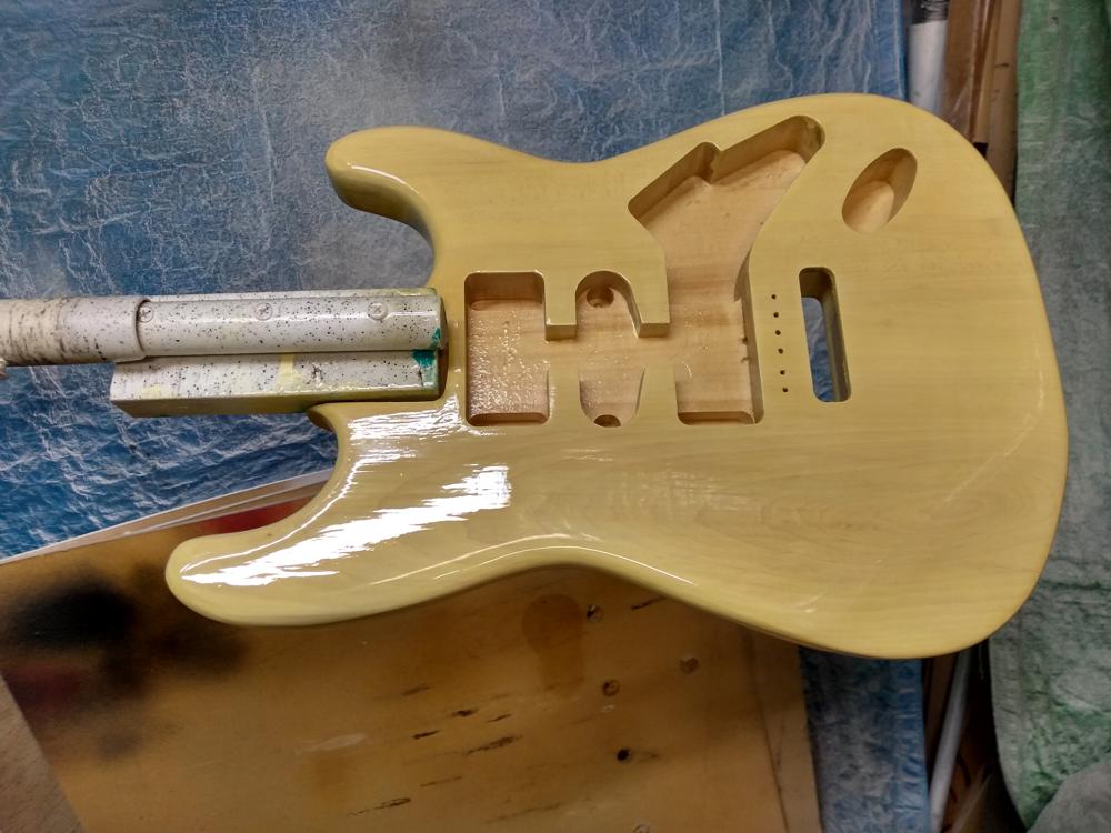

    Finished poly coats
    I ended up applying 5 coats of poly with the foam brush, sanding between each coat with finer grits. It still looked a bit up and down so I was going to apply a couple of coats of wipe on poly but instead got a spray can of cabots gloss poly and used that. Put on 2 coats sanding between with fine sandpaper and the result is much better than I thought it would be. It is relatively flat and should sand and polish well in 4 weeks time! What can I do for the next 4 weeks? I have thought a precision bass would be good as I like the simplicity of the design. I have other basses but not a single pickup precision style bass. I told my wife this was the last one what will I do? Ooops too late I pushed the purchase key and a precision kit is on its way.

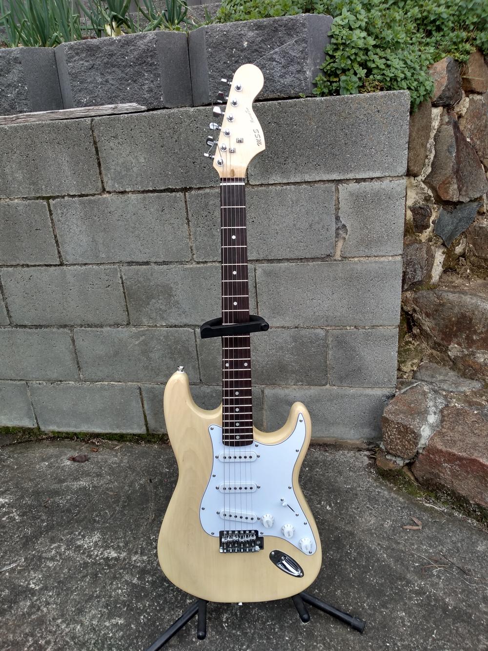

    Sanded and Polished
    Wet sanded with 1500 and 2000 grit sandpaper. Polished with Meguiars Ultimate compound and Scratch-X to a nice gloss finish. Some final setup adjustments but almost ready for the retirement party. All standard parts except for a bone nut. Plays OK and sounds reasonable with the standard pickups.

    That's a great vintage blonde finish there stansby.
    I've got a birthday coming up...
    ...just sayin'
