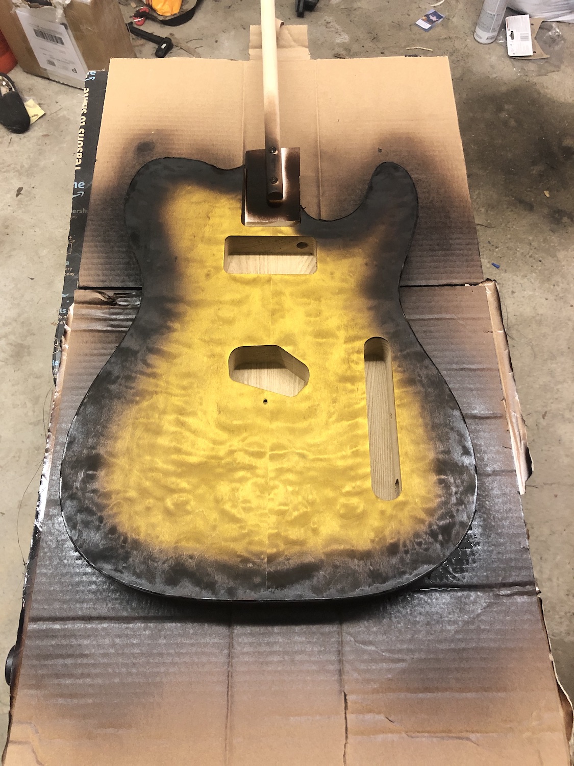

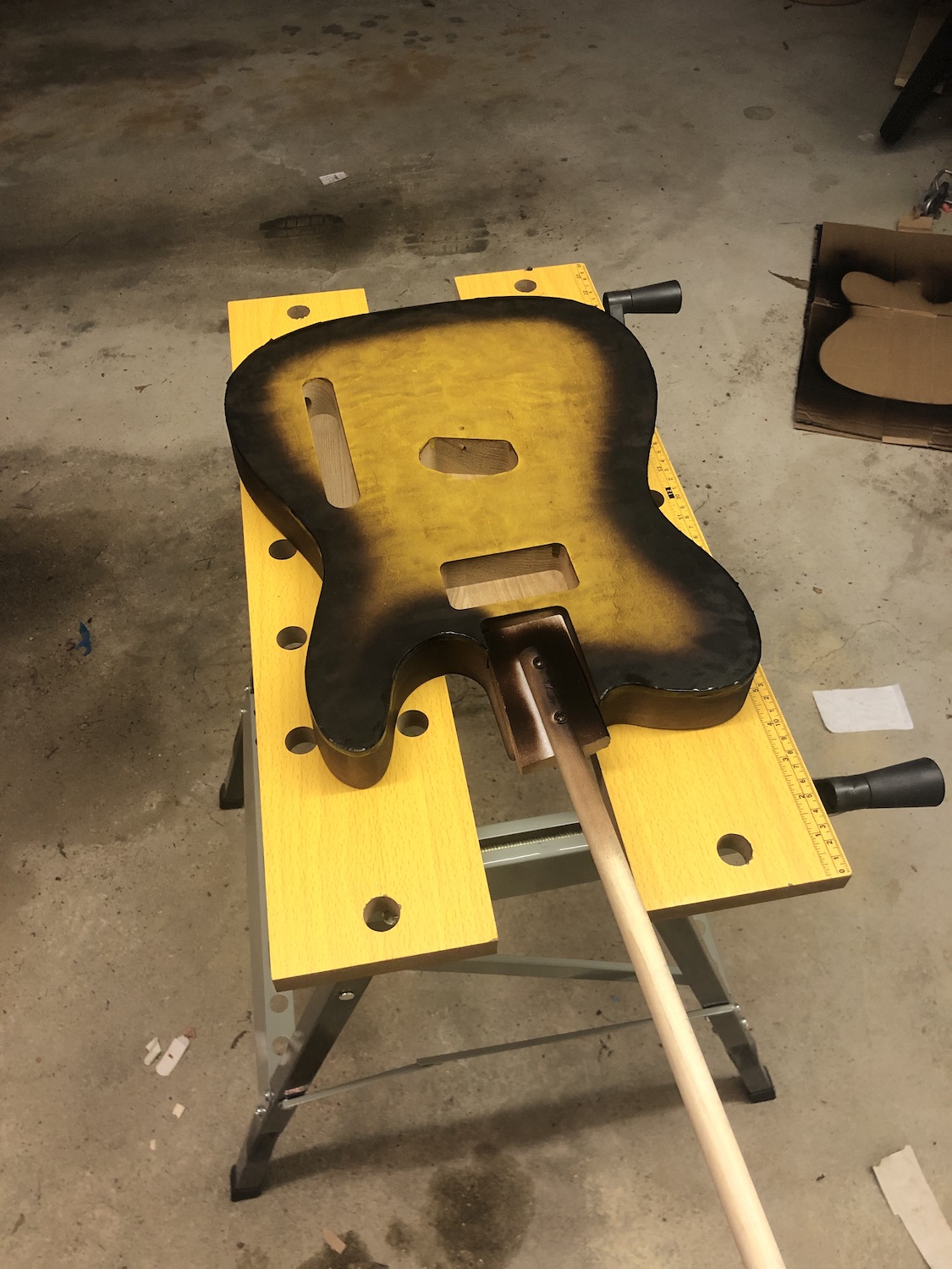

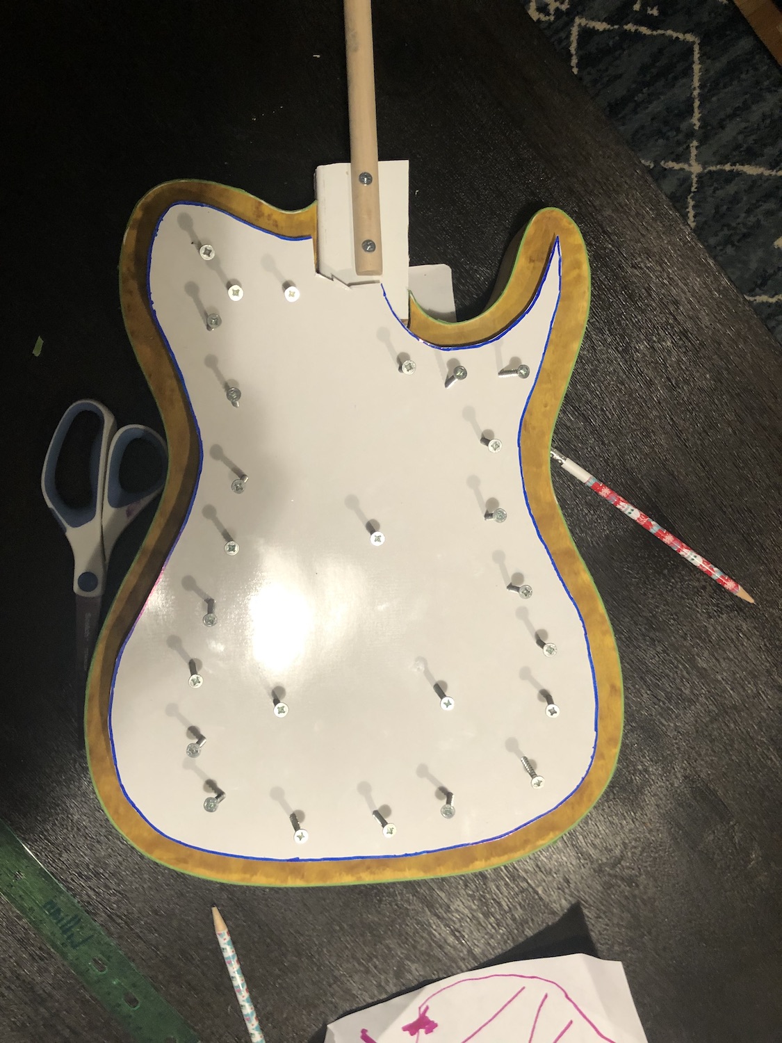

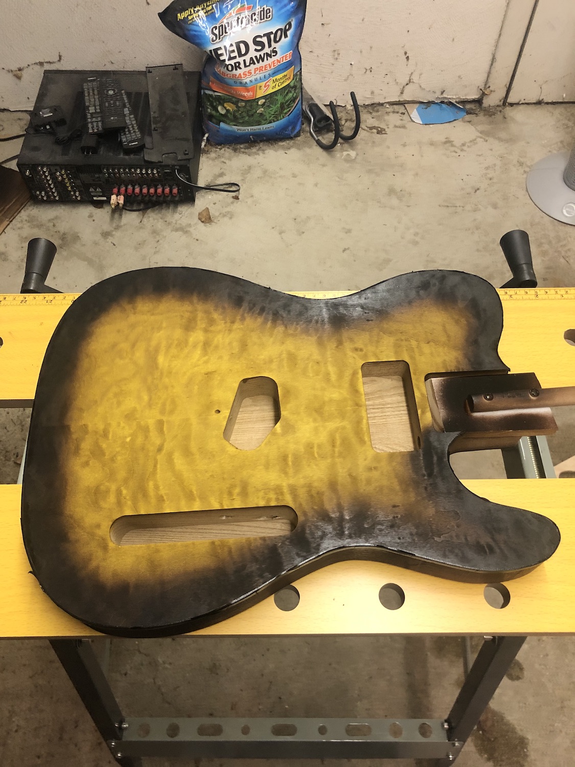

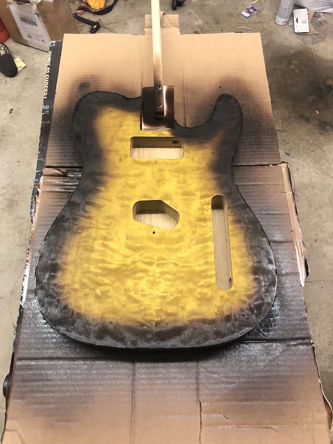

    I have been updating my guitar finishing thread daily, but neglecting this one. Just in case it helps others, I am going to add this update to my progress. I am still working on finishing the body and neck before I move on to the final build. Here is my progress so far.
    Here are pictures of the posterboard mask I made. I used screws to lift it 1/4in above the guitar body to allow for the burst. I sprayed down and slightly toward the middle of the guitar to get the overspray into the gap in the mask. It came out better than I expected. I used encore brown lacquer from Mohawk to get the look.

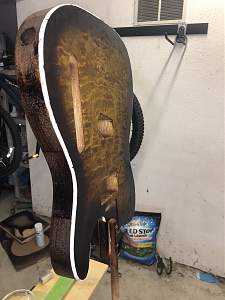

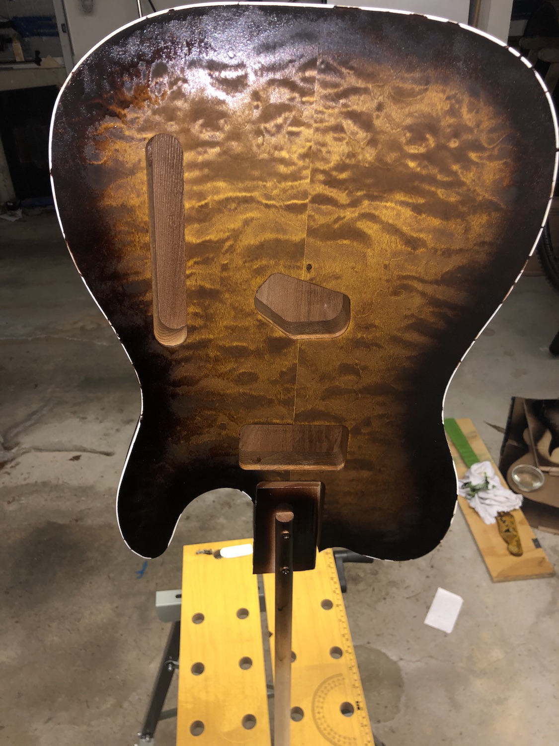

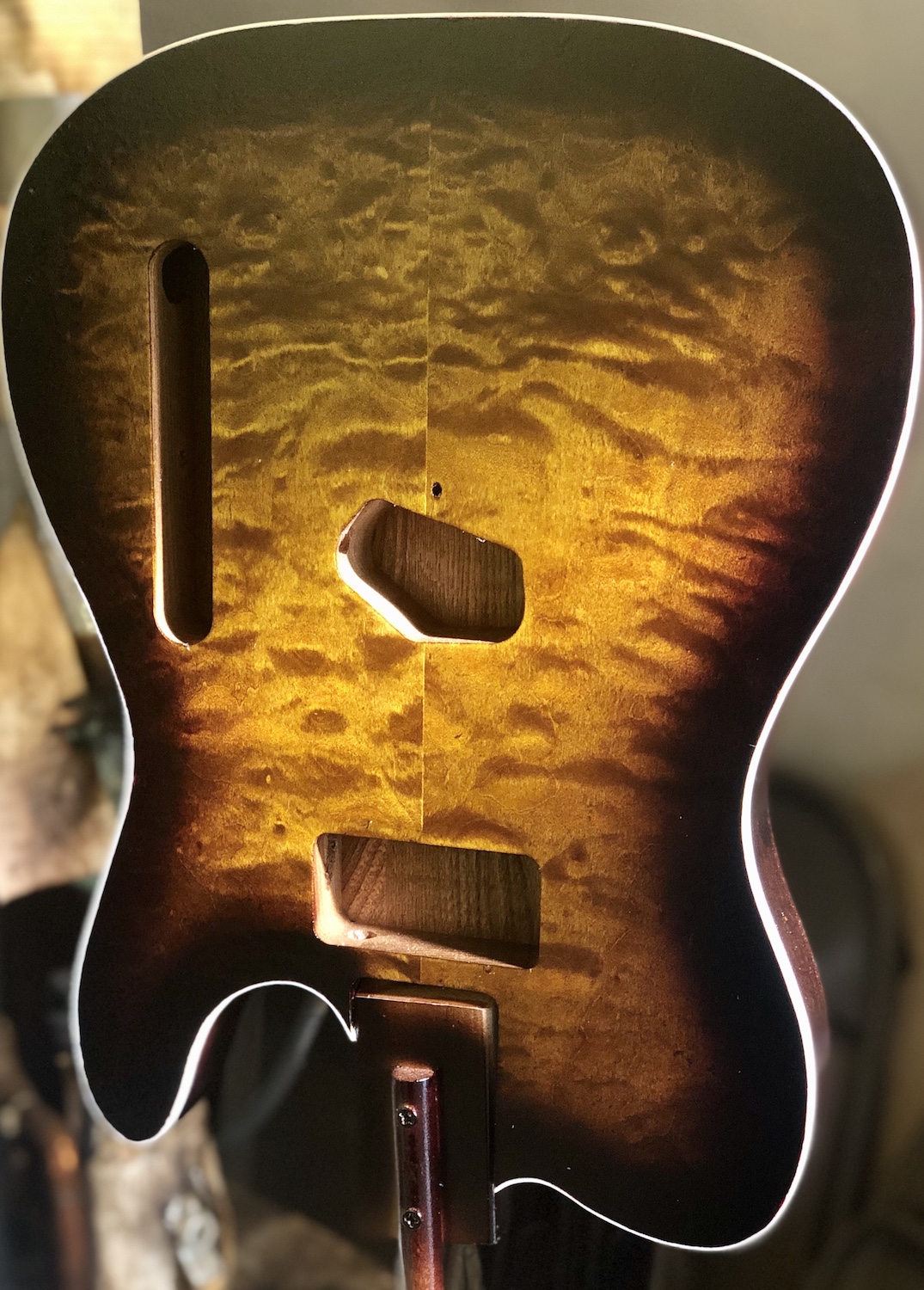

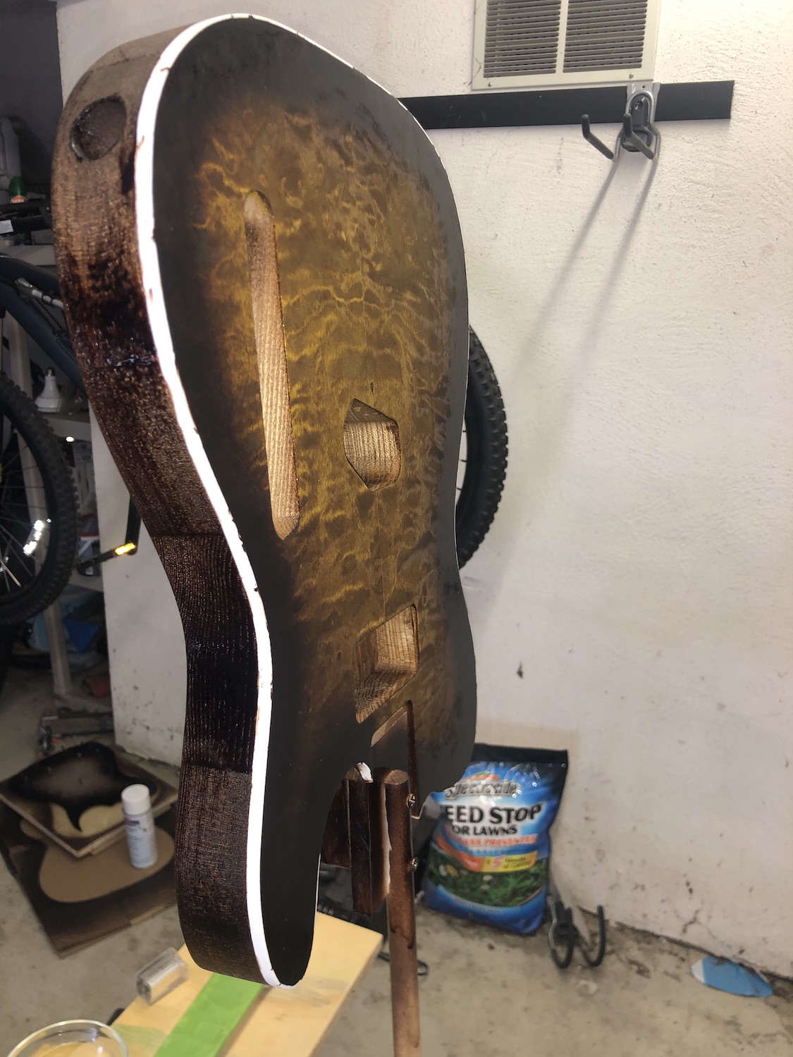

    Today I cleaned up the binding so that I can continue to spray 3 more coats of Nitro clear coat later. I will do 3 more tomorrow and then let it cure for 2 weeks before final sanding and buffing.

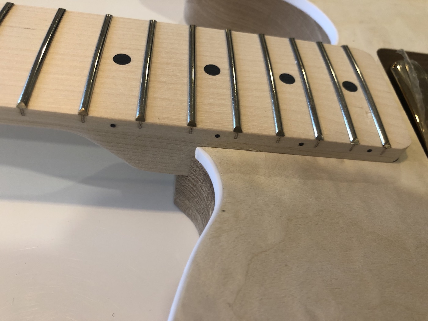

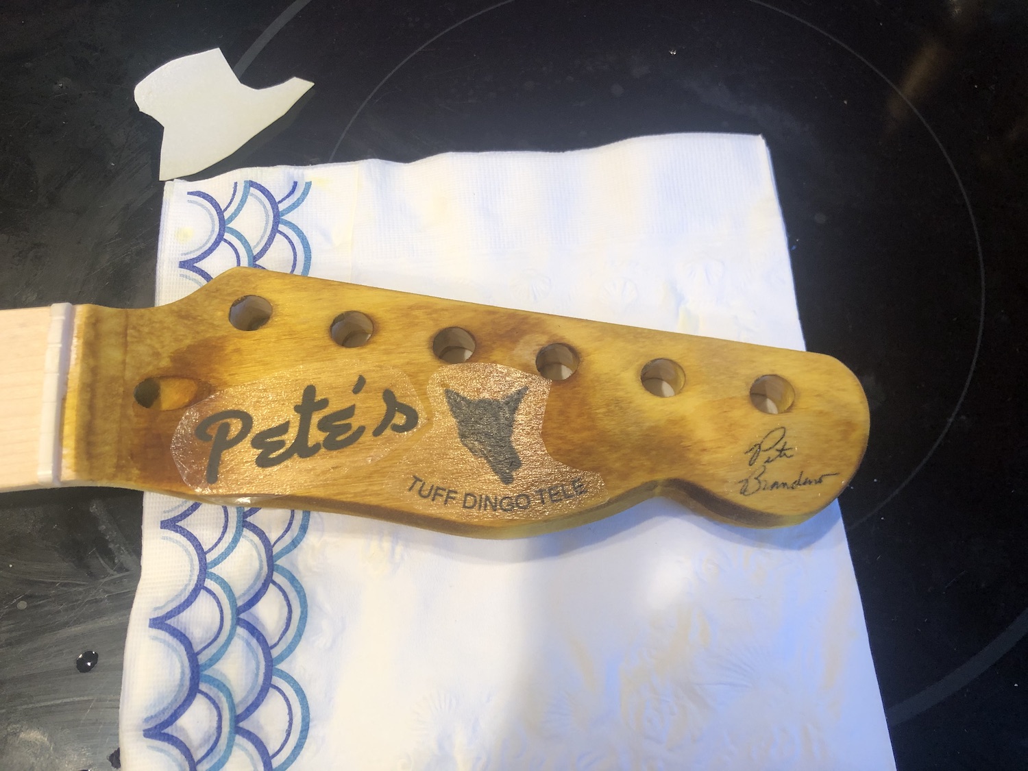

    Here is the custom headstock decal I made. I am not psyched about the way they wrinkled when I sprayed the nitro.
    The pic below is the latest and current state.
    Did you make the decal? You'd need to clear it with the nitro, that wrinkling is a reaction with what ever clear was sprayed over the decal.
  6. #16
    Looks to me like the decal is applied to raw wood.
    It should go on at least one coat of clear to properly adhere.
    cheers, Mark.
  7. #17
    Yeah I think you might be right, that would give a similar result.
  8. #18
    Jan 2020
    Natick, MA
    38
    I did make it. I only sprayed with Nitro, but it was wet with water when I sprayed. Letting it dry out made it curl. I think Mark nailed it, I put it on raw wood. It is now under 8 coats of Nitro so I may live with it until it drives me crazy and then fix it.

    Final coat of nitro lacquer is on! Now to wait... This wait may kill me. lol.
