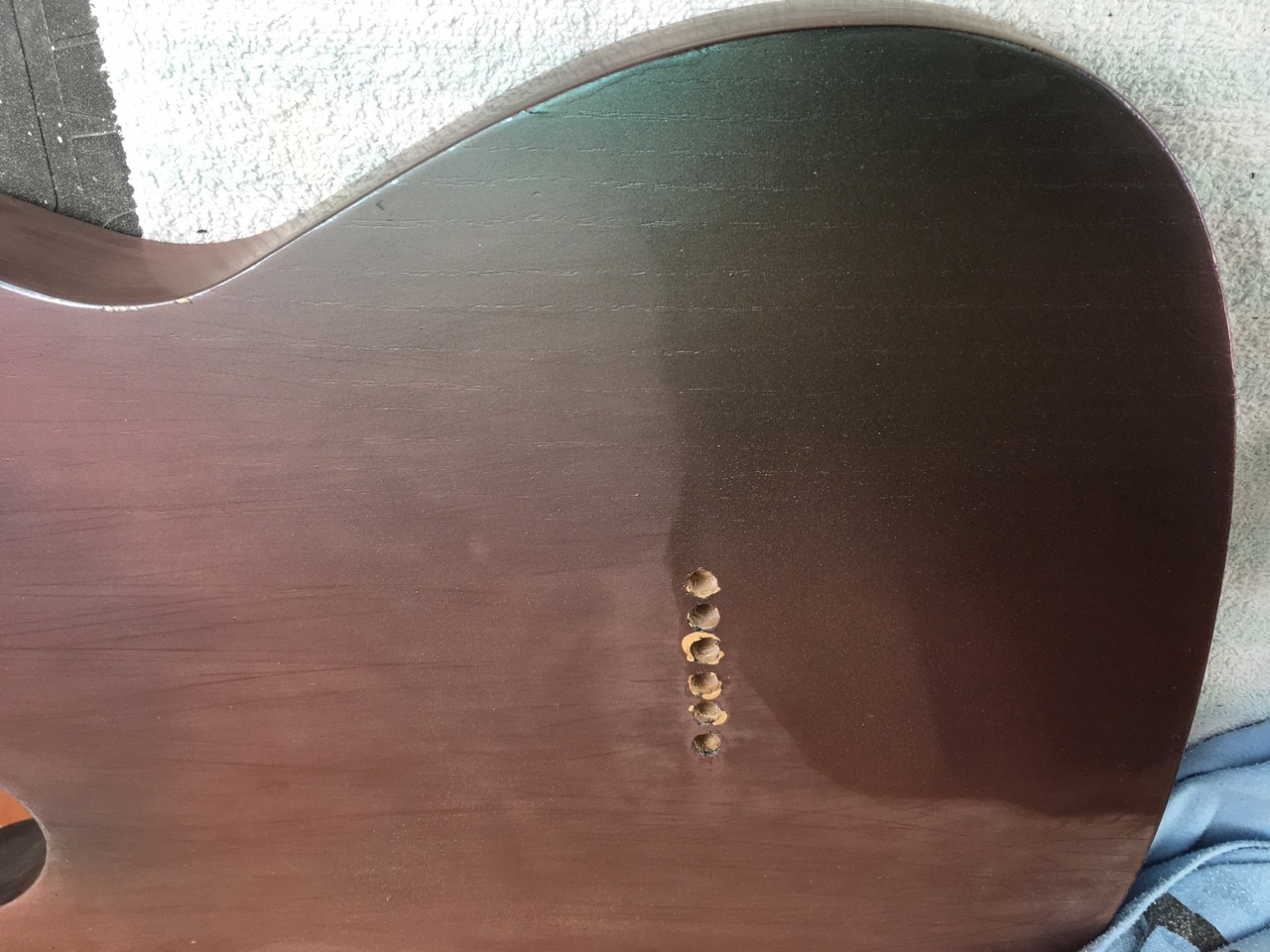

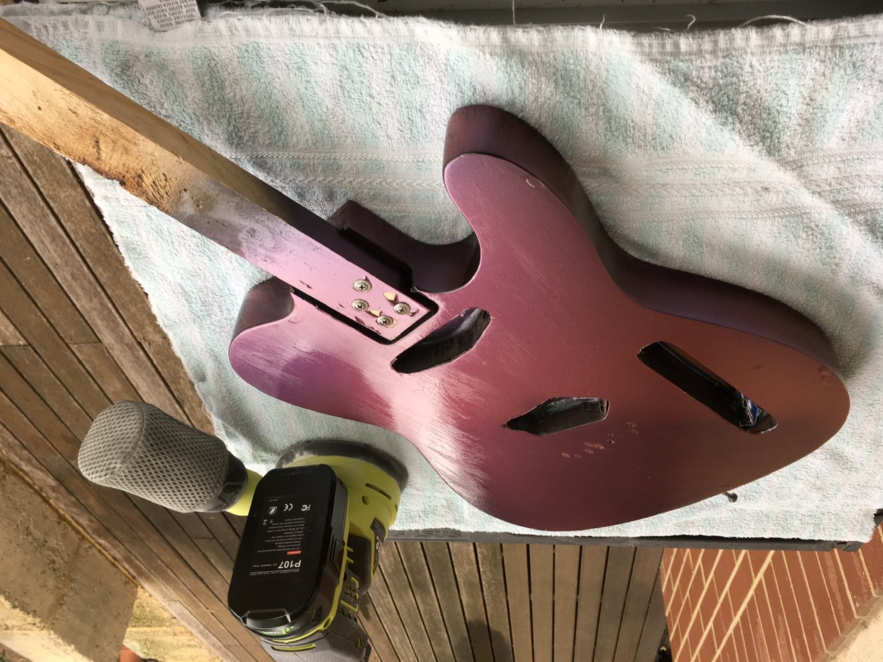

    That looks like a satisfying shine. Good polishing job. Hi
