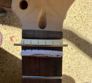

Hi guys, still got a bottle of Haematoxylin in the shelf. It’s going to be purple, more or less the same as the previous build but with some modifications. First thing I had to do was fix up a repair job in the rosewood at the first fret. I can see someone has fix damage with glue involved. It felt a little rough under the fingers but a little rosewood dust, superglue and sand/scrape back has improved the fix. Shaping the headstock today if time permits. I’ve altered the heal of the neck so it’s less square edged.

I don’t have access to the OG guitar, but I understand the colour is stable. Part of the reason it is used in pathology I suspect. Head stock not shaped, but out with the old nut and in with a zero fret glide nut. Hopefully this will aid return to tune along with locking tuners when I use the whammy bar. Note to difference in string spacing. That’s fine with me because I have fat fingers.

Ok, forgot to upload the photo.
