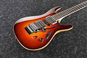

    If you also managed to find an Ibanez 5-way switch cover from an S-series, you could open the slot up and have the switch mounted on the top of the body which will give you plenty of depth. Try eBay. Here's an example of what you'd be looking for: https://www.ebay.co.uk/itm/203462347002
  8. #108
    Mentor dozymuppet's Avatar
    Jun 2020
    842
    Man, that thing is fugly...
