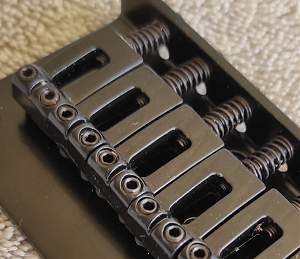

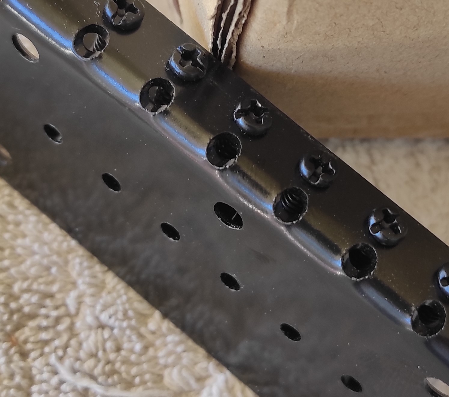

    I'm building an AIB-1Q kit and am confused about the bridge. It's a hardtail with what seems to be holes for string through or top load.

    I'm reluctant to drill string through holes on this one (body is slightly contoured and I've never done string through before- I'll save my first attempt for a flat bodied tele or something) and I'm perfectly happy to do top loading.
    Is this bridge top load compatible?
    The saddles look like they are intended for the strings coming up from the bottom but pretty sure I've seen top loading squire strats with similar bridge & saddles. I've used similar on a tele and it works.
    Also remember that if you want to go through body, you'll need some string end ferrules which aren't supplied in the kit.
    I'm building the same kit and went with a Gotoh through body bridge and ferrules.

    You might want to be careful with the top load. The way those lower holes are positioned, you might foul the body with the ball ends and create some damage.
    If it were my build, I would be working out a plan for the string through, possibly setting up to rout a channel on the rear to give you a flat landing point for the ferrules.
