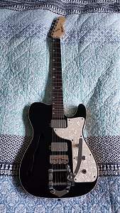

    Hi All,
    I humbly offer my submission.
    This is my first build and was challenging but lots of fun.
    I started with a thinline kit TL-1TB and then customised it with a series of mods to arrive at something close to my desired guitar:
    - Replaced the tune-o-matic bridge with a wilkinson tele half bridge, cut down to allow access for the Bigsby
    - Converted the pickups to hard mount without the pickup ring
    - Replaced the pots, capacitors and jack
    - Added a treble bleed circuit
    - Adjusted the neck breakover angle
    - Routed a larger control cavity
    - Designed and fabricated my own pickguard
    - Rounded over the rear edge of the body
    - Carved the neck to allow better access and feel
    - Upgraded to Grover locking tuners and bone nut
    The finish is Holts Duplicolour black and clear coat acrylic.
    Hope you like and thanks to the forum members for help along the way.
