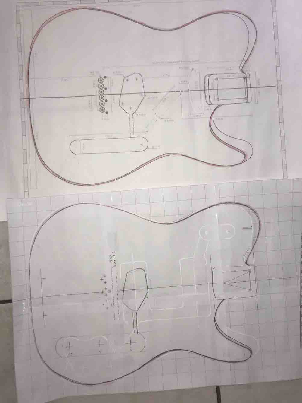

    So far - I've got a kit that should arrive in a day or two - minus the body which I'm making myself (so far it's a blank of made from an old post - we think it's Douglas Fir and a "top blank" made from the same old post.
    So - this is what the "plans" are so far....

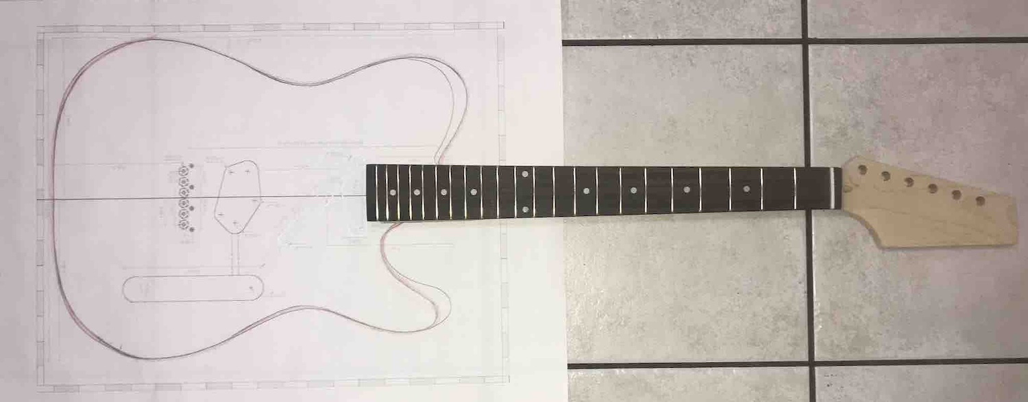

    And now I've received the Kit - it's in context with the neck.
Name:	In context (with neck) clipped 2.jpeg

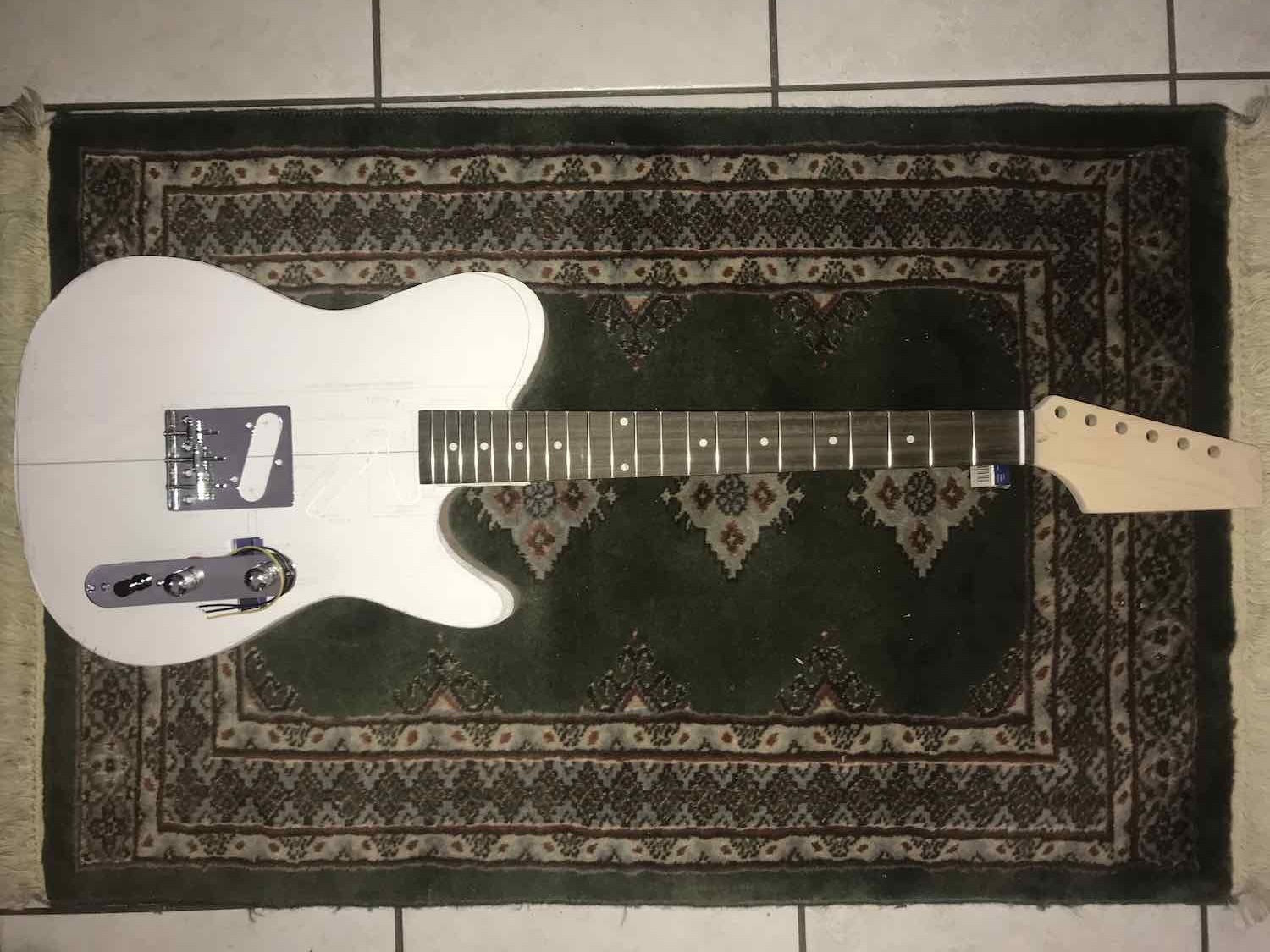

    So far....
Name:	Mock up (Esquiresque).jpg

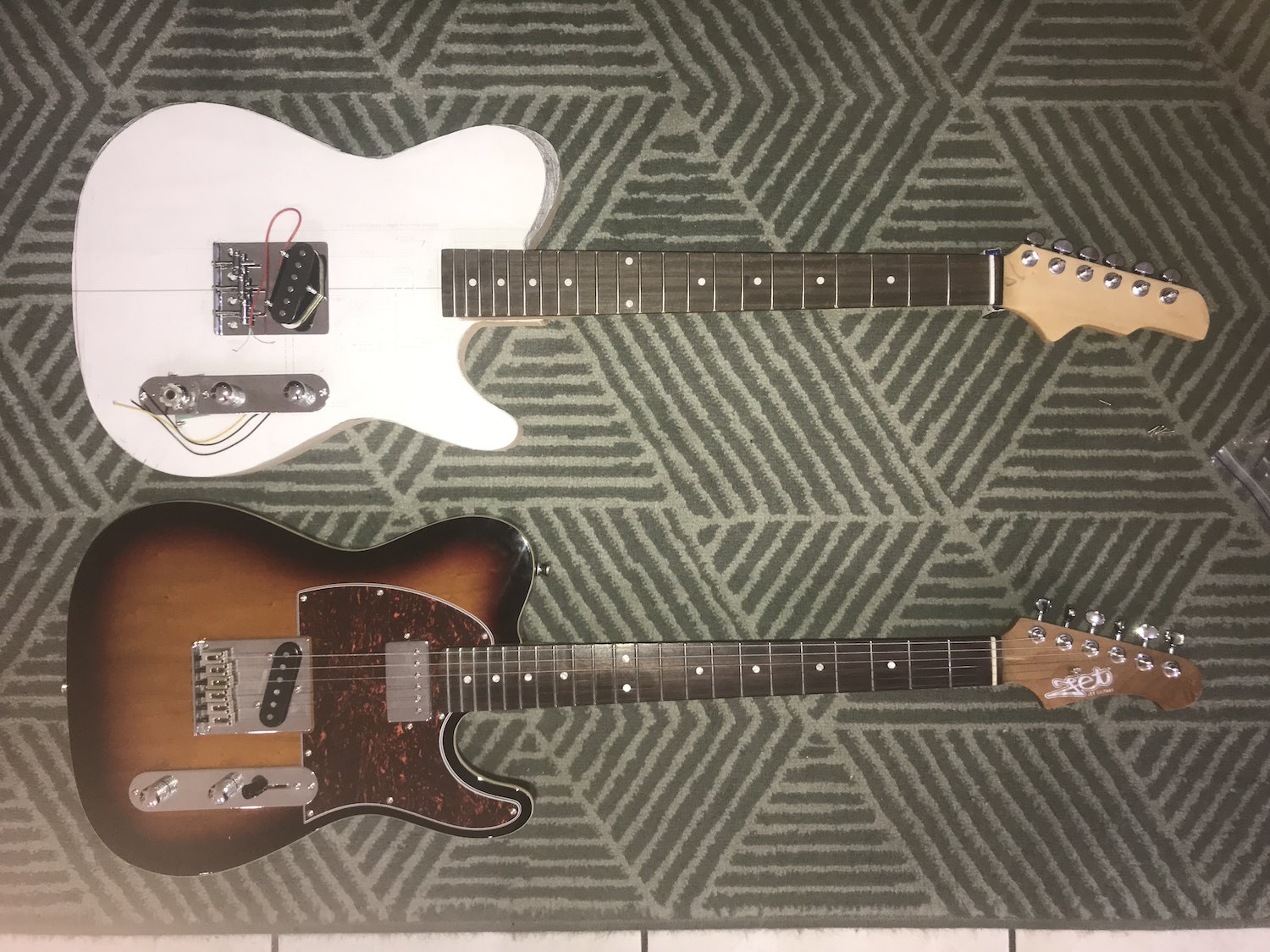

    The latest "mock up - I've shaped the headstock (trying for a "reverse" of the normal tele shape mixed in with the Coronet "batwing"...).
    The neck's been sanded to 240 grit and has a couple of coats of Danish oil. A few more sandings and coatings to go (then it's the fretboard to concentrate on (a couple of the frets are raised and a lot are a bit "grubby")..
    I've loosely put the Grovers on to give a better idea what it'll look like (alongside the guitar I already have - a Jet 350).
Name:	2. alongside the Jet 350.jpg
    I've also started thinking the body shape might be better without the shaded areas - I'll give ti a few more "looks" over the next week to see if I still think so.

    3,080
    FWIW, I think you are right that it will look better without the shaded parts. I am also a big fan of the Epiphone batwing headstocks, ever since I got my first bass, an Epiphone Newport, that sported one.
    I have seen also sorts of custom tele control plates...but I am not sure where you'd get one that is longer. Since you don't have a switch, I am wondering why you'd want it to be longer? If you don't mind it being a bit banana shaped, you might find an undrilled Music Man bass control plate. That would be longer. You could probably find someone to make you a longer Tele plate if you don't mind the expense.
