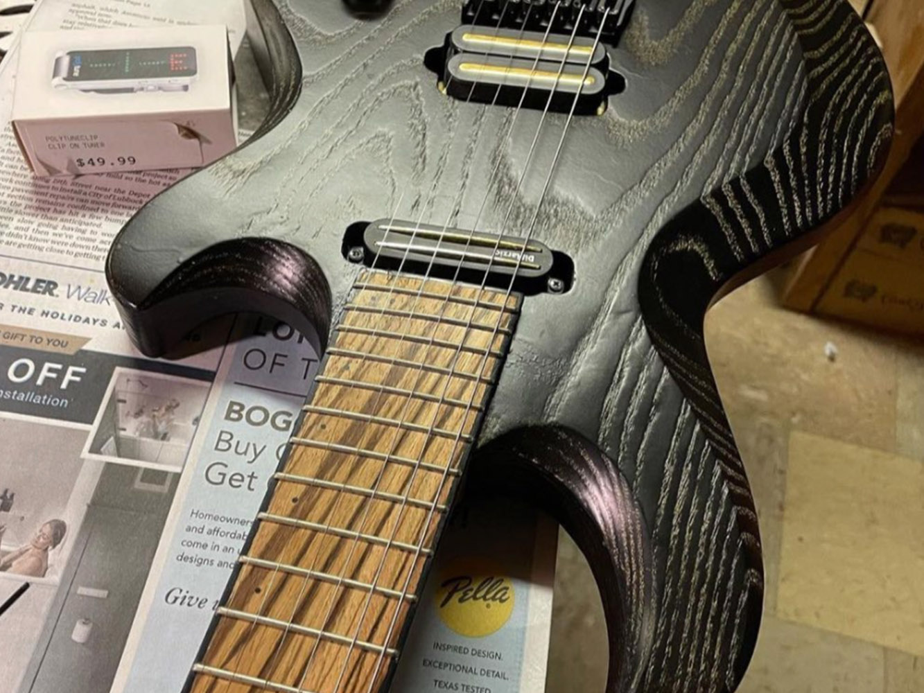

    I came upon this finish...
    Does someone know the technique, how to achieve this, or is it just a matter of wood? I tried to find some information...
    What I came upon is that you "sand" out with a metal brush the softer woodparts and the hard parts stay, so you get a kind of relief...But it must be a whole piece of wood with interesting grain that gives the opportunity I suppose...

    Im looking to get a similar effect with my JBA 4 Ive mixed up a couple of brews using 0000 grade steel wool and white vinegar but not getting the color I was after, apparently you have to use cleaning vinegar ?? and also depending on the timber, tannin enhancer, some timbers have more tannin than others. So not being happy with trying to color some sample timbers (ash) Im now going to try using Speedball Super Black India Ink, I can get some from the local arts supply.
    2,002
    Hi Alexej,
    FrankenWashie or Ig0r was doing this - Check out his build diary at https://www.buildyourownguitar.com.a...l=1#post220184.
    Ash wood could be used to create that finish.

    Hi Trevor!
    Thank you, that is exactly what I would like to try out some day!
