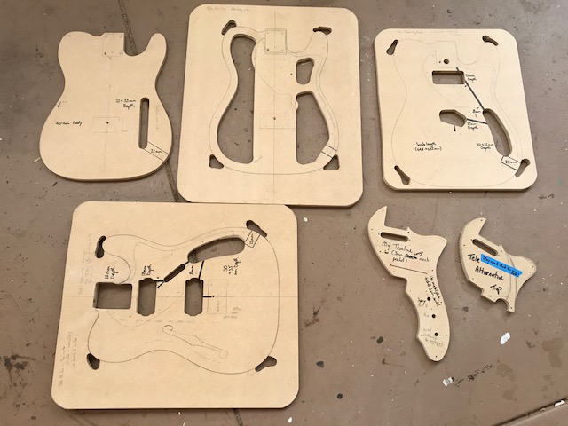

    After starting work on my TL-1TB kit I decided I needed to have a go at making a tele in the style of a 69 thinline. Mainly 1) for the challenge, and
    2) for the fact that I really like the thinline pickguard!
    Down the track (and if this works) I plan have a go at a thinline LP Junior.
    I have made a set of templates out of 12 mm MDF. The main body template is designed to be screwed onto the body slab. The other templates, for the inside body routings, have a large enough area to support the router and allow me to clamp them onto my body slab and bench (though I may need to cut out the corners so that I can get greater access with my clamps). The corner "holes "allow me to line up the body (I should have made them the same shape - oh well!)
    While I was on a roll I routed a few variations in terms of the control cavity route and the ability to have humbuckers.
    I will make a pine slab and then test them out.

    Looks good Trevor, bit of work hogging out the hollow body waste area but worth it .
    Another good way to assist in locating the templates is the holes for the bridge mounting . In mine I have two 3mm holes and drill two in body and glue on top and use 3mm rod (shaft end of drill bits) in each hole to locate each template onto body to assist clamping or double sided tape adhesion.
    Tony

    Thanks for the "drill bit" tip.
    As for hogging out the body I thought I could use a ply wood top and back! I could then jigsaw out the main parts of the cavities. Hopefully I have a few possibilities to trial.
