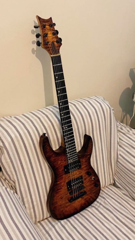

    My GS2Q kit, ordered without hw and electronics.
    - Gotoh GE103-BT bridge
    - Gotoh GE101-A stoptail
    - Kluson locking head tuners
    - Seymour Duncan Sh4 pickups
    - brass nut
    - custom maple control cavity cover attached with magnets.
    Finished with crimsons stunning stains brown, orange, amber, yellow and nitro sealer and clear.

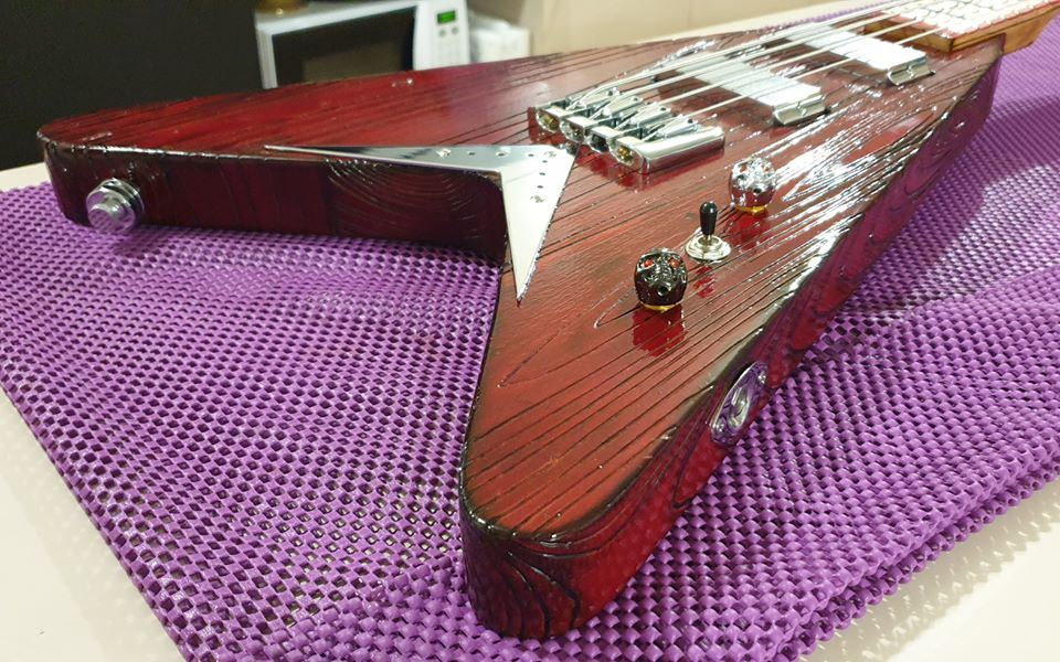

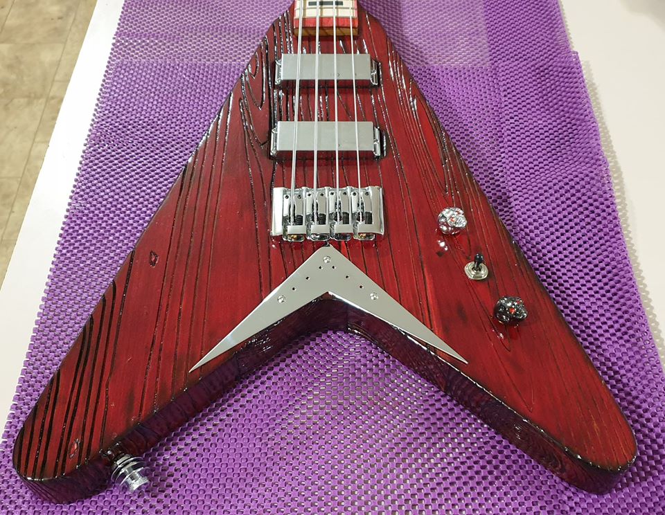

    My FVB-4 Pirate Bass.
    Shou Sugi Banned to preserve the wood and highlight the wood grain then engraved each grain including back of neck.
    Cherry Pie ink stained and on back of neck and with watered down black on top for back of body.
    Body...Scandinavian oiled finished with multiple coats of Tru-Oil with 3000grit light polish in between. Neck...Tru-Oil with 0000 steel wool light polish in between coats and eucalyptus oil for fretboard.
    Swapped neck from a ML Bass Kit.
    Custom chrome pups. A500K pots and .022 cap.

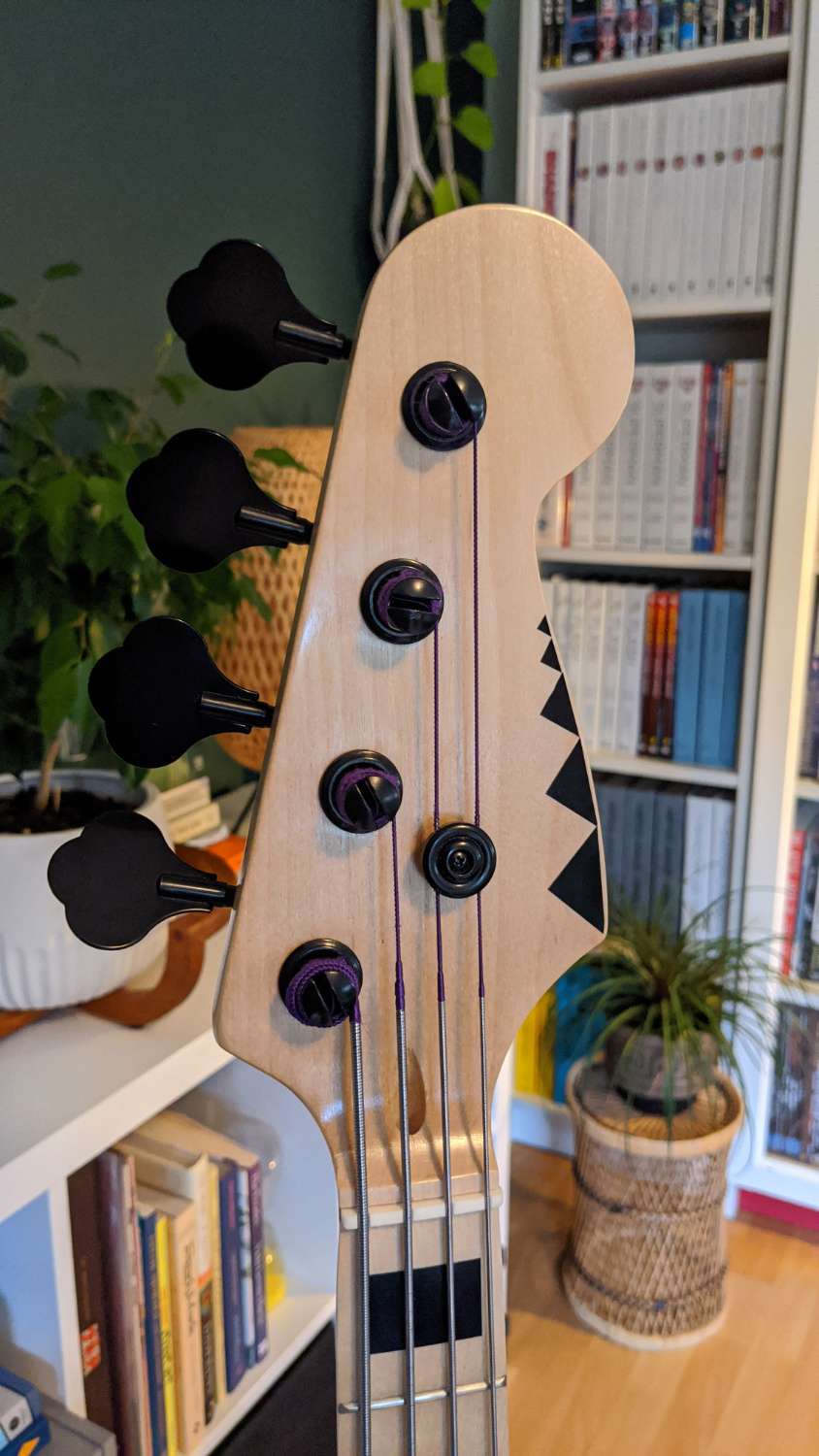

    - JBA-4M kit
    - Black hardware upgrade
    - Timbermate ebony wood filler
    - Birchwood Casey Walnut Stain
    - Birchwood Casey Sealer & Filler
    - Birchwood Casey Tru-oil
    - Creative-Cuts black block fret marker decals
    - Customer headstock decal from fret marker offcuts
    - Ernie Ball flatwound strings
