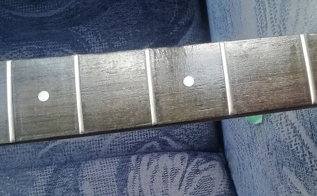

    Hmm. Worried about the stability of the artificial Rosewood fingerboard, which has shown a distressing tendency to lose fibres, I've treating it to a coat of penetrating epoxy primer. I mixed up more than I needed (hardly any) so I gave it three coats. (it has a very long potlife and short drying time so you can get three coats from a single mix). This makes for a coating just thick enough that I've got some brushmarks, which I'll have to polish down, but not enough (this stuff is very thin and low viscosity) that its actually going to hide the various blemishes and missing fibres, which are far more obvious now the fretboard is darker and has a moderate gloss. Sigh.
    I suppose the best thing to do would be to remove all the frets - which are now presumably nicely glued in - and coat, sand and recoat until the fretboard is nicely flat with all the missing fibres holes filled flat with epoxy. I really don't think I can face that much work though. Also, seeing as how the frets will indeed be nicely glued in, I wonder how many more blemishes I would manage to add to the fretboard removing the frets.
    So I shall see how just polishing off the brushmarks goes, and review. Better wait a week or so for the epoxy to be really throughly cured though I suppose. Next on the list for the epoxy is probably Simon's six string. I think it will be sensible to just give that one coat and review.

    Just remember that a normal rosewood fretboard isn't perfectly smooth (like ebony normally is) but does have grain-related indents. The Brazilian rosewood board of my 1965 Gibson Country Western had significant grooves in - certainly deeper than those in your pics.

    Interesting isn't it. Given a natural bare wood finish open pores etc are perfectly acceptable and I'd not have the slightest issue. Given a wholly artificial finish like a high gloss lacquer then I think I'd absolutely want to avoid them. This should fall somewhere between - I'm certainly not aiming for the sort of finish that a maple fingerboard would have. I'll look at taking it to a matt style finish with something like 600 grit and decide where to go from there. I'm pretty sure though I should have stopped at one coat and seen how it looked and worked.

    I have a engineered rosewood fretboard on my ES-5V. I put a few coats of Tru Oil on it and hated the feeling of it. I rubbed it with steel wool (use an alternative if you don’t like steel wool I guess) and it felt and looked much better.

    I tried a couple of (whatever the word is for the individual fingerboard divisions between frets!) with 600 grit paper and abrasive polish and I think the results are acceptable.

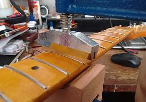

    So I have got a brass 7.25 radius guide and ...
    Aha: the factory - at least the ESB-4 factory - must use a tool like that. I'm seeing a faint indentation each side of every fret which is making it tricky to sand the lands for a really even appearance. I wondered if it was inadequate sanding on my part, but that completely explains it.

    Not if you look closely at the full-size original pic. The fret press tool is clear of the fretboard so will never leave a mark.
