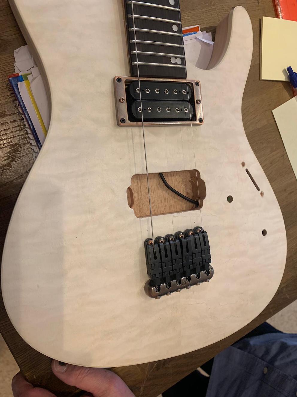

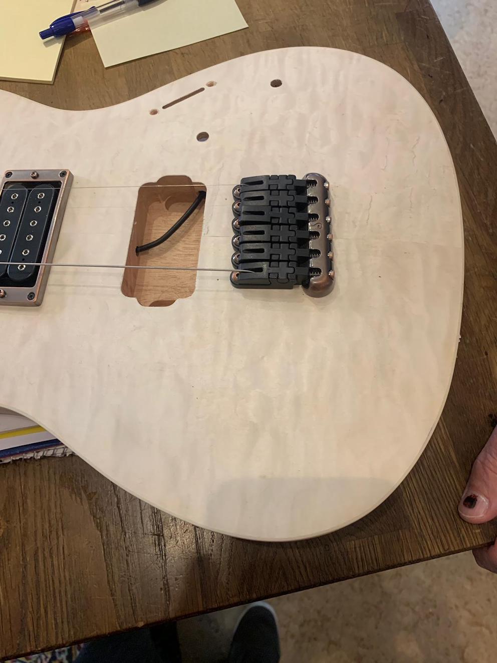

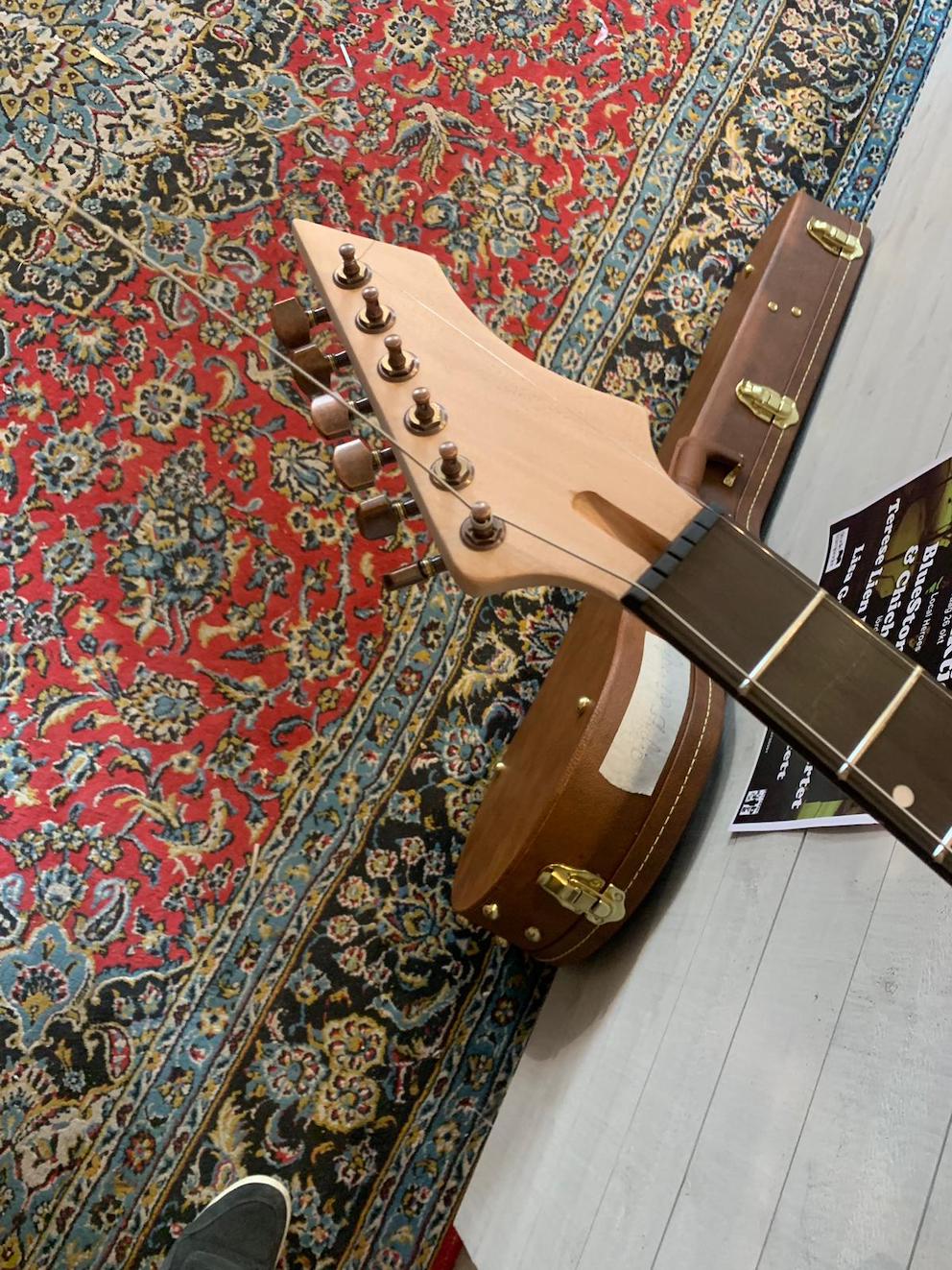

    Start to get bridge in place with tuners.
    Alot of work as there is lots of cables from the bridge.

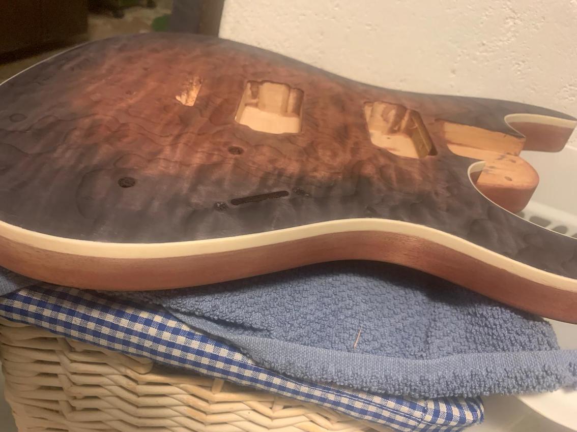

    Think its looking nice in cherry/black and it will match HW good.
    Lots of glue stains int the maple unfortunatly. Almost done here with the front.

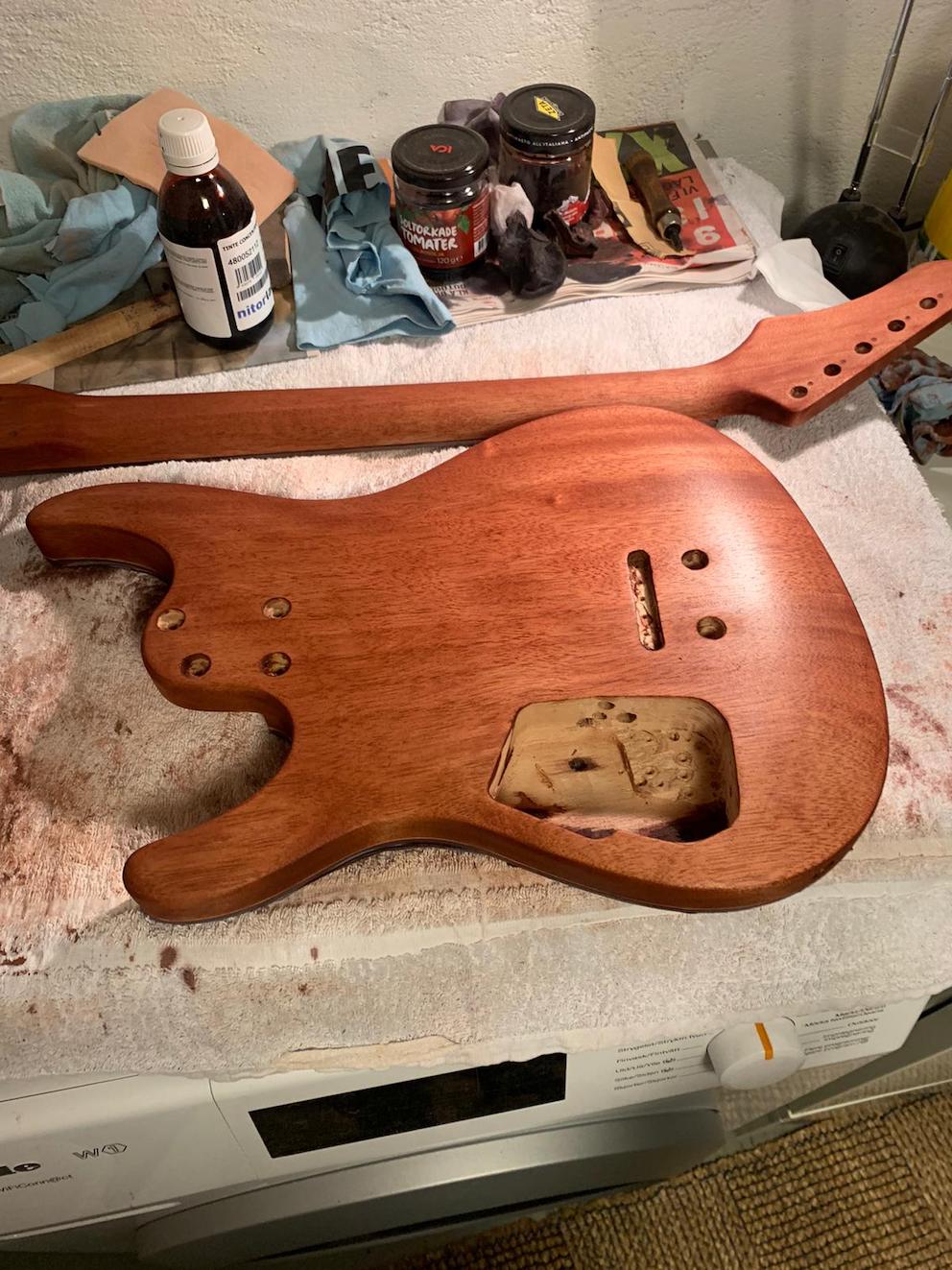

    Slowly make some prgress here.
    Using https://nitorlack.com/en/varnishes/stain-en/ dyes, easy to work with so far.
    Will be tight fit on preamp, trust me on that.

    Mentor DarkMark's Avatar
    Sep 2017
    1,572
    I’ve know people have built kits on their dining table but I think this is the first one I’ve seen built on a washing machine. Don’t let the spin cycle vibrate it off the top. You’re doing a fantastic job with the staining. Look forward to how it looks when it gets clear coated.

    Holes in the back is made by me for the bridge. Beware of the work fitting a Hannes bridge. Its alot of mesuring to do there before drilling.
    It also took me some effort to find out how to handle all cabels as the manual from Shaller leave no clues what so ever.
    Cover for the electronics has to be on top of the back as the body is so slim I can’t get the pre amp in, in any other way
    Wash machine is unplugged 😬😁
