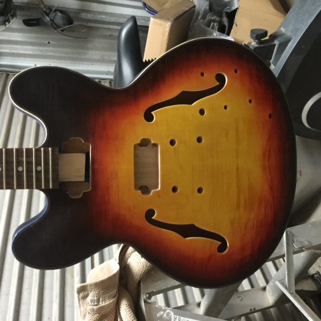

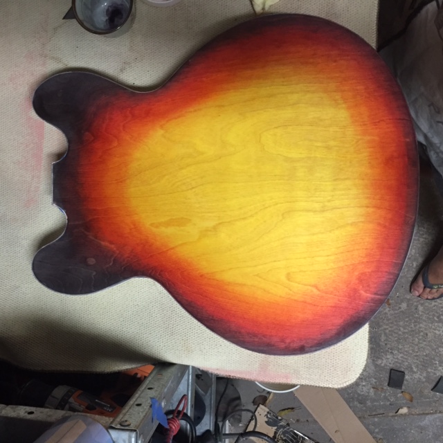

    2. Coat 1. Going for a classic look here with a burst using Colortone Yellow, Cherry and black. I had to work fast because Colortone dries real fast. I had to work in sections to try and avoid dry lines at the edges of the colours (worked better in some areas but not so great in others.
Name:	coat 1 front.JPG
Name:	coat 1 back.JPG

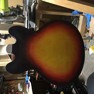

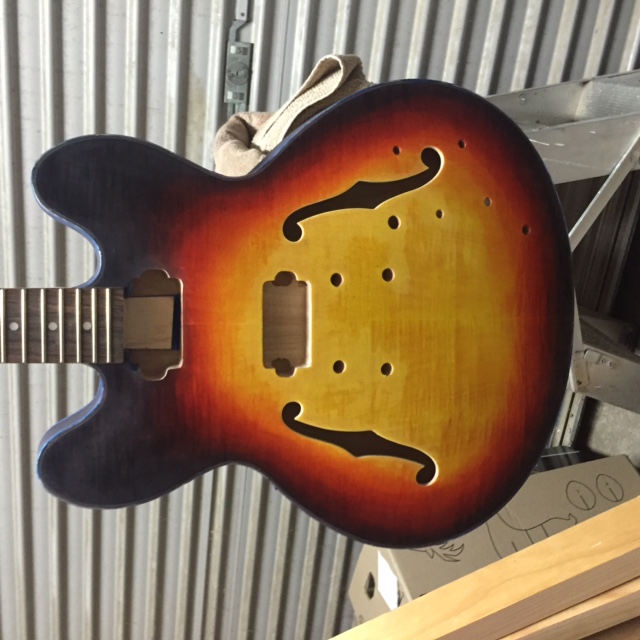

    3 Coat 2. I was pretty happy after the first coat but I really wanted the black to be blacker and the yellow to be richer. I also realised that the back was different to the front so the back ended up needing more work.
Name:	coat 2 front.JPG
Name:	coat 2 back.JPG
    The grain on the front doesn't really show up that well in the photos but it's looking great.
