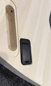

    2. in regards to upgradability. was thinking at some point I might want to give active humbuckers a try. has anyone ever tried adding a second cavity for the battery? or maybe I can fit all in the existing one ?

    Hi Juan! Wish you good luck and much fun with the kit! I have not that much experience in finishes, but maybe some other stuff that I made for my explorer can help you. It was my first build and I also made a second cavity for the active humbuckers. Greetings!

    Yes, you need usually a second cavity for the battery. As I used a set of EMGs, there was just no space in only one cavity. You can even buy a special battery compartment, for a faster battery change. But I just made a smaller cavity with a hand milling machine, parallel to and in the shape of the main cavity.
    ahhhh funny stuff I was actually thinking about installing EMGs to this one. Did you have to modify the pickup cavities to fit the EMGs?
    I don't have a milling machine unfortunately was thinking about using a dremel to cut through.

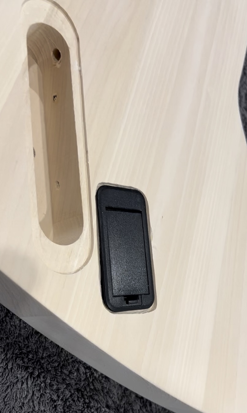

    have done the initial sanding of the kit and have done the fret leveling and have opened a cavity for the battery (with a Dremel and drill... so might not be the best work ever )

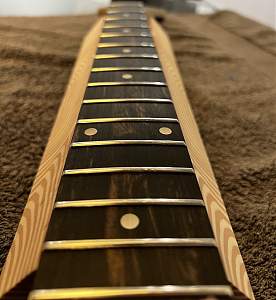

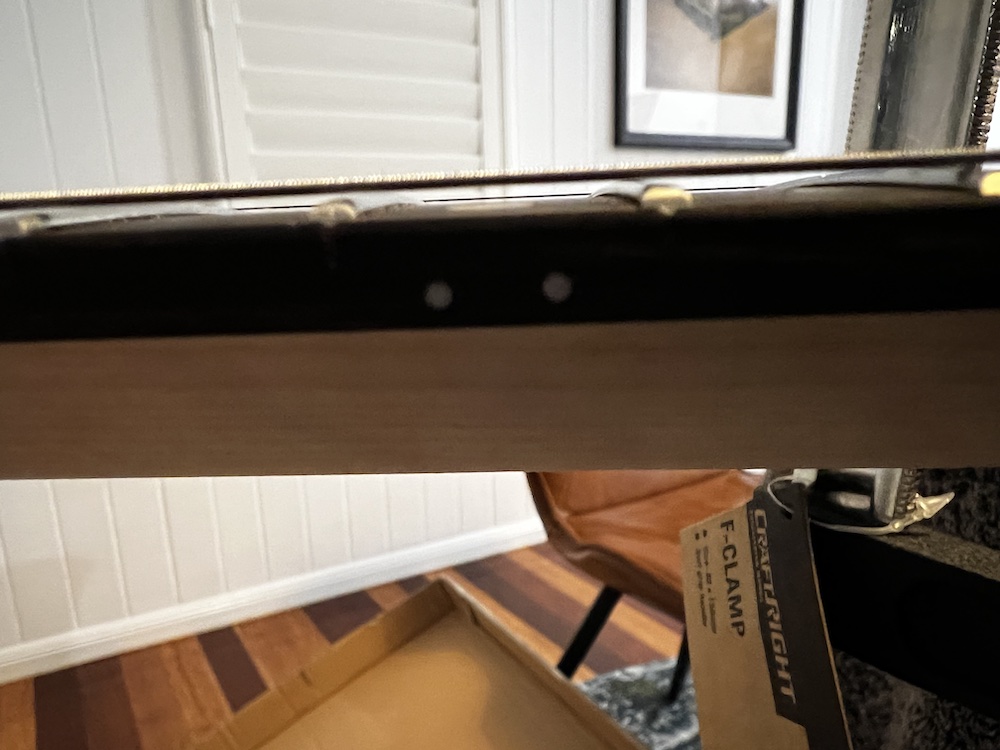

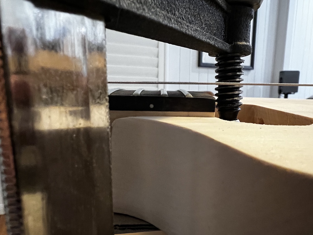

    But, during the mock build I did notice that the neck heel has two diferent surfaces, at an angle, and depending on where I clamp, I will get a different neck angle... so not sure which way it should go.
    Feels like once fully installed it would be better to have the one where the strings are just 1 mm away from the frets (as I could raise the bridge). but would be nice to get some advise.

    I also think having the strings set lower would be better - definitely easier to raise the bridge. But how was the bridge held in position when the photos were taken?

    FWIW, I agree. You want to make sure you check with the bridge a few mm higher than the surface of the body to accommodate for the flanges on the post ferule and the post itself. One mm is not excessively low if the neck is flat and the strings are not under much tension. Even having the strings touch the frets should not be a problem at this stage, since the neck is not at tension yet.
    You might also want to check, and if necessary adjust the truss rod (very carefully), to make sure it's completely flat for your test. Should not take more than a quarter turn to get it flat if it's not. This would be a good time to get a notched straight edge (or make one) to test the flatness of the neck ;-) They're cheap to make, and not that much more to buy.
    Hi. Yup, actually had done the fret leveling just beforehand so the neck was completely flat.
    thanks for that
