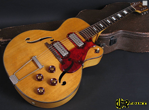

    Hi fellow wannabe luthiers,
    no pics from me yet, but I'm awaiting a custom kit based on the GR1, which just happens to have a very similar body size/shape to a guitar I've been gassing for, but can't find here in Australia at any price. They pop up for sale every so often in the USA, but no way I can afford them either....
    Here's a link to pics, and info on this model:
    https://shop.guitarpoint.de/en/Harmo...ny-H62-Natural
    I've ordered the GR1, with a paddle headstock, block inlays, flame maple top and back, tortoiseshell binding front and back, and only bridge post holes drilled in the front. I'll rout and drill for the pickups, and wiring harness.
    I can't wait for this project to arrive - no sign of an original H62 in my 2+ years of searching. I have the original Gibson P13 pickups ready to install, and I'm thinking of adding a Bigsby, cos, well you know - things go better with trem!

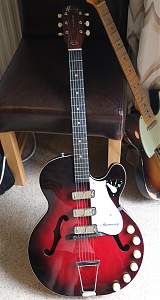

    Hi and welcome.
    I did up an H59 a few years ago.
Name:	Harmony finished small.jpg
    Found a beaten up one in the US so it was cheap and imported it into the UK. A few bits missing which I replaced or made.
    Neck wasn't a straight as I'd hoped for, and with a non-adjustable truss rod there wasn't much I could do apart from massage the fret heights a bit. It played OK, just not as nicely as I'd have preferred. Sometimes there are benefits to newer instruments!
    All the best with your build, and don't forget to start a build diary.

    Anyway, the challenge is to knock up something that looks kind of like this, (see attached pic), out of the GR-1SF kit.Click image for larger version.
Name:	Screen Shot 2020-12-08 at 9.46.36 pm.png
ID:	38355 Now that I've looked a lot closer, (the body shape is pretty right, I asked for no pickup routs, and no holes, other than for bridge posts), but now that I see it without all that, I see the f holes are positioned much further down the body on the kit, so that's going to bug me, but anyway.... The original actually has an ebony floating bridge, but I like the idea of good intonation, so unless the tone, or my playing is compromised by the schaller adjustable roller bridge, I'll use that. The Gibson P13 pickups I'm using have really wide pole-piece spacing (56.5mm at the bridge), so I chose the adjustable schaller bridge.
    Anyway, looking forward to unboxing, and starting to plan my attack.

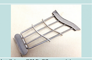

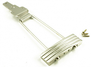

    B6 Bigsby instead, since the archtop would give a decent amount of break angle anyway, and I don't have to screw into the top. Or, I'd love to use a Click image for larger version.
Name:	Screen Shot 2020-12-11 at 9.32.53 pm.png
    Hofner "Harp" tailpiece, like the original Harmony H62 has, or a Click image for larger version.
Name:	Screen Shot 2020-12-11 at 9.34.26 pm.png
    Kluson #6, which may have been the Harmony backup plan, presumably, when the Hofner tailpiece went up in price.
