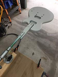

Name:	LP2 primed.jpg
ID:	34371 Click image for larger version.

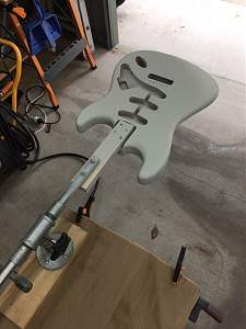

Name:	ST primed.jpg
ID:	34370 Click image for larger version.

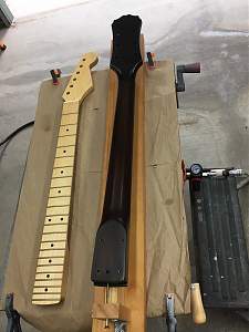

Name:	Two Necks.jpg
    Build #1 is an LP-ish kind of thing. Mahogany body, mahogany neck, rosewood fb (24.75" scale).
    It will be Red Candy Pearl with a clear coat (ac lac). The neck is already finished with satin poly. There will be a slight departure from the norm as it will feature 2 single coils with a Twisted Tele neck pickup and a Texas Special bridge pickup. Standard 1V,1T, 3-way toggle.

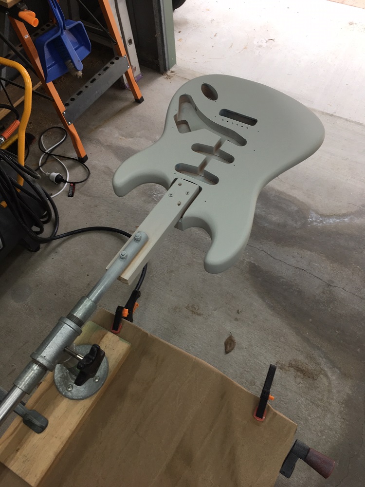

    Build #2 is a strat but also with some small deviations. Alder body with maple/maple neck (also finished in satin poly). Rounded plate-less neck join recessed bushings). I'll put in a set of Tonerider Classic Blues but with 7-way switching and Leo Fender's PTB circuit (Passive Treble Bass).
    The finish on this one is where I'm getting a little experimental (at least for me).
    I'll do a base coat of metallic silver and apply a trans-blue "clear coat". It's my first time tinting a clear lacquer, so we'll see how it goes. I have heaps of clear to spray test pieces beforehand.

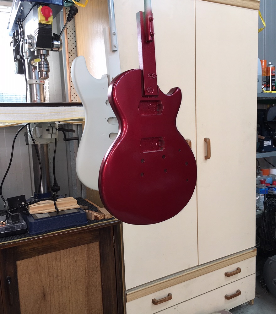

    A little progress with the singlecut body yesterday.
    Base coat and clear coats on. I'm still learning the technique of gun spraying, so I did get some orange peel.
    However, it's still less than I ever got with rattle cans and completely workable.
    I'll let this one sit for 14 days before moving on to sand & polish.
    In the mean time, I'll do some testing with the tinted clear for the strat and hopefully get base & clear on that soon.
Name:	Candy Red Pearl.jpg
