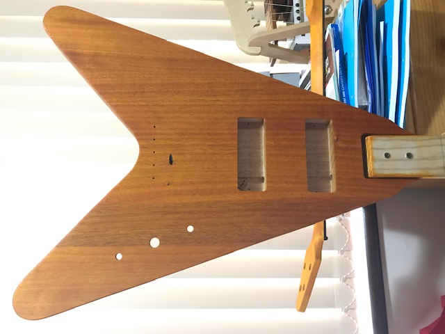

    After sanding, I have given the body and the neck two coats of dingotone - Coolangatta gold. It has come out a little darker than I expected , but I am happy with it. The neck will need a few more coats to match the body.

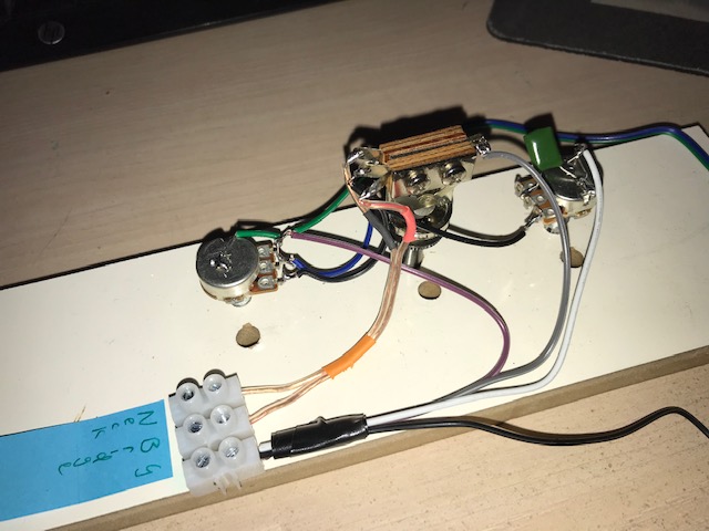

    So I decided to give the soldering a go. I have swapped the 3-way switch with an all black one I purchased. I have left room for the pup wires on the connector strip. I purchased some Irwin wire stripping pliers which did a great job at removing the insulation.
    It has been a while since I soldered, but all seemed to go OK.

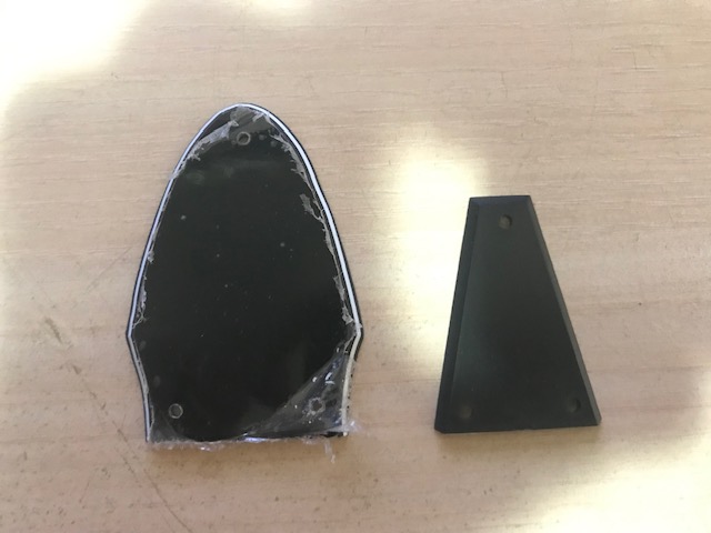

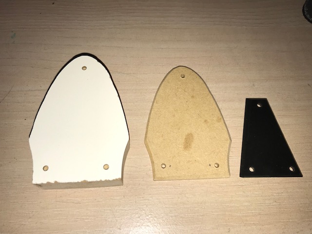

    I have also had a go at making a wooden template to make a custom truss rod cover - some 3-ply pick guard is on its way. My trial with MDF sheet worked well using a router table with flush trim bit followed by 45o bit.

    I have now completed the 3 ply truss rod cover.

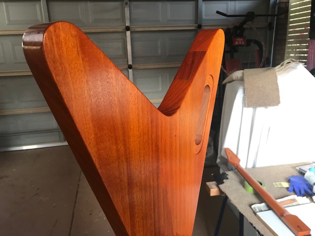

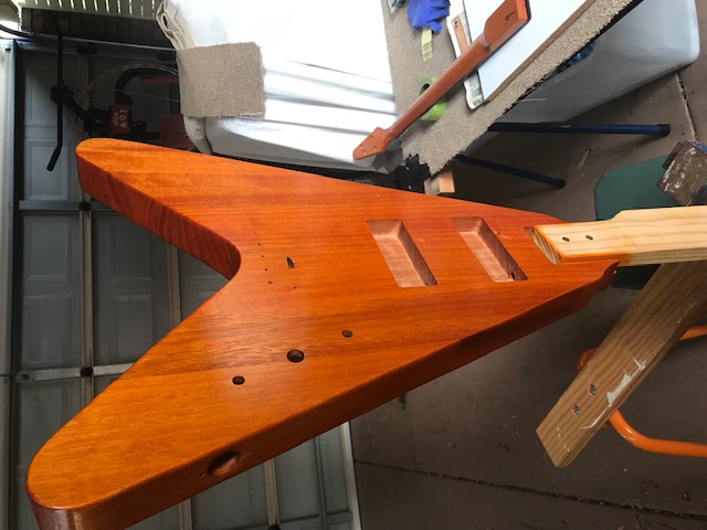

    Started coating the body and neck in tru-oil - 4 coats so far.

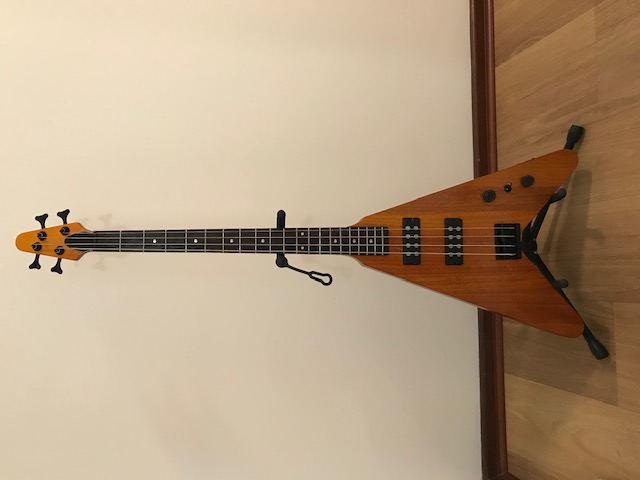

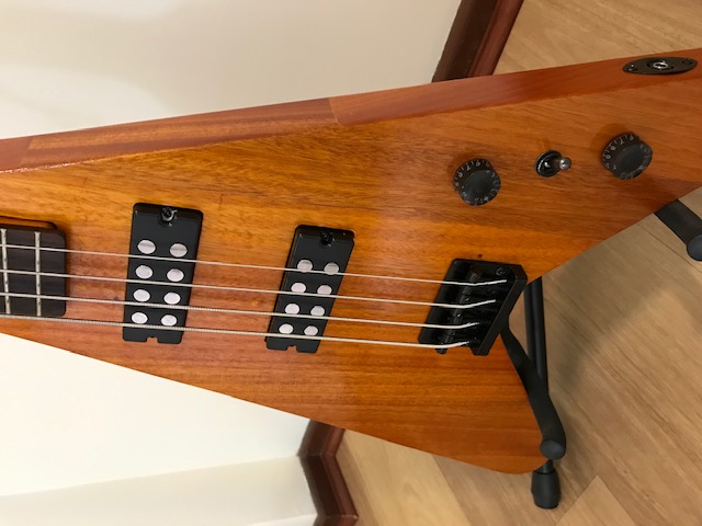

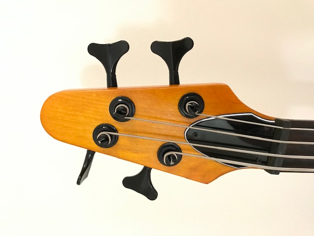

    Put it all together. All the electronics works - yeah. Still need to do correct setup.
