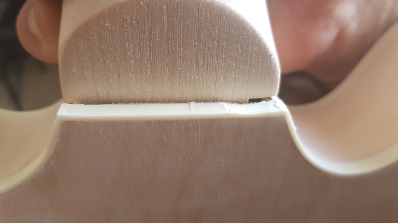

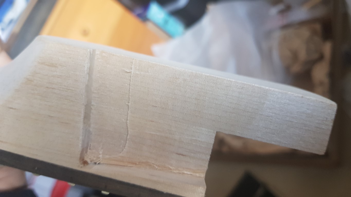

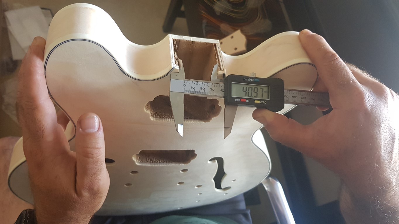

    I've just taken receipt of my ES-1Q kit and in the process of part checking and doing the mock build I noticed that the neck is a really loose fit in the pocket. It's so loose that when I insert it there is absolutely no friction. Also, I can pull the neck out about 15mm which I though the joint taper would prevent. With neck installed, I can wiggle it side to side so much that the headstock moves around 20mm. Surely that can't be right? The quality of finish inside the neck pocket and on the neck joint itself is not great.
    I'm thinking that I may have been sent an unmatched pair but can't be sure. The body is labelled "5" and the neck is labelled "4" if that means anything?
    I've attached a few photos and posted a video (https://youtu.be/S99x_nS7ePM) to illustrate. I've sent an email to PBG to let them know and waiting to hear back from them. I just wondered if anybody had any similar experience or advice or is this body/neck combination a lost cause?

    Hi and Welcome PorkyPig,
    I have not done an ES kit but that looks very wrong. I have done an SSCM kit with a similar (same!) neck and pocket and it did not look like that.

    If the numbers don't match then that's probably the issue. I'm no expert and I'm sure others will give you much better advice but the photo of neck heel and neck pocket shows some fairly shoddy work. None of that looks good to me.

    Wow. That's by far the worst I've seen posted here.
    I sure PBG will make it right, but that never should have left the warehouse. I hate to say it but there seems to a steady stream of crap kits coming out. I know things have been hard for everyone in manufacturing the past two years with COVID, but that's no excuse for making rubbish.

    Definitely sounds like an unmatched neck and body. Those numbers have always matched on my set-neck kits.
    And that kit's definitely getting replaced!
    Also in case you haven't read other ES-1 build diaries, the neck angle is almost always too shallow on these kits, meaning that with the standard kit bridge at its lowest setting the strings still end up a long way from the fretboard.
    If this is the case, you can shim the neck to increase the angle, but due to the style of neck joint, you'll either end up with some gaps that will need filling, or you'll need to get the chisel out and change the angle of some of those neck joins.
    I found this out too late on my ES-1 kit and ended up fitting rimless bridge post hole inserts and getting a Goldo Lowrider bridge (which you'll probably need to source from Germany or somewhere in the EU). https://www.fredguitar.com/en/gibson...er-bridge.html. It is a good quality, very low profile bridge.
    The kit bridge is very much the same size as the standard Gibson, Gotoh, Schaller or Tonepros bridges, so nothing inherently wrong with it. It's just the neck angle!
