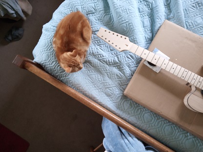

    A gift from the kiddo because he wants to hear me fingerpick a 12.
    Name:  IMG_20210108_164507 (002) small.jpg
Size:  17.7 KBClick image for larger version.
Name:	IMG_20210108_164517 (002)small.jpg
    Experienced mild confusion re bridge and holes for strings. Duh - different to acoustic guitars, but finally figured it out. All the parts are there and seems I have stuffed up already by sanding across the binding. Last resort could rout it off with a bullnose router bit.
    Any other 12 string builders out there?

    That kitty seems ready to claim the box that it came in.
