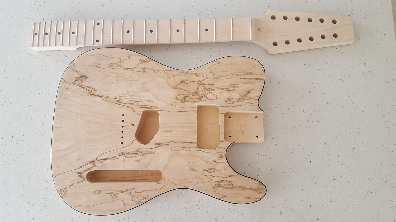

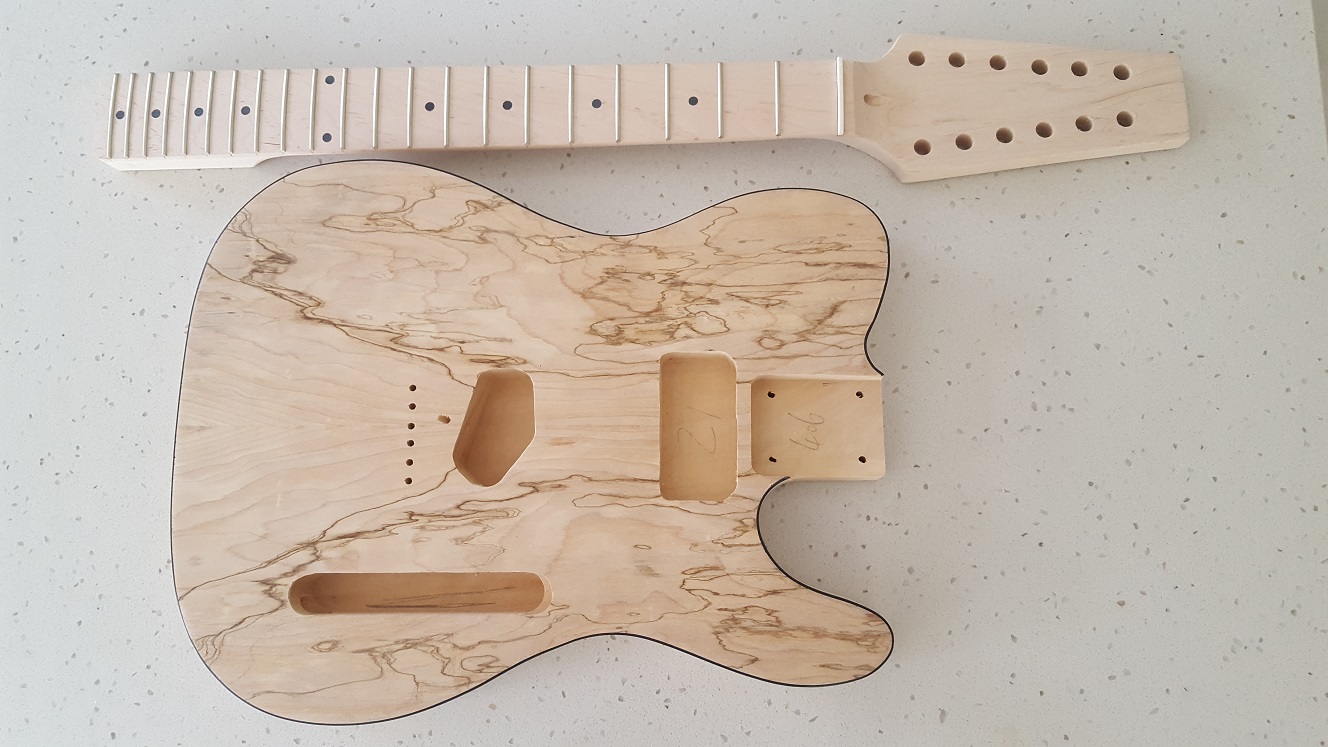

    5th build, this one for my 12 string loving wife. Spalted maple 12 string tele.

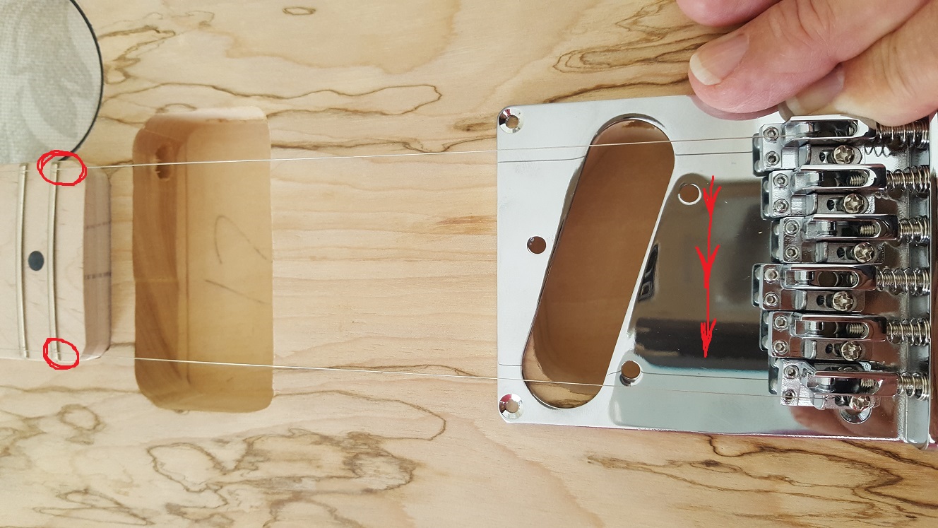

    Been about 7 months since the kit arrived but life and other projects have been in the way. A little work on the end of the neck to allow full socket fit. Back when it arrived I quickly saw the routing and the neck were having an argument, bridge has to move south.

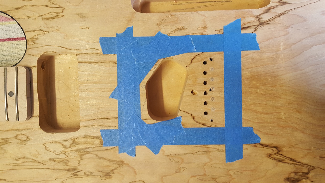

    This week I also saw the bridge has to not only go south but a good old amount west. Plug all pre-drilled holes, tape off the good area and get the Dremel to work.

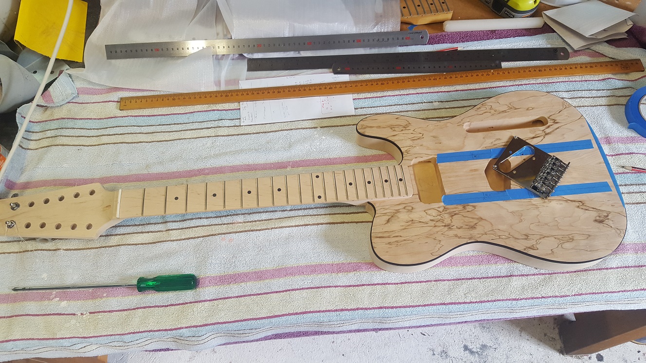

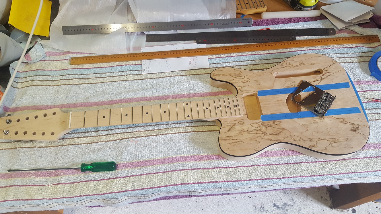

    Happy with the progress, thinking, well hoping each project will be better than the previous.
