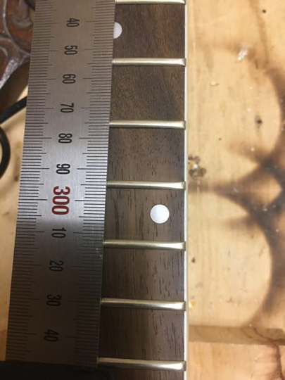

    Ok, so to work out the position of a fixed bridge is to measure from the nut to the middle of the 12th fret and double.
    313mm x 2 = 626mm by my calculations. However, I think I have read how there is more to it involving measuring to an E saddle wound all the way forward (towards the nut direction). I wish I had been paying better attention now. Can anyone elaborate? Thanks.
    Edit: Using flat wound strings.
