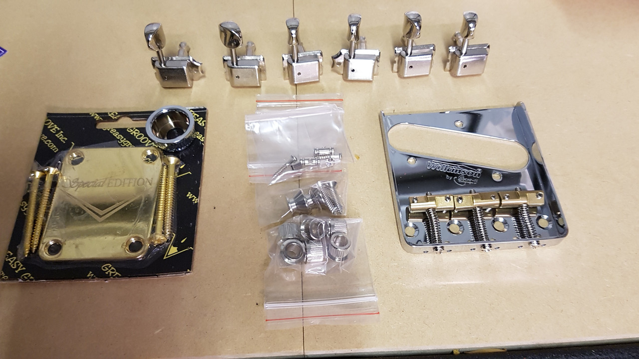

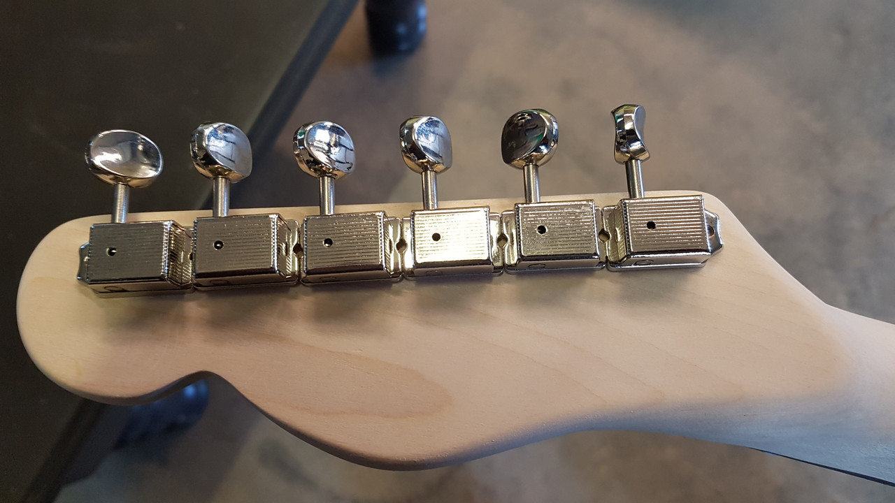

Conversion bushes are in and all tuners line up :)
https://s19.postimg.cc/x3ef91xf7/20180701_160113.jpg
More bits arrived today, from Ace guitar parts:
https://s19.postimg.cc/anwg9y3v7/20180702_181317.jpg

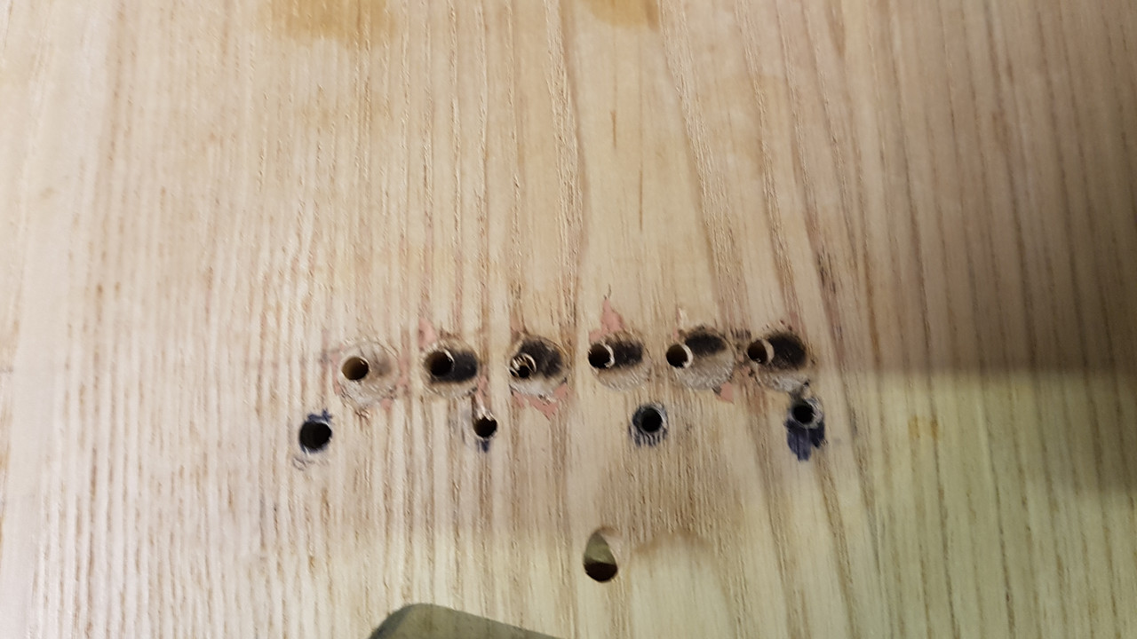

Lining up OK,except for the string through holes. Strings do go through, though:
https://s19.postimg.cc/9ydnxlb1f/20180702_182352.jpg
D'oh!!!
BTW to cover the sloppy string through holes on the back, I got one of these.
https://www.ebay.com/itm/1Pcs-Electr...EAAOSwi8xaS2uH
cheers, Mark.

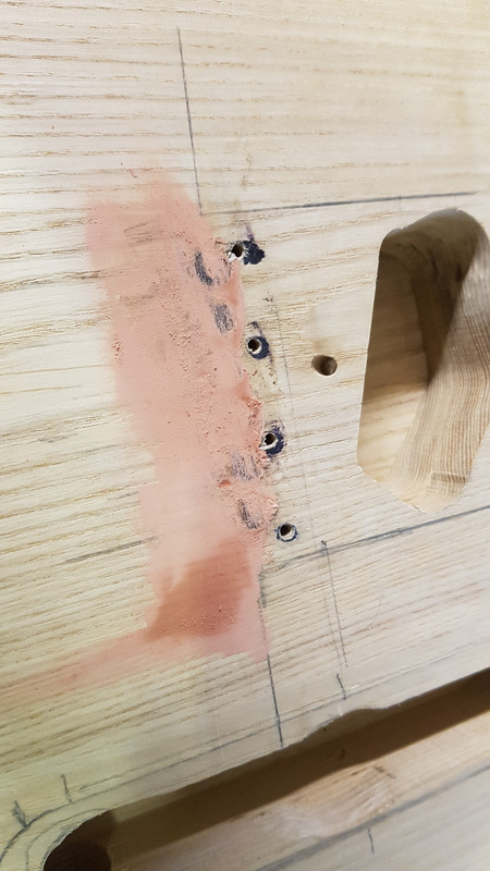

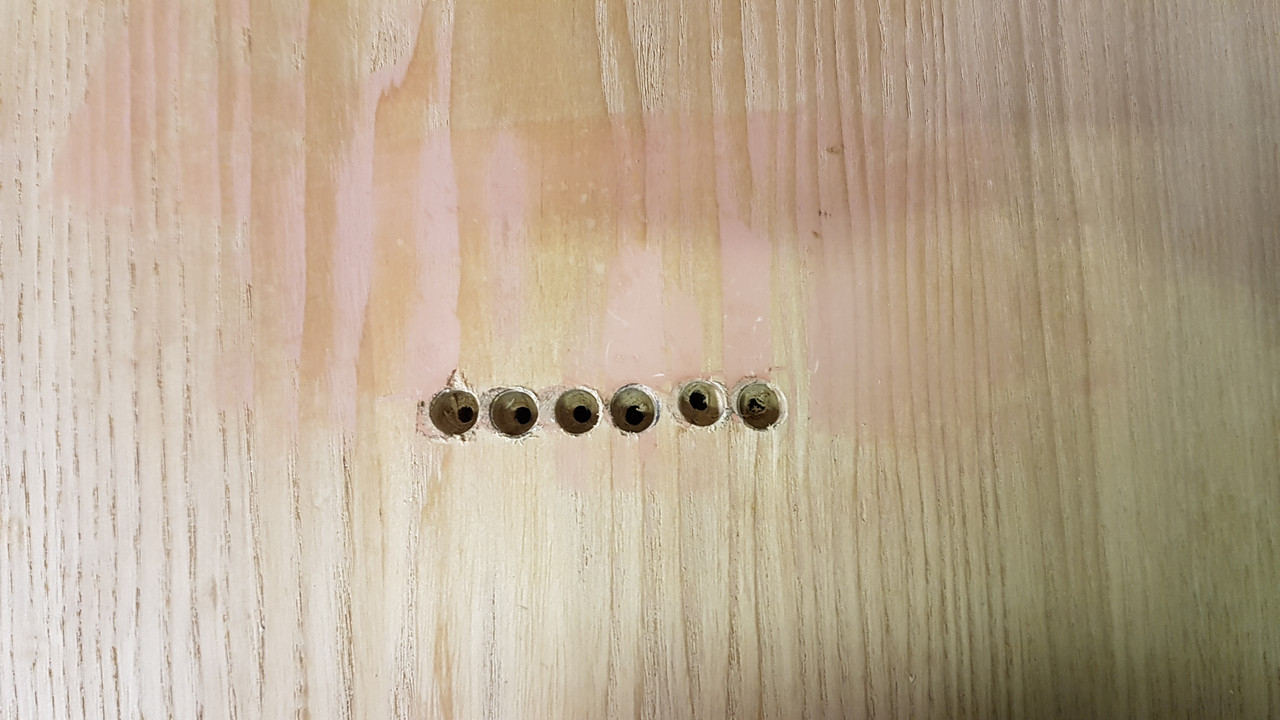

Today I found out that the local mechanic has a drill press, so I decided to fill and drill.
Lucky it's going to be a solid colour:
https://s19.postimg.cc/uinjtfa1f/20180703_155822.jpg
https://s19.postimg.cc/goz74fmlv/20180703_165614.jpg
https://s19.postimg.cc/cslv8ebw3/20180703_165629.jpg
That bridge plate is also a string through from on top so no need to re-drill string through if you don't want to.
Though it won't sound quite like a Tele without them.
For a nice neat line of string ferrules on the rear of the body, you really need to drill from both sides.
Start by getting the bridge positioned correctly on the top of the body, then mark the position of the six string holes.
Ideally using a drill press, or else a drill stand to keep the drill vertical, drill the two outer holes all the way through the body, but the four inner ones only 2/3 of the way through (mark the drill bit with tape to stop going too far.
Turn the guitar body over and using the bridge as a template, position the two outer string holes over the holes in the body and mark the position of the four inner string holes.
Now drill these string holes, again going about 2/3 the way through the body (so don’t remove the tape from the drill until you’ve done this).
Now you should have a nice neat row of string holes on the back, all ready for widening to fit the ferrules in.
Thanks for that Simon, I will ask the mechanic to do it like that, but haven't seen his press yet :eek:

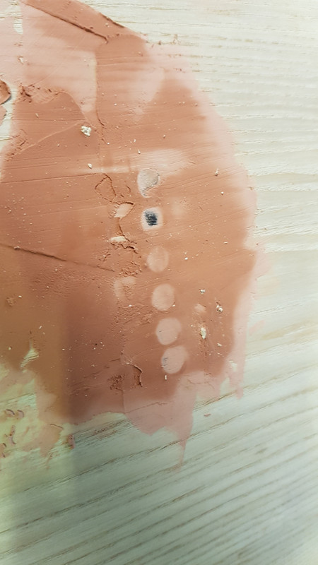

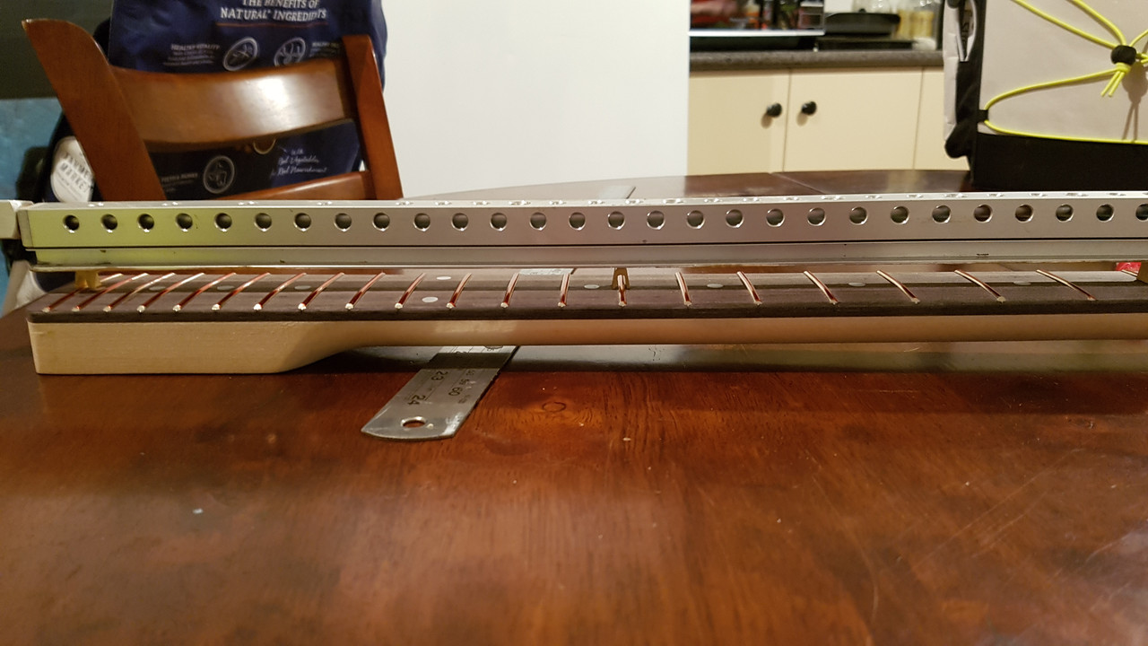

Whilst waiting for second lot of filler to dry, I did a bit of levelling:
https://s19.postimg.cc/6xftkmsur/20180704_190235.jpg
https://s19.postimg.cc/r4t9cy5rn/20180704_192437.jpg

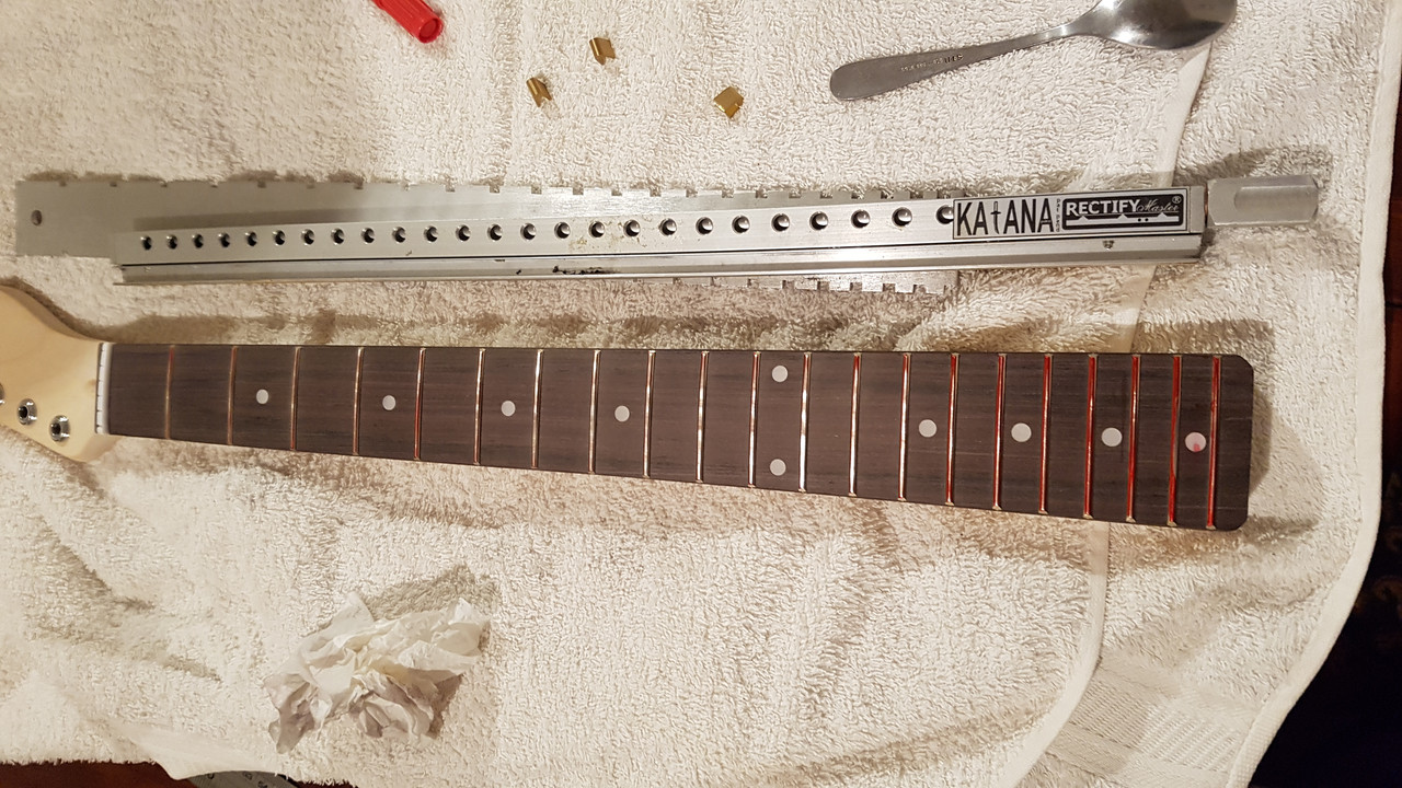

Last try:
https://s19.postimg.cc/52zarttqr/20180706_181033.jpg
I think this will be OK:
https://s19.postimg.cc/77jnswnnn/20180706_181008.jpg

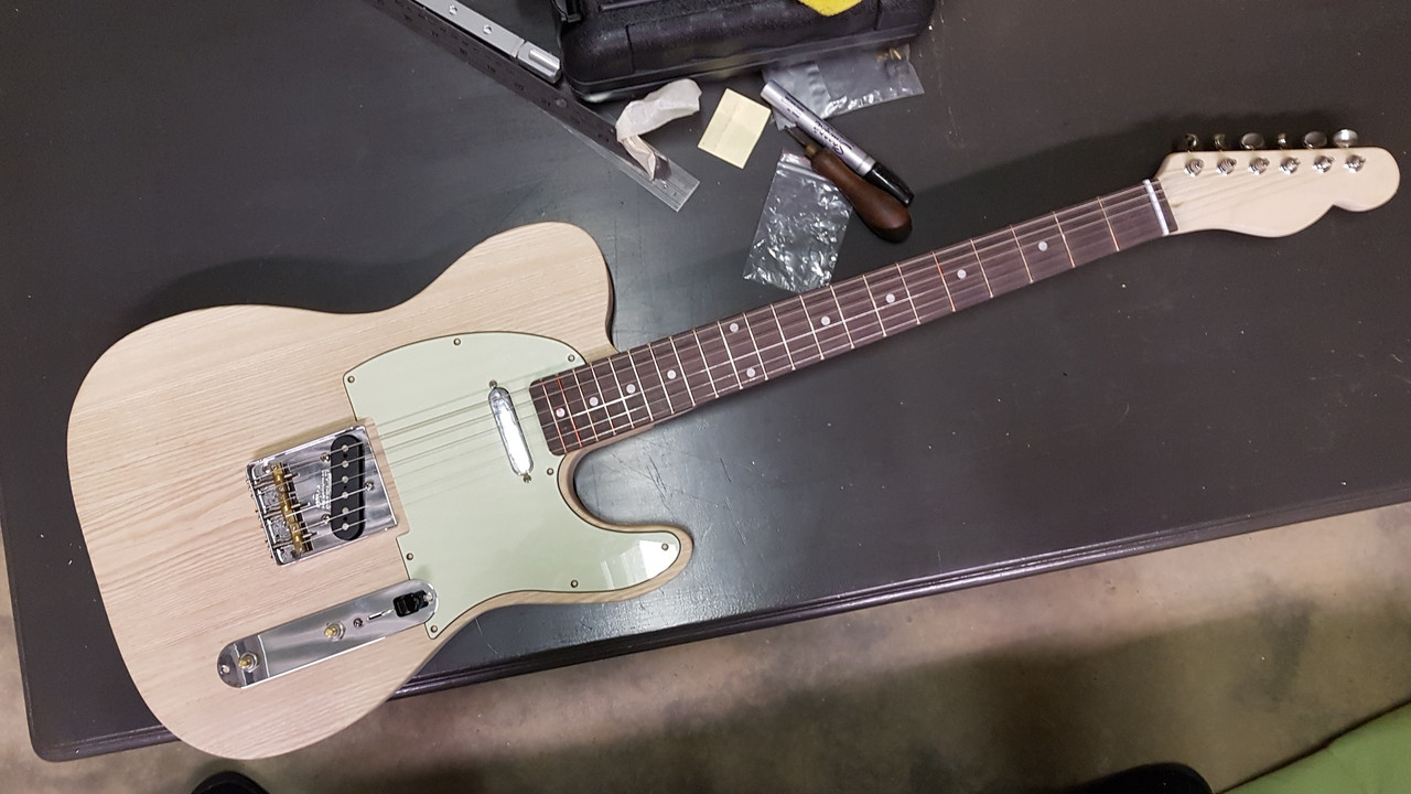

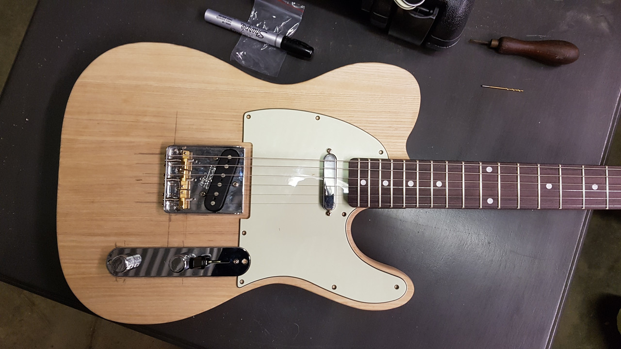

I put it together again, but this time tuned to pitch (top load configuration only, no electronics). I am happy to report everything fine and quite loud acoustically :) I still need to drill holes for the PG, but it is too cold and damp for painting ATM, anyway.
https://s19.postimg.cc/57ln8ukgz/20180708_181533.jpg
Looks good.
On my phone the scratch plate looks pale mint green?
The mint looks cool and cannot remember what you had in mind for colour scheme?
Should look nice.

The body got its second coat of sanding sealer. It's a pity I ruined the string through holes as it is looking nice with just the sanding sealer applied:
https://s19.postimg.cc/5bcze5jvn/20180831_105749.jpg
https://s19.postimg.cc/crc8zwpkj/20180831_105803.jpg
