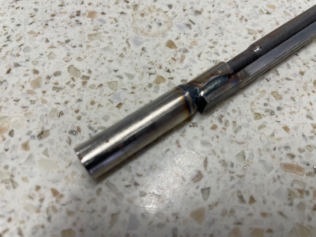

    1,799
    I'm not sure, but this is what they look like! This is from a bass neck.

    2,788
    I am getting ready to thin my a PB neck just a bit. TD, if you still have this truss rod would it be possible to measure it's height? I have been doing my calculations with the dimensions of Stew Mac's normal size truss rods that are 11.1 mm... but the the one in your pick looks like a low profile truss rod that should be somewhere between 9-9.5mm. I'll still use the Stew Mac dimensions...but would be nice to know if there is a margin for error if I get a little aggressive ;-)
    1,799
    Hi fender3x,
    It is at work. I will measure it tomorrow!
    TD

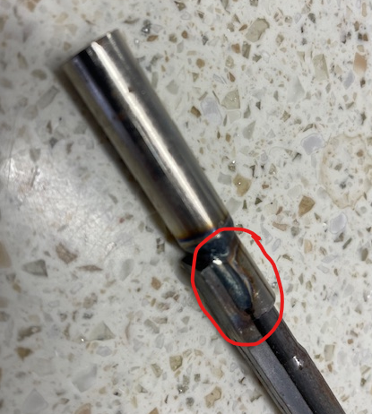

    2,788
    That certainly looks like a weld to me.
    Also you really have to admire how far TD will go to help someone out. Pulling the truss rod out of a bass neck is definitely going above and beyond!
    1,799
    Thanks fender3x. But, ERRR, to be honest, I had actually pulled it out a year ago. The neck was a reject with a very bad twist! But I did want to see how they worked. I run a guitar building "club" at the school where I work with a small group of students (we meet 1 lunchtime a week). It is a great way to model and show the action of the truss rod.
