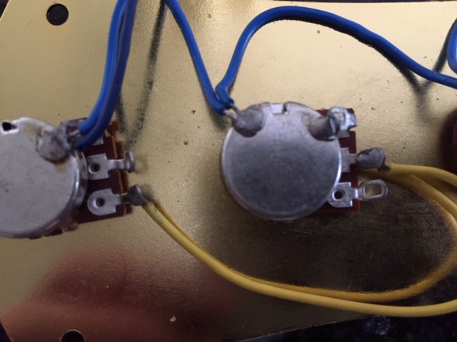

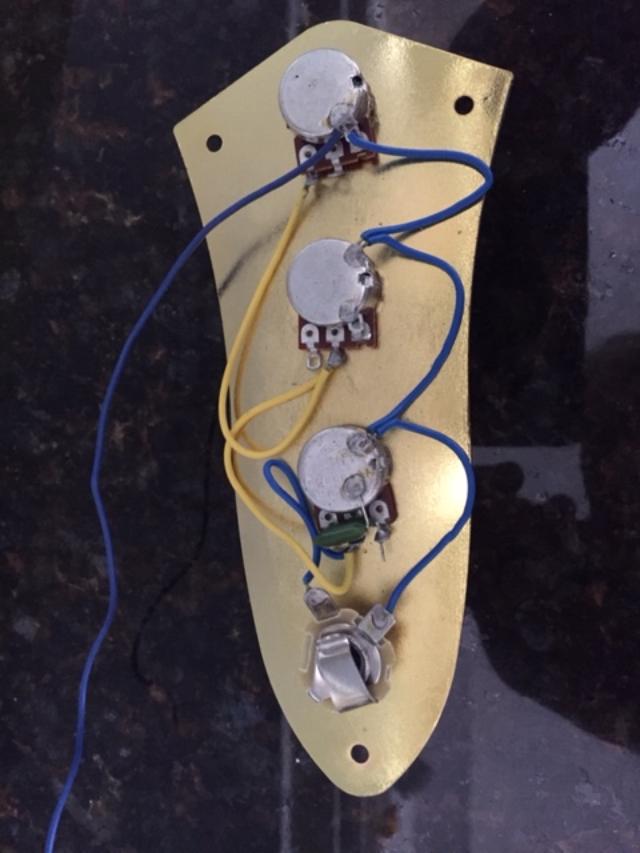

    Hello all. Building a bass guitar with my grandson and can't find a wiring diagram that seems to fit the kit we bought. We have a DJZ-4 with what looks like two volume knobs and perhaps a tone knob. I've attached pictures of the front and back of the knob plate as wired. Can anyone please let me know how to proceed with the wiring. Thanks much.

    Thanks much guys, can I please bother you for two clarifications:
    1. On my prewired unit the bridge ground goes from the neck volume pot vs the tone volume pot in the diagram, but since these are all wired together I'd assume this makes no difference.
    2. On my prewire, the wire from the middle post of the tone pot goes to the middle post of the bridge volume pot and then to the left post of the neck pickup pot. In the wiring diagram it is shown as the middle post of the tone pot to the left post of both the bridge and neck volume pots. Since the hot wire from the bridge pick-up goes to the middle post in the diagram and the prewire to the left post of the bridge pick-up, do I need to move the prewire to the left post? Or do I just put the hot wire from the bridge pick-up on the left post of the pot?
    Also as a confirmation, the bridge hot wire is red in the PitBull diagram and on my pick-up, but the drawing says White--I assume this is just errata?

    1. Bridge ground wire - doesn't matter where it comes from - just needs to end at the bridge and form a connection (but not a loop) with all pots, the jack and the bridge.
    2. Prewire should be fine - same as cats - many ways to skin a wiring diagram.
    Colours of the wires change over time - the diagrams are indicative and I've coloured them to make the wires easier to follow. Otherwise we are playing with lots of grey and black lines that overlap.

    Thanks Brendan. Sorry to be such a pain. so, for connecting the bridge hot wire I should connect that to the unused (left) terminal of the bridge pot and not the already used center pot. Is that correct?

    I think I understand what you're asking, but to confirm - any chance of a photo?

    I think I uploaded the pix--struggling a bit with the site protocal
