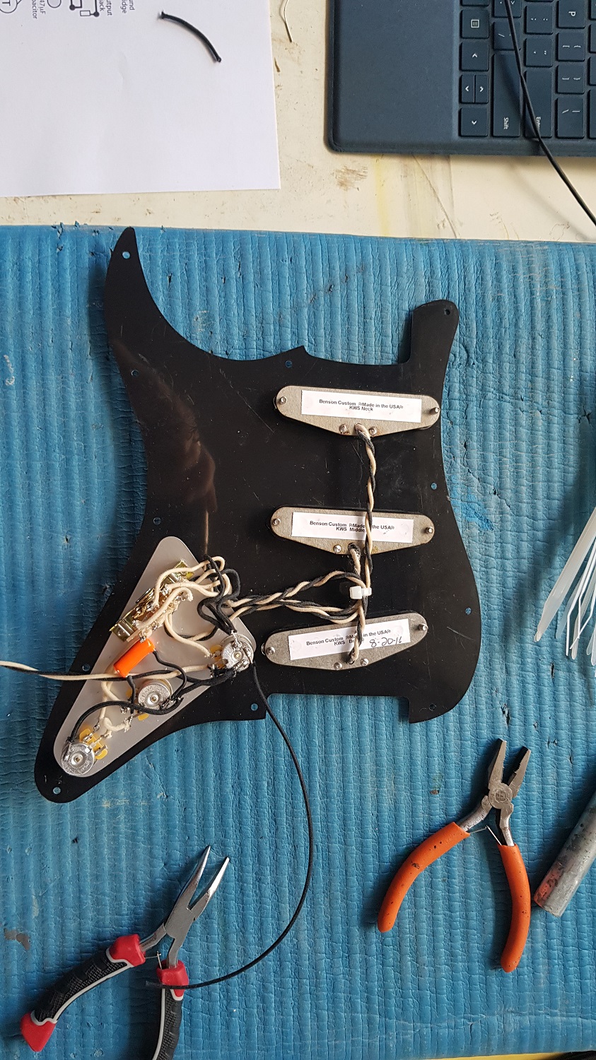

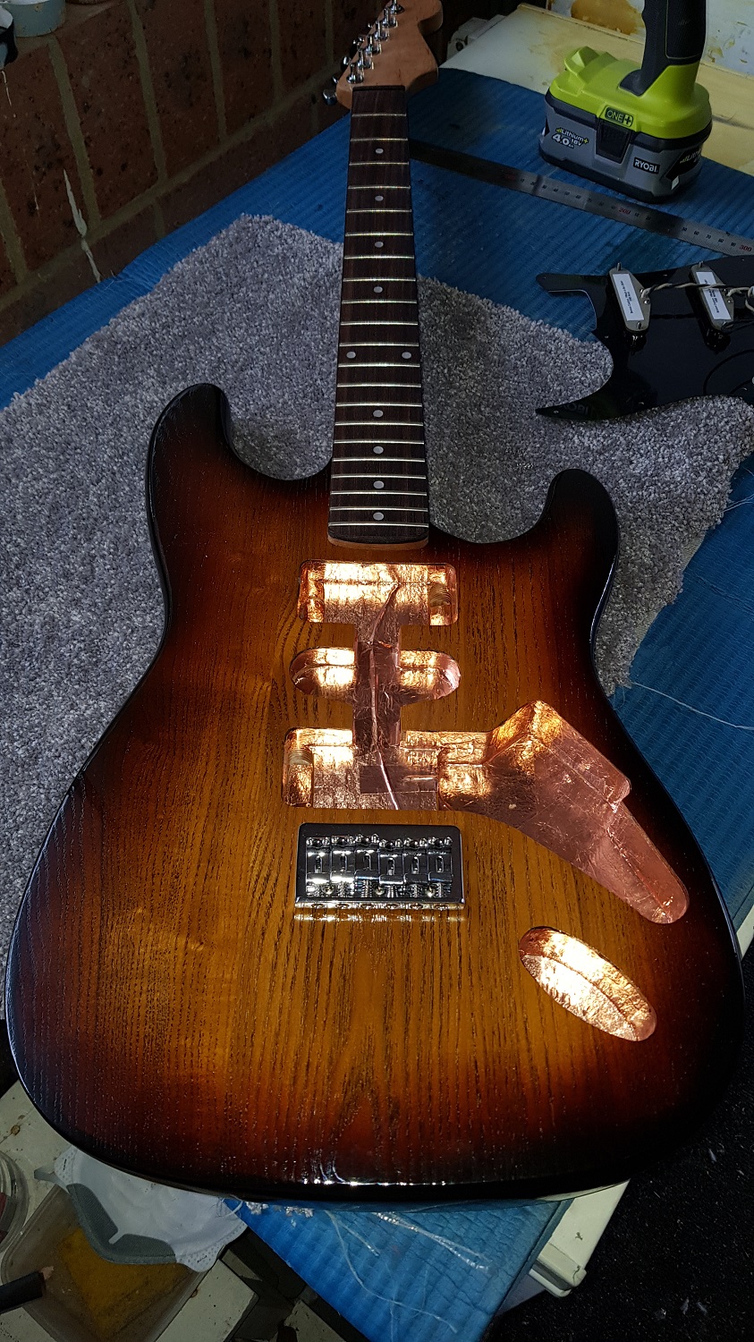

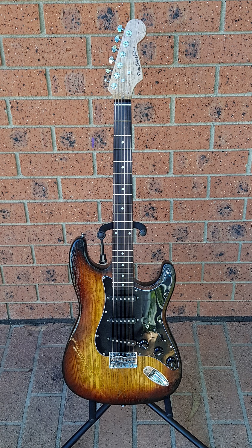

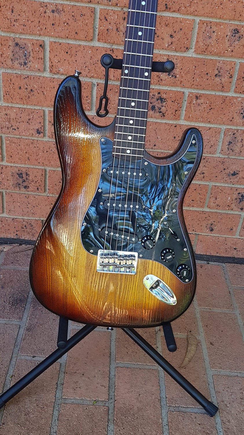

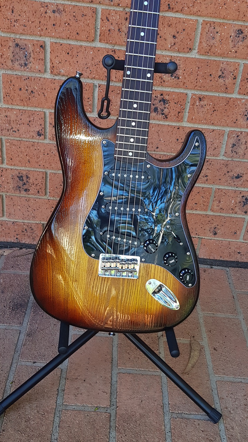

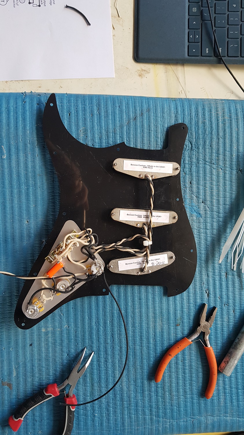

    First Cab of the Rank this Month, was actually ready Sunday, but didn't have time to upload. So here we go.
    HT Strat
    Grover Locking Tuners
    Bone Nut
    Upgraded Bridge to support String Through - Really happy how that turned out as no drill press, all hand and eye.
    Benson Custom Kenny Wayne Sheppard pickups
    Nitro Sunburst Finish Body, Tru Oil Neck
    CTS ports and Orange Drop Cap
    Thanks to Sonic for the Erina Creek Guitars logo.
    Ready for final assembly.
Name:	ready for assembly1.jpg
Name:	ready for assembly2.jpg
    Front

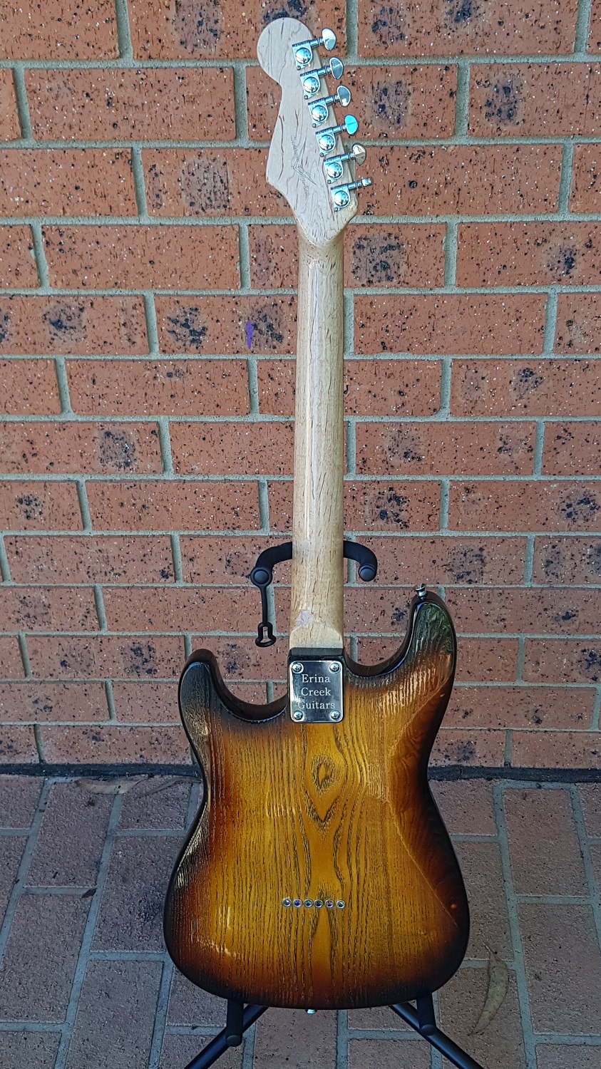

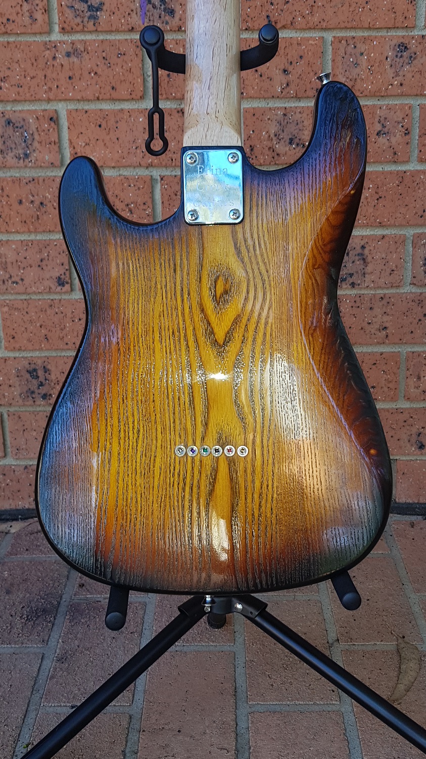

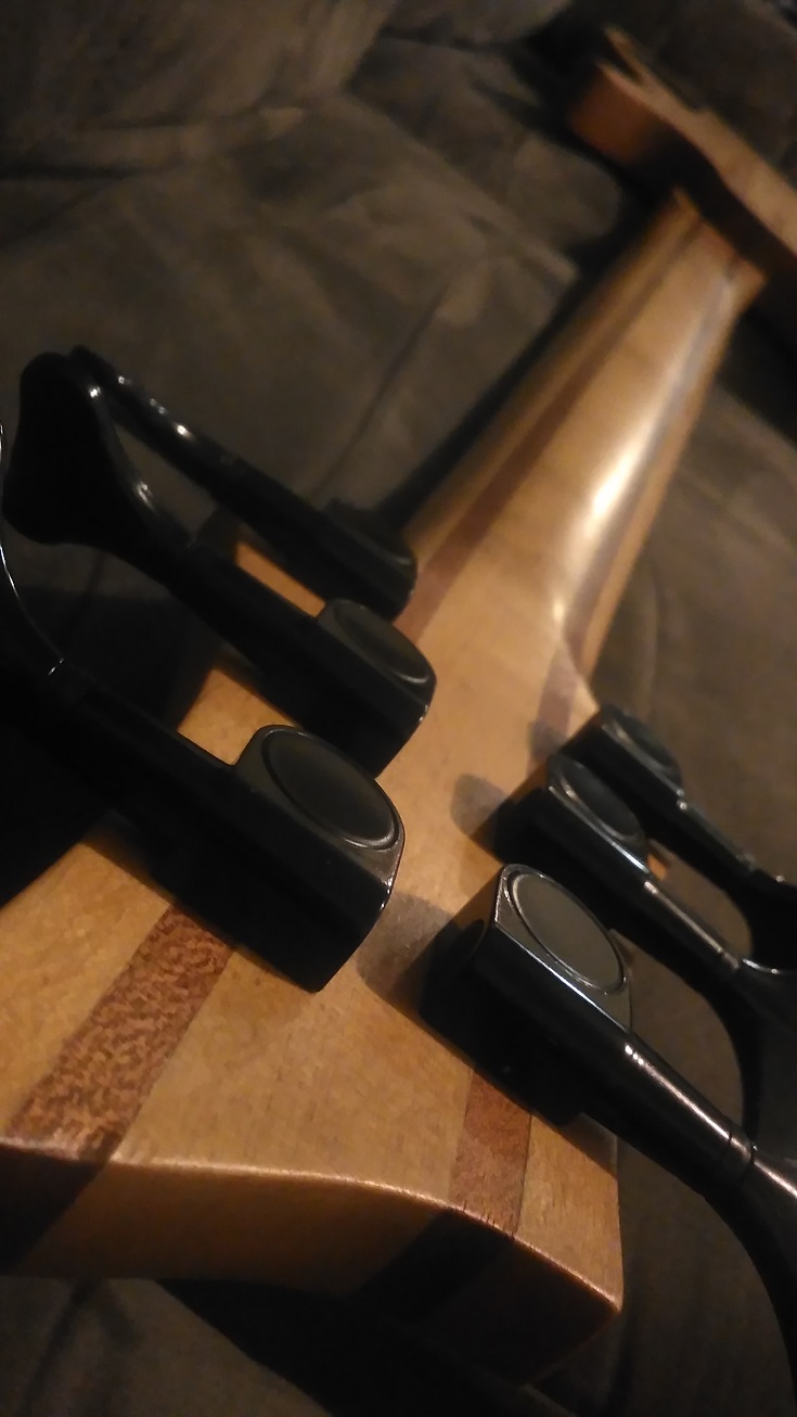

    Back - Interesting neck grain I think, Hadn't seen before.

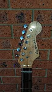

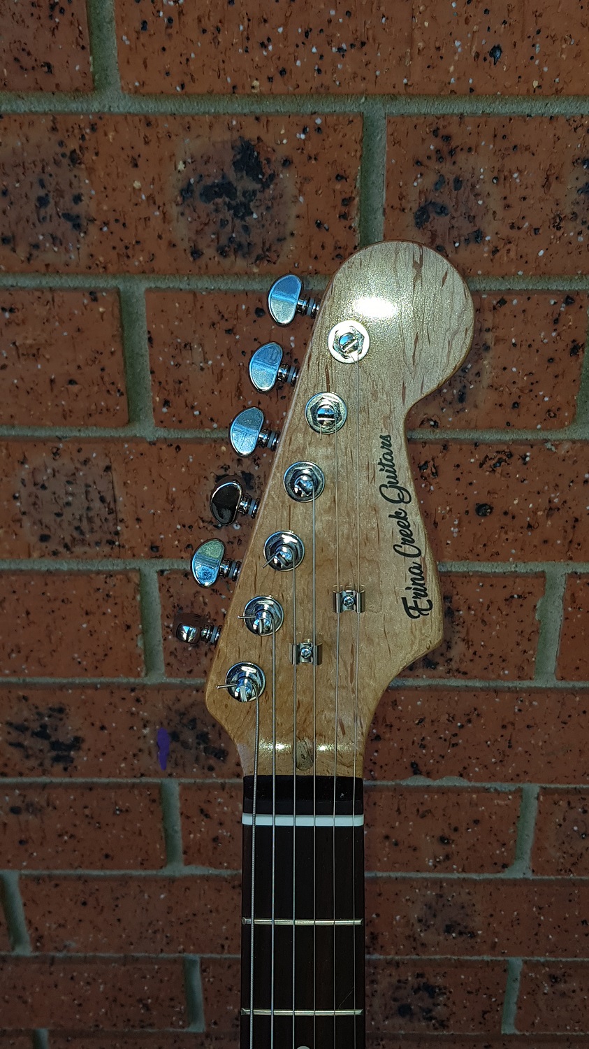

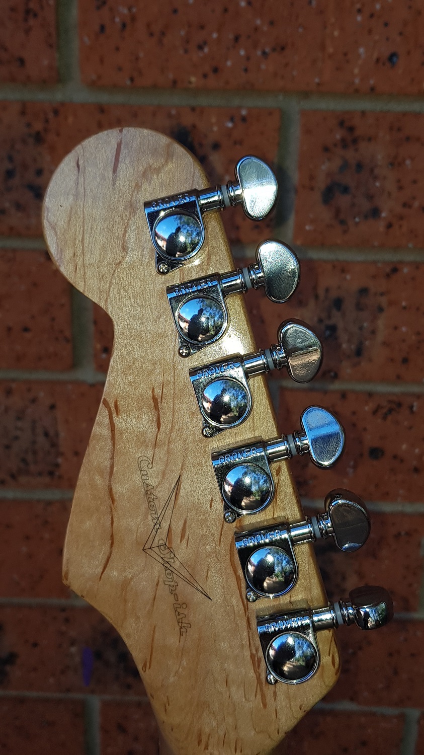

    Headstock

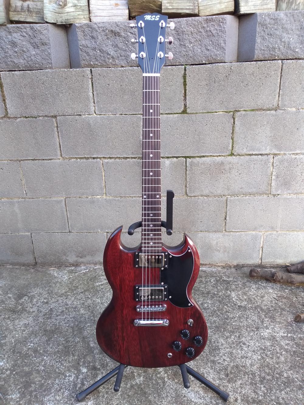

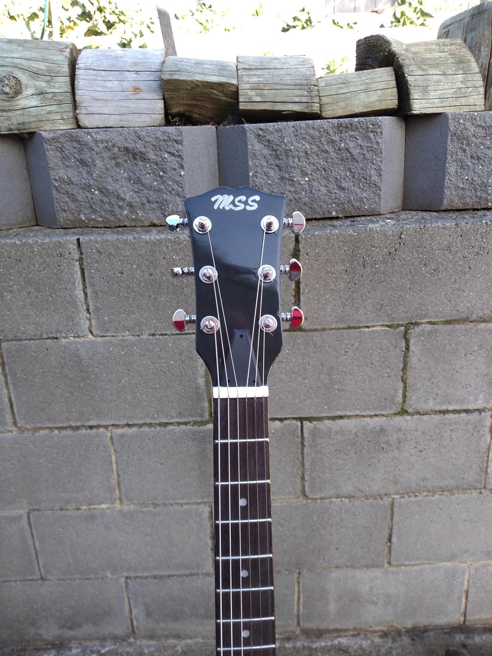

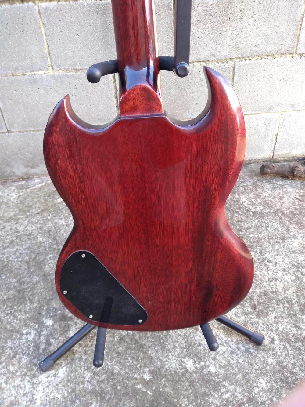

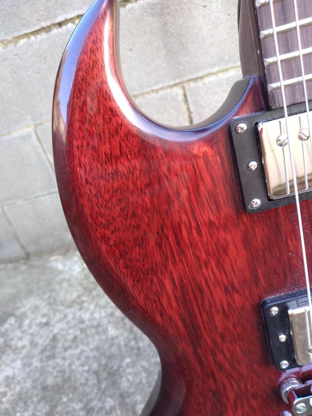

    Took a few months to finish the SG. I think I picked a hard project for my first one. However apart from a few pitfalls things went OK.
    The finish was exactly the colour I was after. Feast and watson mahogany stain followed by clear poly coats. A classic dark mahogany colour similar to a SG custom I had many years ago.
    Upgrades were:
    Bone Nut
    Tonerider AC2 pickups
    Gotoh Tunomatic bridge and tail piece
    Grover locking machine heads
    Everything set up, frets levelled and polished and I think it sounds great.
    Heres the pics.
