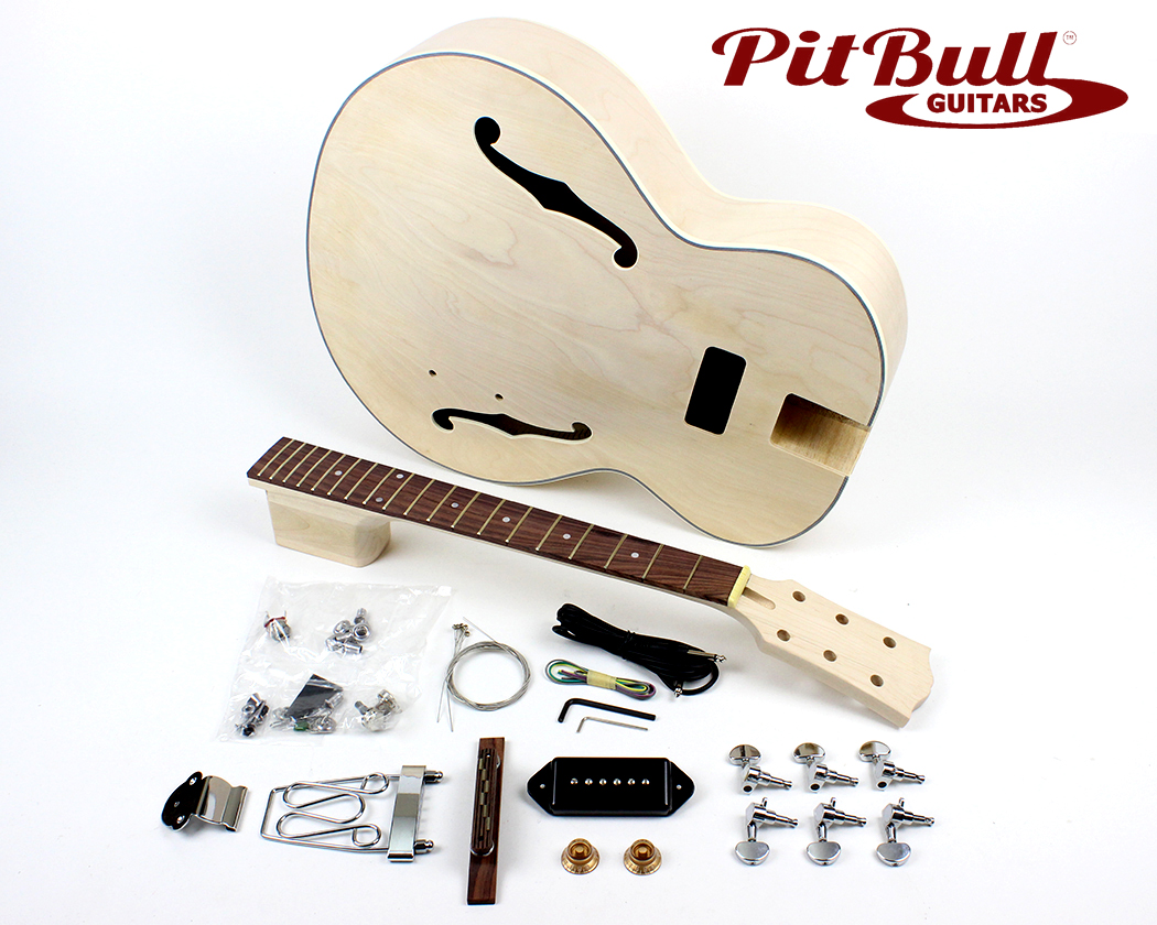

    I'm in the process of purchasing a PBG ES-5V ELECTRIC GUITAR KIT. I want to be sure I order the correct upgrade items. I'd appreciate input from other kit builders.
    Grover Chrome 3+3 Mini Locking Rotomatics (406C) *UPGRADE ONLY*
    PBG BONE NUT FOR G TYPE 6 STRING GUITAR KITS – BLEACHED WHITE NUTS, UPGRADES
    PIT BULL GUITARS G TYPE BONE NUT FOR 6 STRING GUITAR KITS (42MM)
    These Bone Nuts are designed to fit our G Type Guitar kits (AG, EX, FV, RD, etc) and any Gibson® Guitars
    with a 42mm Nut width.
    Is this the above bone nut correct for my kit?
    Pit Bull Guitars Luthier's Choice Set Neck Glue (9ml)
    DINGOTONE SHIELDING KIT – QUALITY COPPER SHIELDING TAPE
    I found these neck pickup options available on the PBG website but I want to get the best quality and ensure I get the correct pickup for my kit. Your opinion on whether I would see a difference over what the standard kit provides would be very helpful.
    BENSON CUSTOM HEAVY BLUES P-90 SOAPBAR – NECK PICKUP – CREAM
    TONERIDER R90N REBEL 90 NECK – NICKEL
    TONERIDER R90N REBEL 90 NECK – GOLD
    Entwistle pickups appear to be primarily for Bass guitars and offers no substitute for the standard P90 provided
    with the kit or do I have that wrong?
    If you have any other upgrades that you think are appropriate for my kit, please let me know.
    I'm disappointed that I am unable to include your Dingo finish products but I understand air shipment restrictions. Any suggestions on similar finish products I could buy locally?
    I am studying PBG documentation. Is there a guide specifically for this kit or are DIY Guitar and Bass Kit Instruction Manual and Pit Bull Guitar Forum the only references available?
    Sorry to throw so much at everyone but I'm pretty excited about buying your kit and I want to make the most of it!
    Rick

    Hiya Rokitrik,
    Firstly, welcome to the forum!
    The Grovers are always a good choice. The kit ones are functional, but the Grovers are far nicer in tuning feel.
    The nut should be good to go, but you might need to do some final shaping/trimming.
    Thee glue is fine, but you could probably source Titebond or similar where you are for a lot less hassle.
    Being a hollow body, the shielding tape is going to be a bit pointless. Unless you can shield the entirety of the body internally it's not going to accomplish much. From what i have read and done, shielded wire may be a better option, but that gets pricey and i don't believe you can get it from PBG.
    I think you need to be careful with the pickup, you want to make sure you get a p90 "Dog Ear" (Has the triangular flanges on the sides) i'm not sure the Soap Bars will work with the ES-5 (Can one of the hollow body enthusiasts provide some expert opinion here?)
    In terms of guidance, your best bet is to take a wander through the build threads, using Search term ES-5. There have been a number of SPECTAC.....(wait for it...)...ULAR build with this kit in the past couple of years and these guys have run across and overcome a wide gamut of issues.
    Look for the ES-5 builds from Dedman, Darkmark, BlindDrew as those have become objects of rare beauty...and they sound damn good too! There is a display thread for finished ones here: https://www.buildyourownguitar.com.a...ead.php?t=6424
    The guide is a comprehensive generic reference intended to give you all of the basics for finish, fit, wiring etc.
    Hope that helps. Look forward to seeing how you go!
