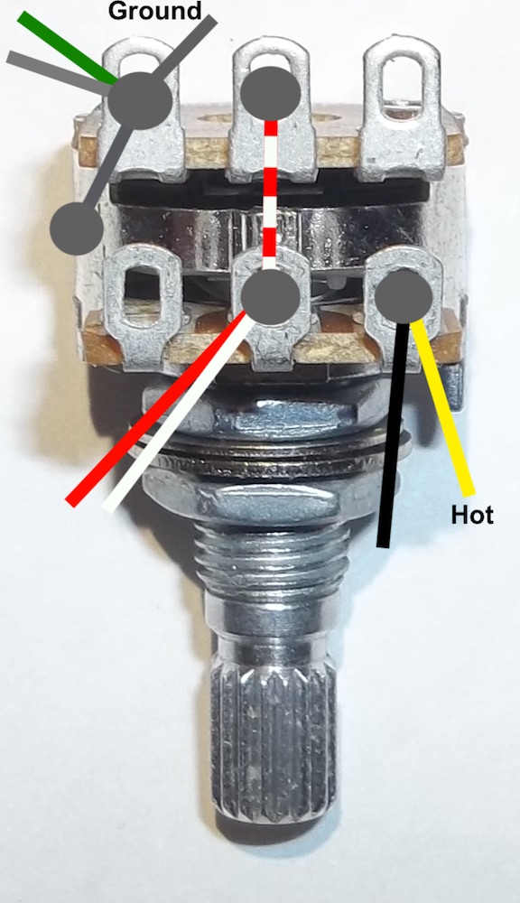

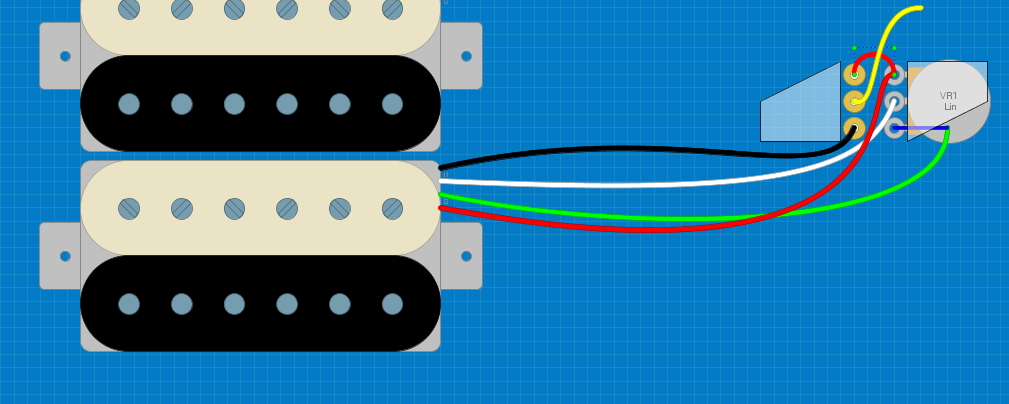

    I've built a bunch of guitars and a bunch of pedals but I've never actually plotted out my own circuit. Here's what I'm trying to accomplish with an MN taper dual gang pot and a humbucker:
    Dial Position
    - Centre detent - full humbucker (ie both coils wired in series, polarity reversed on one side)
    - Full right - right coil only
    - Full left - left coil only
    And here's what I've got for the wiring:

    (as per Seymour Duncan colour codes)
    GREEN = start of adjustable/south coil
    RED = finish of adjustable/south coil
    BLACK = start of stud/north coil
    WHITE = finish of stud/north coil
    So my thinking is that Green will always go to ground, and on the top pot the wiper blends between ground and the hot output of the south coil (red), then feeds that on to the north coil (white). On the bottom pot, I have the hot output (yellow) from the wiper panning between the output of the north coil and the output of the south coil. It seems okay to me, but I'm wondering if there's an issue in wiring the south coil output to both pots. I can live with a bit of weirdness in the blend between the black and red on the bottom pot, as long as it behaves properly at both extents of the taper.
    Any help from someone more experienced with this sort of thing would be much appreciated!

    You can simplify it a bit, same colours as your diagram:
Name:	G-Axe - humbucker coil blend.jpg
    Larger value pots have less effect on the sound at the centre detent, but can be more 'switchy' when turned (small change then coil off). Smaller value pots have a more gradual change but are potentially more noticeable at the centre (greater percentage going through the resistance of the pot).
