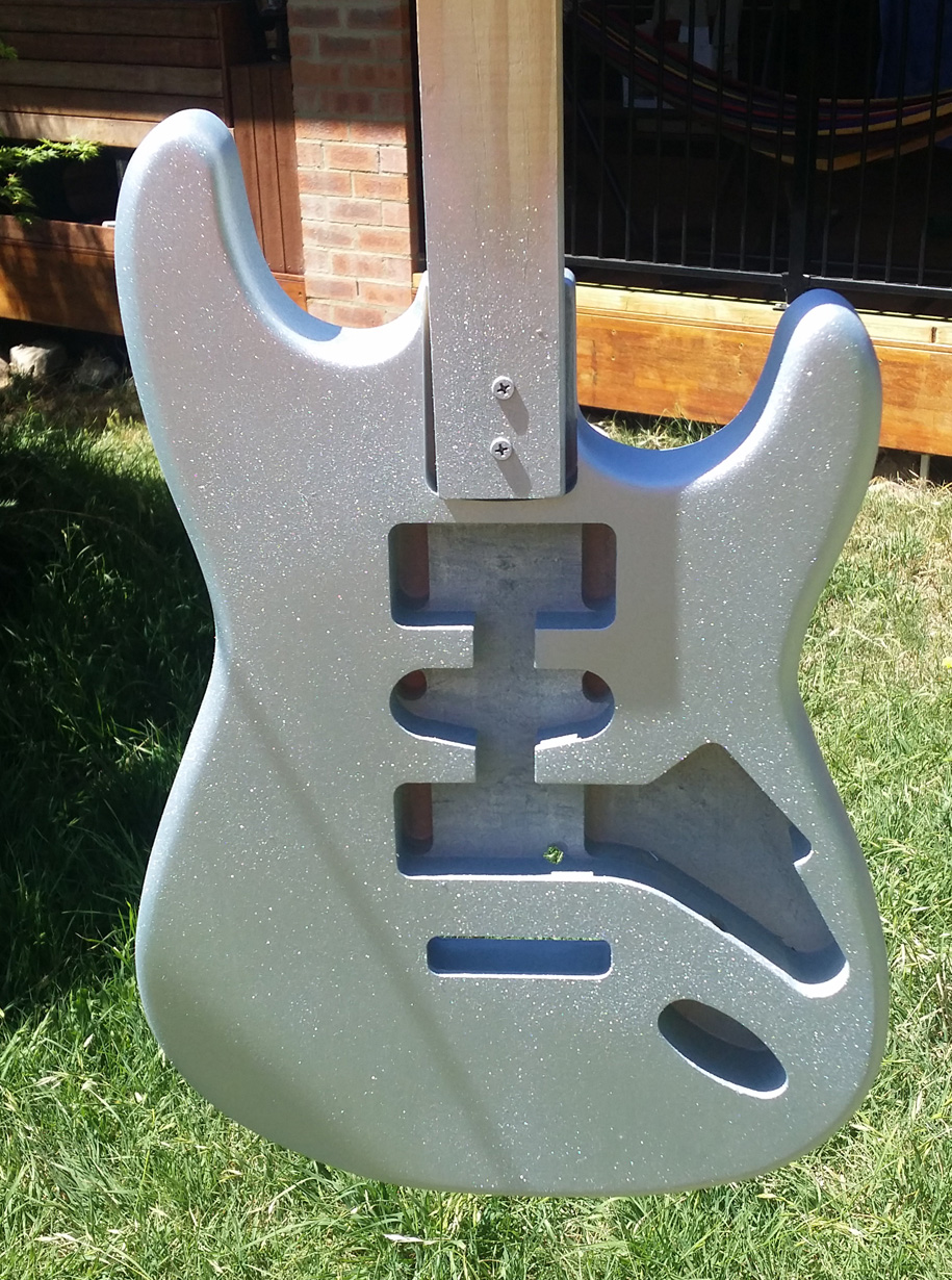

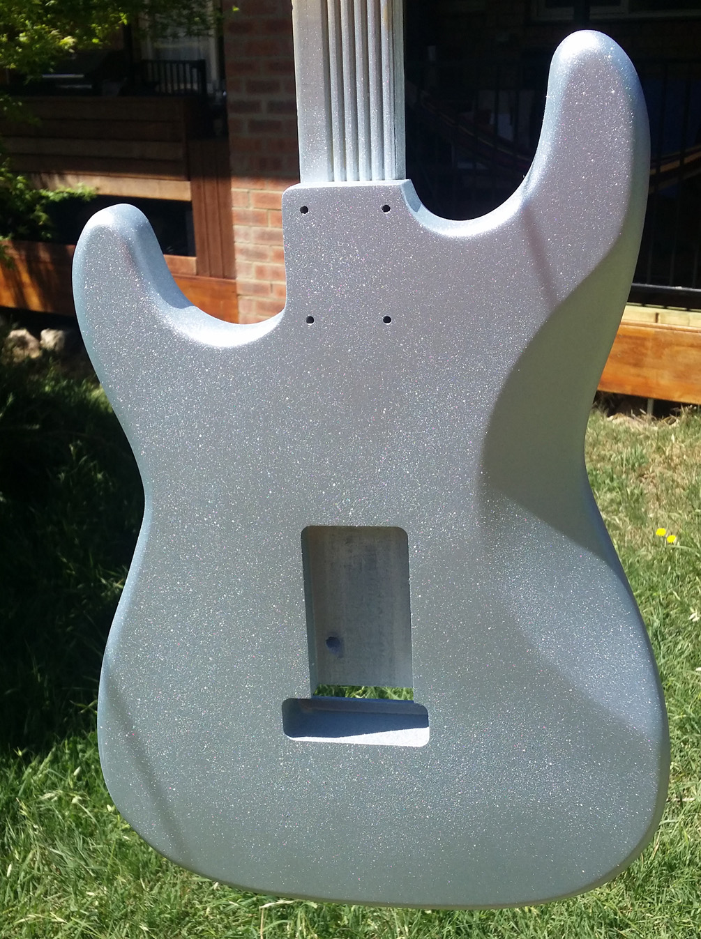

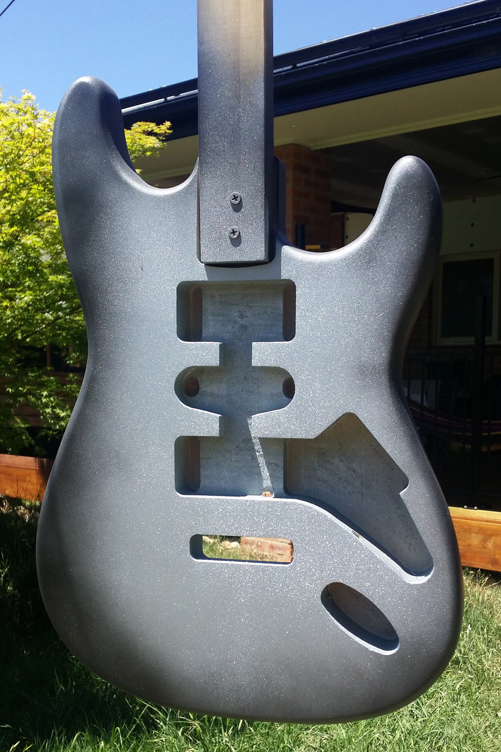

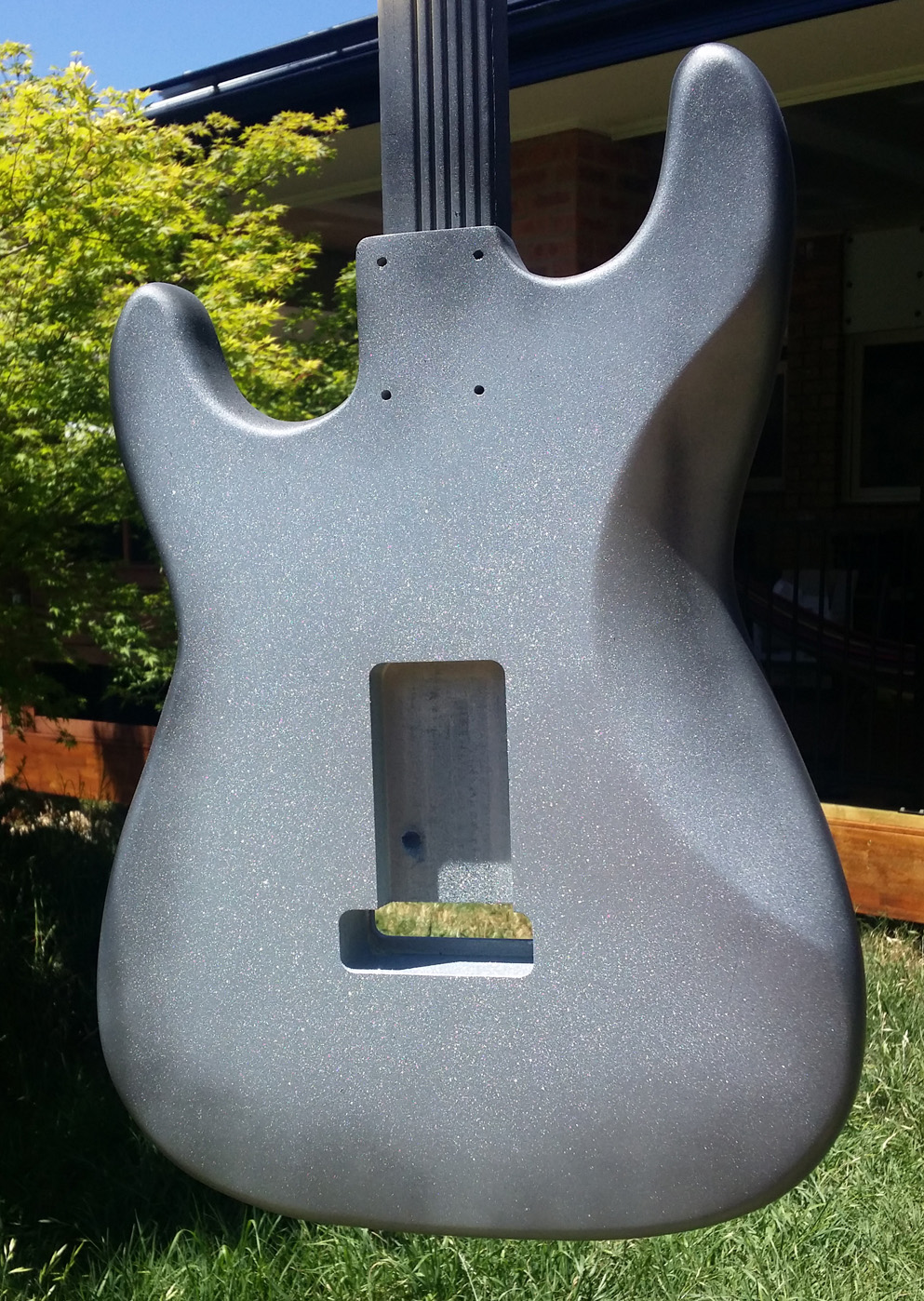

    So after a couple of weeks of raising grain, sanding, filling, sealing, priming, I sprayed a couple of layers of the sparkly silver. I'm pretty happy with the coverage - it was pretty fiddly work. The metal flecks clog the nozzle pretty frequently, so I ended up in a routine where I'd spray for 5-10 seconds, then dunk the nozzle in some metho, swirl it around, shake it off, and spray again.
ID:	15411Click image for larger version.
    At this stage, it's looking super fabulous. Blindingly glittery. If it was a present for Taylor Swift, I'd be clear coating by now, but instead, it's ready for some smoke.

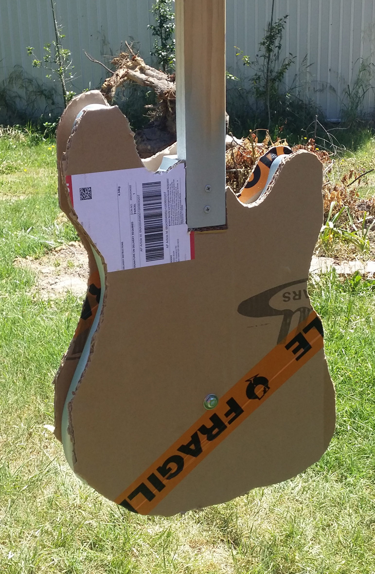

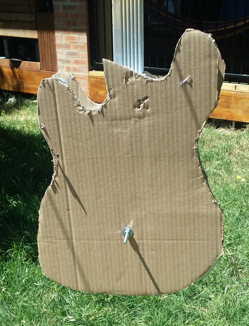

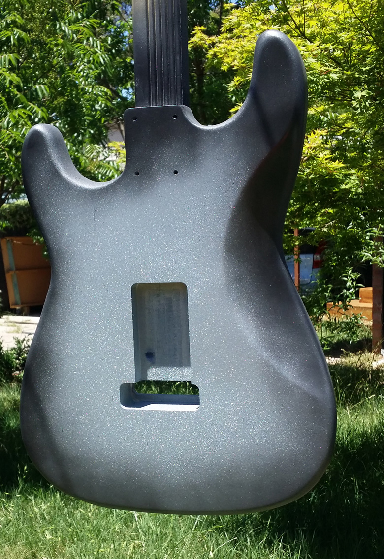

    So to make sure the edges are nice and even, I've masked off the top and bottom ready for a spray. Note the use of elegant masking materials and techniques:

    The Metalcoat says to do two light coats followed by a medium one at 10 minute intervals, so I give it a crack. it all goes really well except for a small run on the underside of the top horn. Hopefully I can smooth it off with some sanding in a week or so once it's cured.
    Looks great! My advice would be to try out your bursting technique on some scrap before attempting the real thing. It can be tricky with rattle cans and you might need to get your technique down. Other than that, a great concept and a great gift!

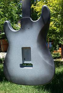

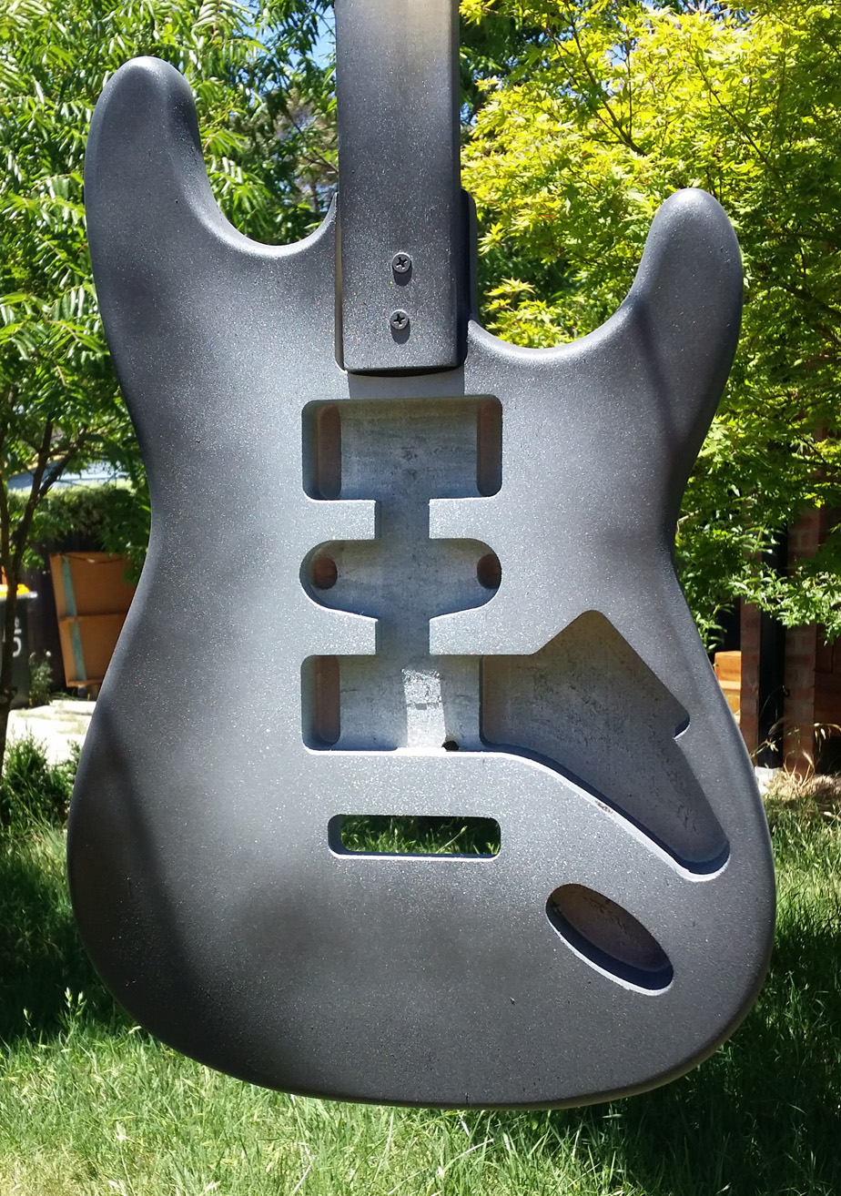

    Once I've done my 3 coats on the edges, I whip off the masking, and get cracking on the burst. I'm keen to get it all done in one session so it can cure for a week. This is the most challenging bit so far - and pretty unforgiving. I've laid it on a bit heavy in places, and run out of paint well before I thought I would:
ID:	15415Click image for larger version.
    I'm liking how the smoke texture is shaping up, but I really want to try and even up the bits where I've gone heavy. So it's off to Supercheap Auto to get another rattlecan.
    looking awesome G-Axe and welcome to the forum. You have nailed the silver. I presume the smoke paint is black ? Should look unreal with a black burst edge, take your time and have a practice burst spray and it should turn out how you want it to.

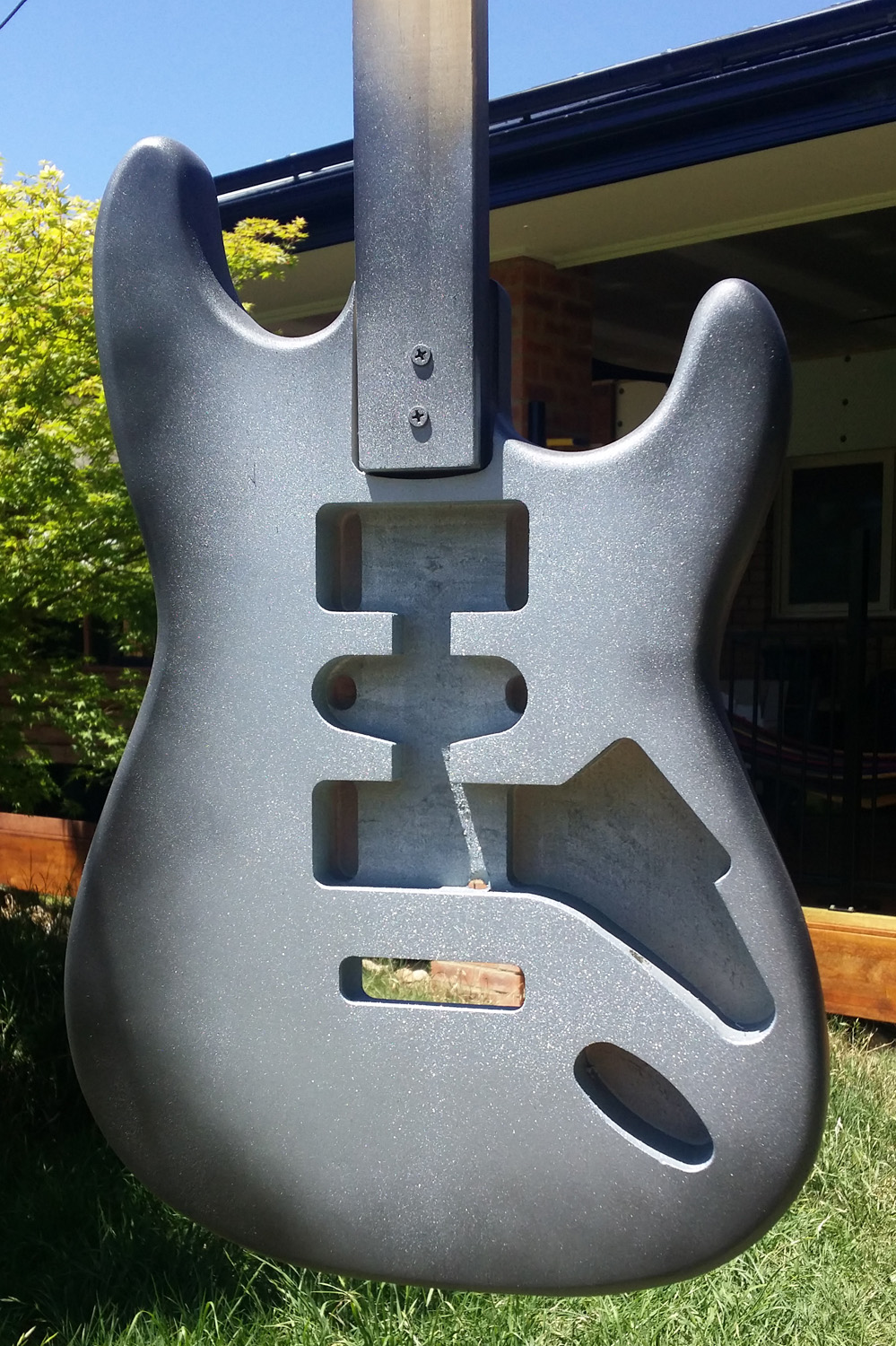

    I manage to get in and out pretty quickly - the paint reckons I should spray additional coats within an hour, or wait until after it's cured. I'm still within that window so I press on. I get the coverage a bit more even, and darken it up over all. And then as I'm hanging it up to dry, I make the mistake of trying to brush off a bit of fluff with my fingertips, and leave a couple of finger shaped streaks behind the bridge.
    With a bit of work, I manage to cover it up - but now I've overdone the bit that was going to show the most of the original silver. Once I've got the pickguard on, there will barely be any surface that isn't smoked. Not the end of the world, but not quite what I'd hoped for. Should I try sanding it back a bit? The difficulty is that the sparkle layer is pretty rough (like 180 grit sandpaper) so I'd be sanding back to an uneven surface - which probably won't work.

    Anyway - trying not to get too down on the small mistakes, from here I have to try and resist the urge to do stuff to it of the next week while it cures. At some point I'll probably drop the pickguard onto it and see how it looks - as long as there's a bit of a contrast around it, and the sparkle is still visible under the smoke, I'll be happy.
    One other thing - spraying in the great outdoors probably isn't my greatest idea - in places I'm seeing a roughness to the smoke layer that I assume is dust/pollen that's gotten into it. Given that my sparkle layer is in itself uneven, should I be stressing about levelling that stuff out with a high grit paper before I clear coat?
    Ok, that looks AWESOME.
    You nailed the "Smokey" part of the brief, how does the "Sparkle" come up in the light? it's a bit tough to see in the pics.
    You could do a gentle wet sand on the worst affected bits (1500 paper, single passes at a time rinse paper and wipe down body every pass) but you don't want to knock your smokey burst back or go through your silver. You might find that improving those rough spots might raise other issues with the rest of the finish also.
    Hi G-Axe, to me looks like you have rushed to get the 2nd smoke burst coat on. You should have had a practice run on paper or cardboard. I suggest you wait a few days for it to cure, masking tape up the smoky edges that you want to keep and spray more silver on the the unmasked areas.
    Don't worry about the rough surface, enough clear coats over it and you will be able to sand it flat once the clear has cured
    EDIT if it is windy where you are spray painting it will be very hard to get even and accurate application of the paint
