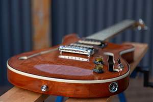

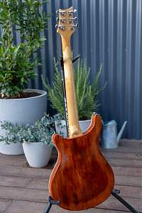

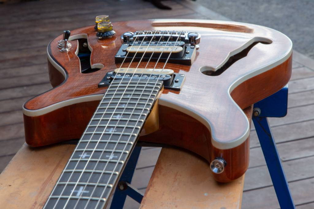

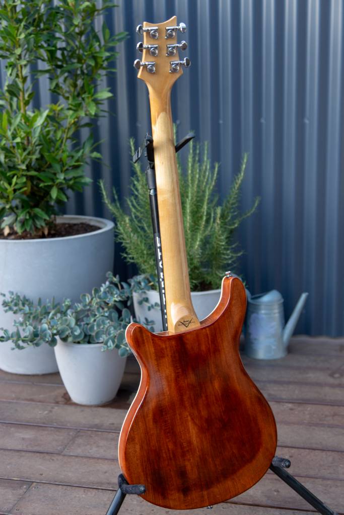

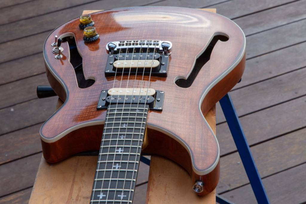

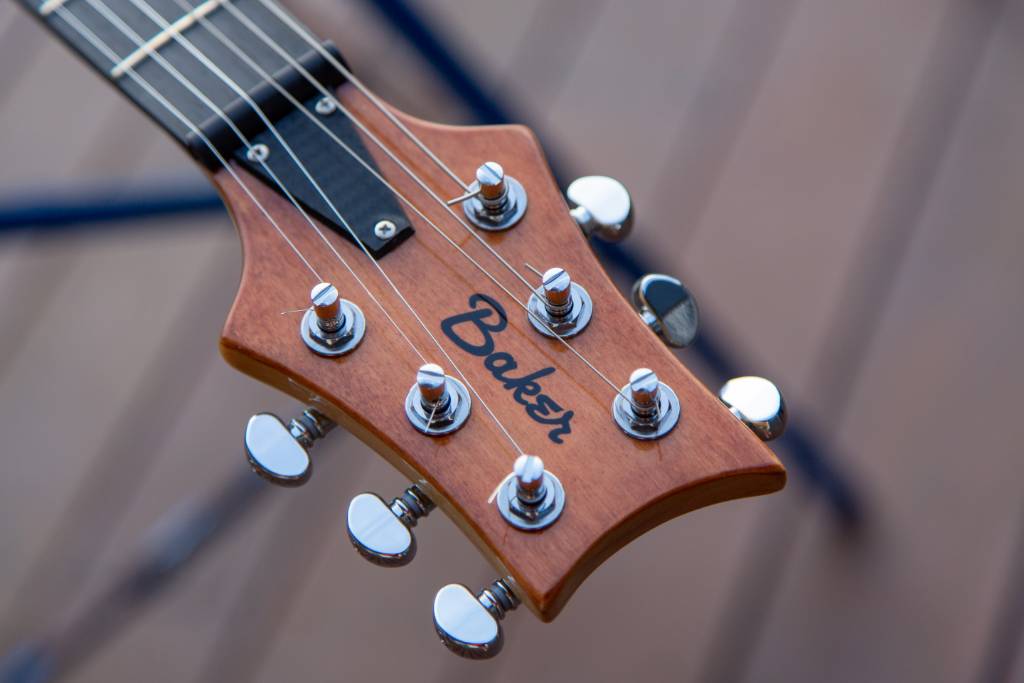

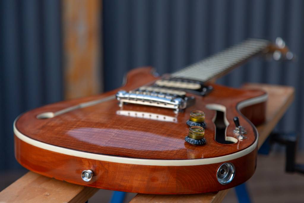

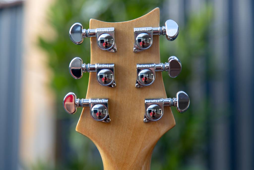

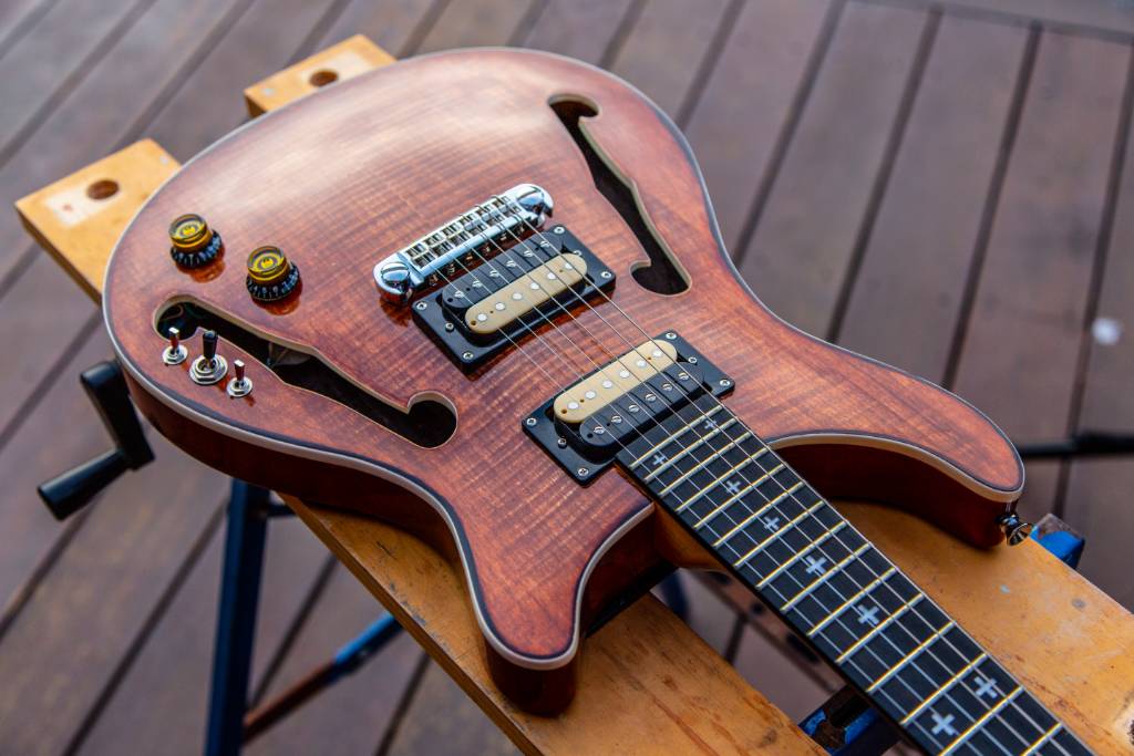

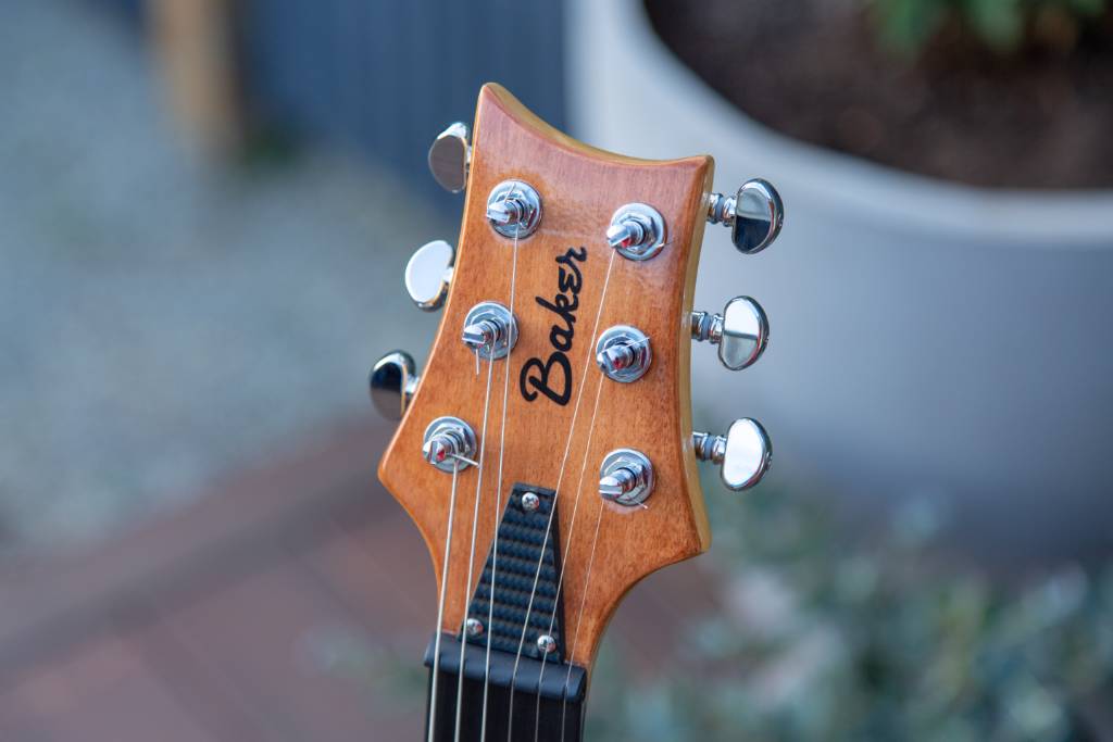

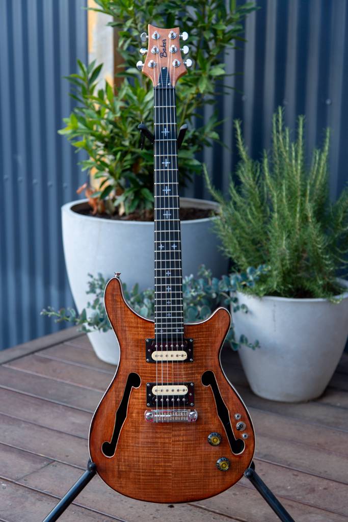

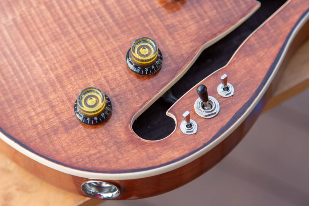

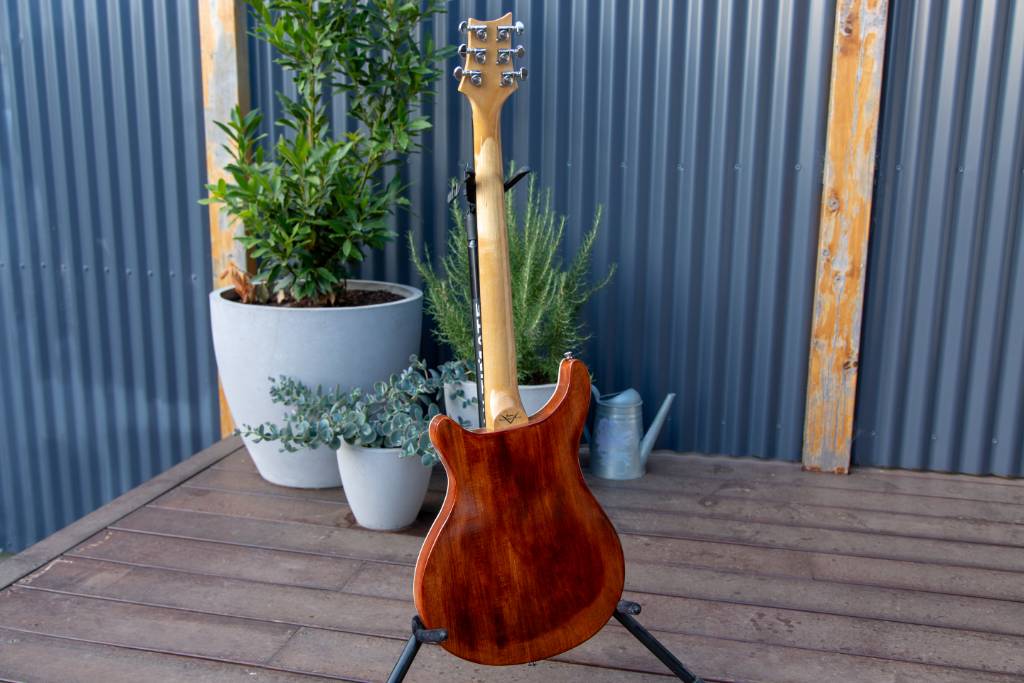

    Mark's PRS-1H Build
    Here is the list of upgrades done to this kit;
    Grover locking tuners, mini rotomatics (PBG upgrade)
    Tusq Nut (black XL 6060-00 to suit Epiphone)
    MusicLily adjustable wrap around bridge
    MusicLily Ceramic Humbuckers
    Guitar Family Recessed Jack Plate
    Switchcraft output jack
    Speed Knobs
    Electronics;
    2 x BOURNS MINI 500K AUDIO TAPER POT
    Orange Drop Cap
    PBG Treble Bleed
    2 x DPDT (on/on) switches
    3 way selector switch (standard from kit)
    Followed this wiring diagram
    (ignore reference to push/pull pots - I used the mini DPDT switches in their place)
    Finish;
    Stain and intesifier coats of DingoTone Nullabor Ochre
    The final coat didn't really take very well, so I stripped that back and went with Spray Poly (Cabbots exterior)
    Dingotone Wax on the fretboard
    That's going to be tough to beat, Great Job Mark!!
    Some more pics

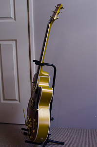

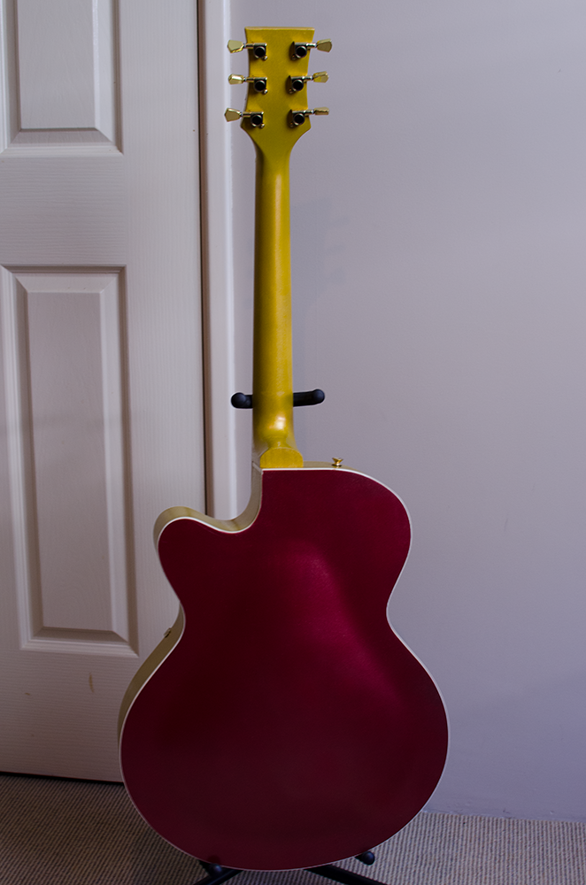

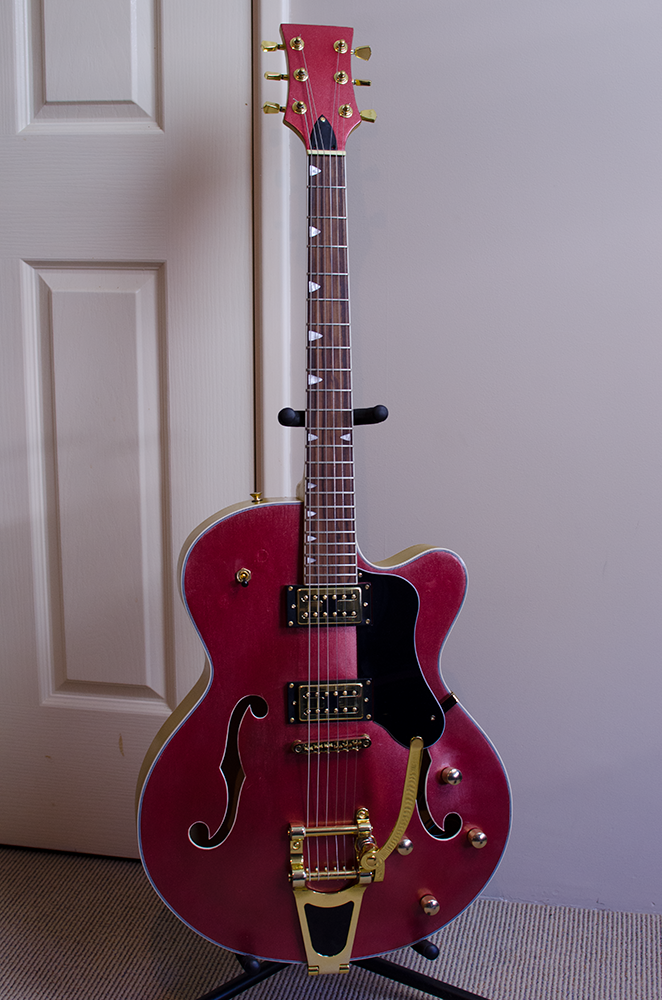

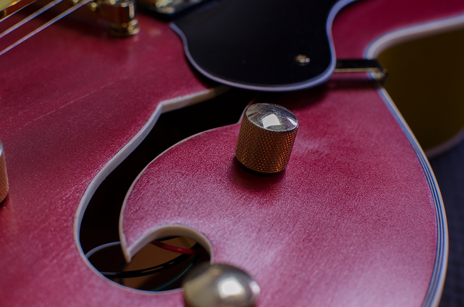

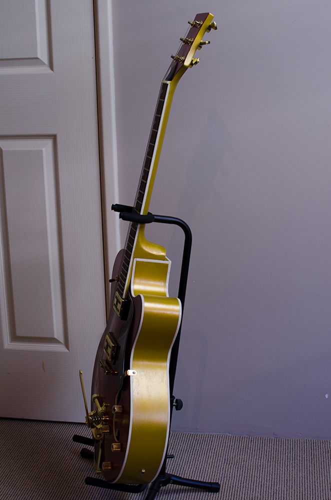

    Tony's GR-1SFG Build
    Nice work Mark your PRS-1H looks awesome.
    Thought I'd submit my first build. Took on the GR-1SFG through December and January.
    Had some challenges with the finish. Started staining it but then couldn't get a nice smooth finish with the polyurethane so went with paint instead. Not the finish I was going for but happy enough with it.
    Moved some of the control knobs around so it was more like a Gibson ES-275.
    Anyway here are some pics.
    Tony
