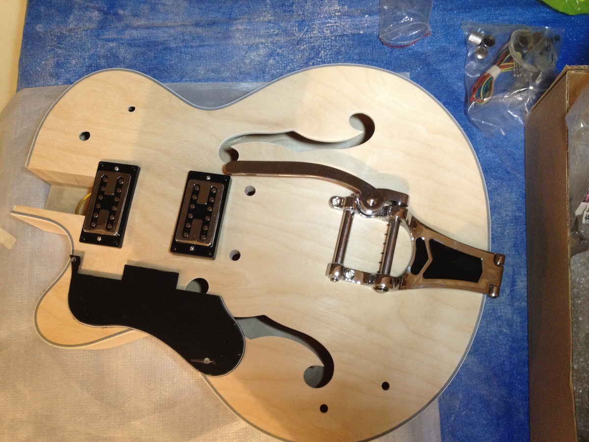

    I ordered a custom GR 1SF Lefty around June last year.
    Opened the box very excited. Then when I placed all the components together I realised the tremolo was a right hand version! Adam then found that the factory didn't have a Left hand tremolo, so he sourced a real Bigsby Lefty ( at a discount cost). Thanks Adam. But now I had my first ever build that had to live up to it's hardware. No pressure.

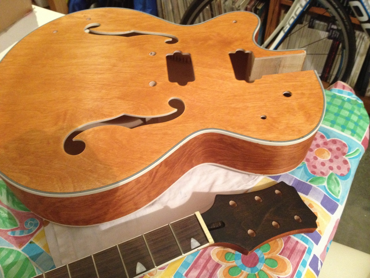

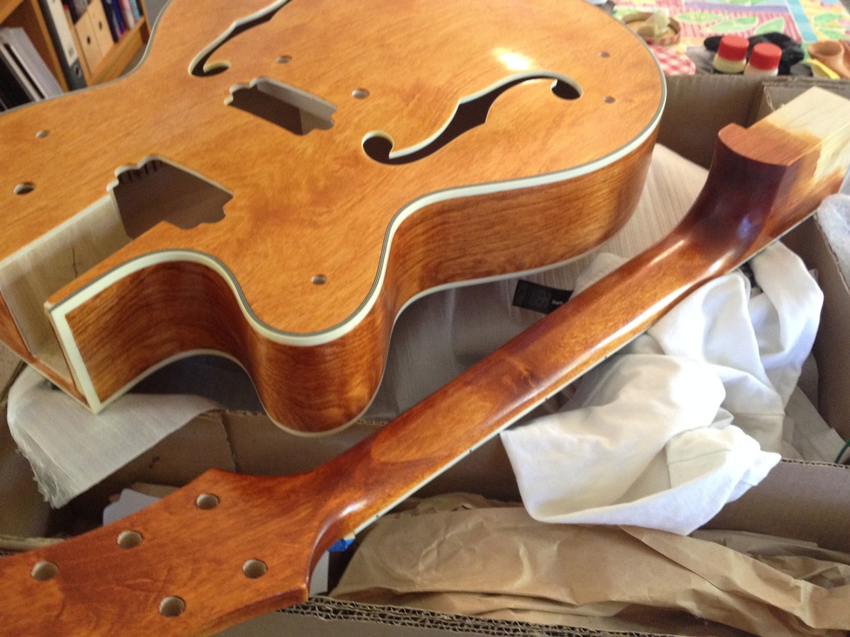

    Dingotone colours weren't all available and there weren't sample panels to see so I eventually settled on using Feast and Watson stains and Tru oil.
    I bought Prooftint stains in Maple and Golden Teak. The colours look very different on ply. So I experimented and made a colour for the top from one part of each plus one part Prooftint colour reducer. I thinned it with this because I didn't want to go too strong first off. It's a lovely warm honey colour.
    For the sides and neck I made the mix without the reducer, with a little more of the Maple.
    The Head stock face had this colour mixed with Black Japan which I had in the shed. it made A nice dark brown.
    Before application I had done all the sanding, vacuuming off the dust and masking the binding. I saw a guy online make thin strips of tape by clamping a craft blade onto a small stack of cards and turning the roll of standard tape around against it. Worked a treat and saved a lot of scaping colour off.
    Staining finished now. In the oiling with Tru oil process. 4 coats on so far. starting to look nice.

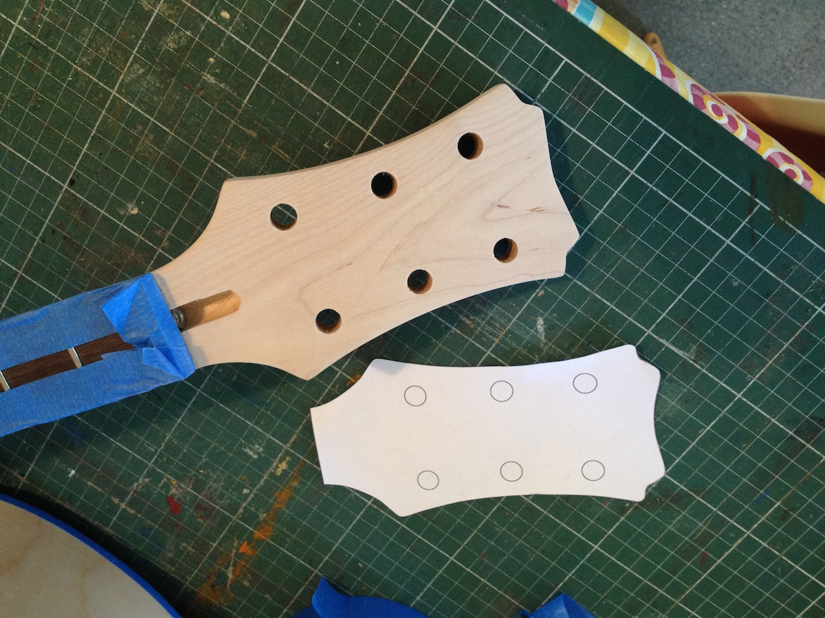

    head stock
    Looks good Paolo. One day I'll build this kit....right handed of course!
    Thanks Andy,
    I have also re shaped the head stock. didn't want to remove much wood but was happy with this.
