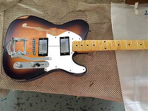

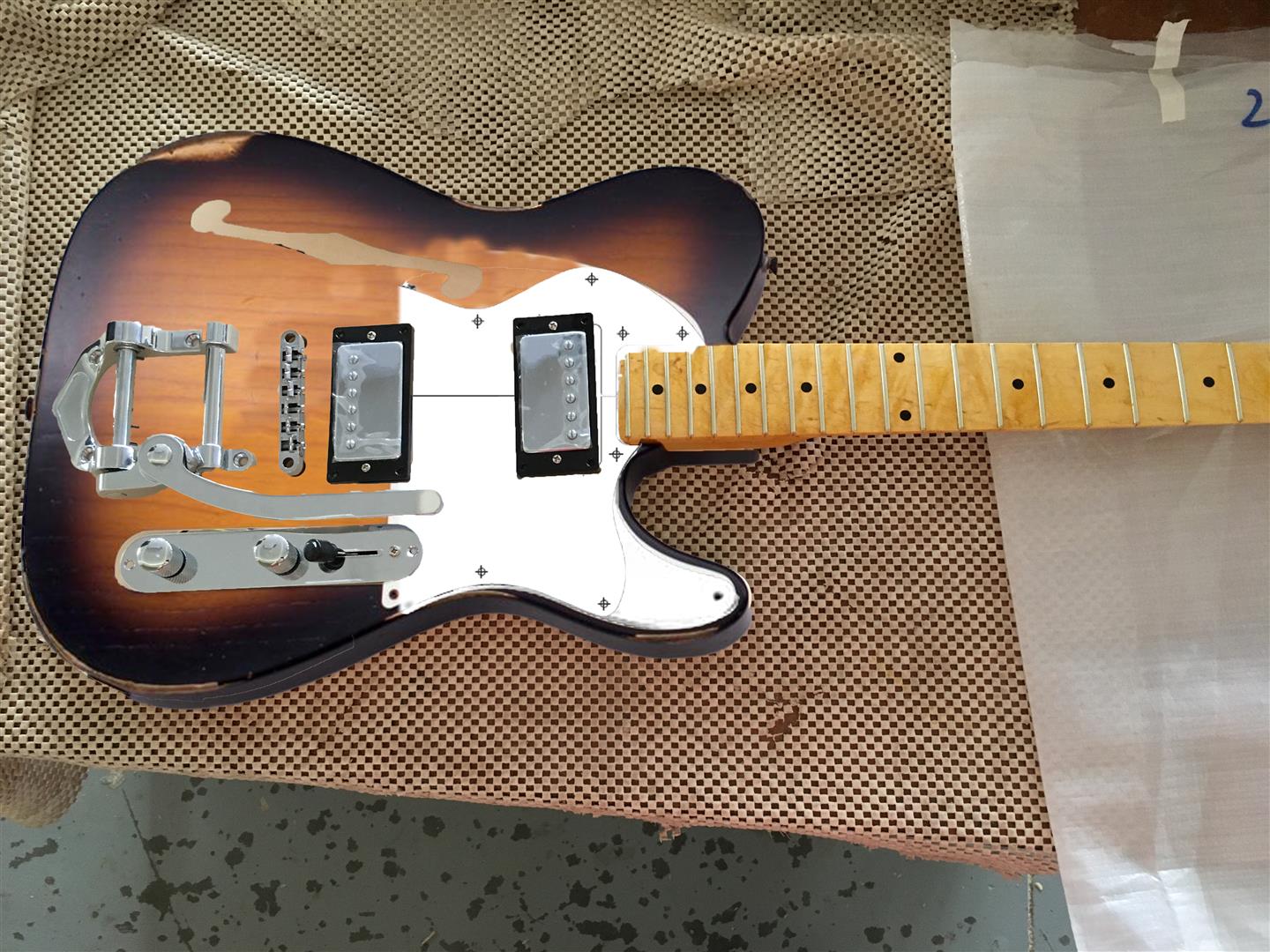

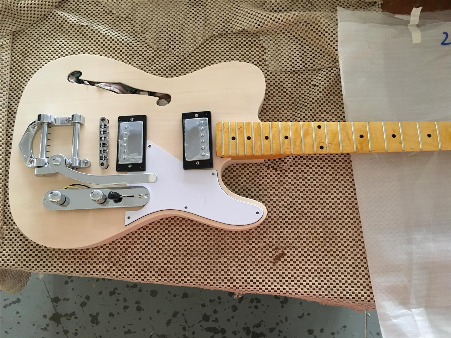

    I recently did a photoshop mock-up for a customised shape tele pick guard.
Name:	IMG_2571 (Large).JPG
Name:	body photoshop mock up (Large).jpg
    This allows me to customise a pickguard which takes into various standard tele designs.
    If you want me to do some mock ups when you design your headstock and pick guard let me know.
