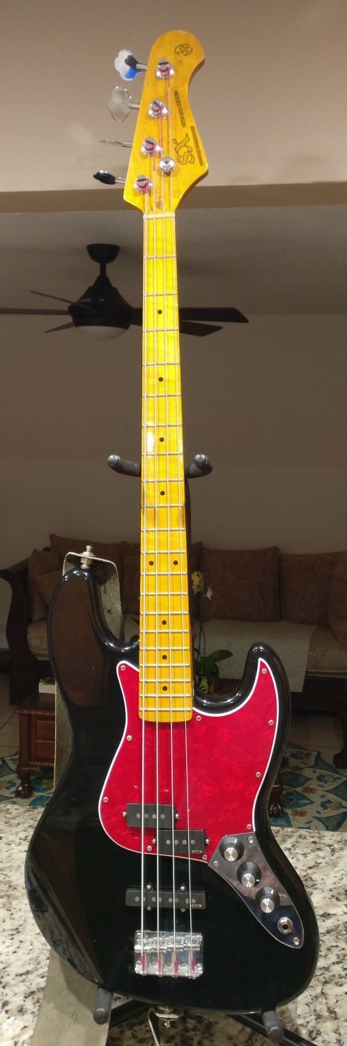

    I like both the idea of a red. Clearly you are a man of taste! I agree about not painting the other advantage to buying one is pearloid ;-)

    Welcome aboard! Look forward to seeing what you do with the build
