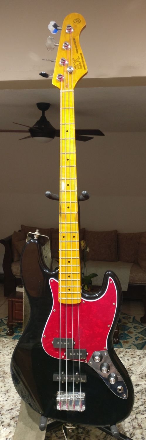

    I like both the idea of a red. Clearly you are a man of taste! I agree about not painting the other advantage to buying one is pearloid ;-)

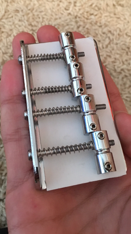

    It took a lot longer than expected to get my pickups, but now that I got them I felt confident enough to start. I did a mock build and I think the bridge sent with my kit is right handed. Also my new pickups are smaller than the originals so there is a gap between the pickup and pick guard big enough to see into the cavity. Is there any way to fix this or make it less obvious without compromising the instrument's sound?
    Here is a pic of the bridge

    That bridge is ambidextrous. You will have ago adjust the bridge pieces when you intonate the bass.

    New Pick guard perhaps or maybe PM Pablopepper to make you a custom one.
