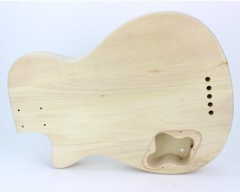

    Planing shall begin. The HBB-5 has string through body with ferrules top and bottom....nice. The photos show a rosewood, or similar, bridge....but no insert in the bridge...unless it is in one of the plastic bags.
    Question 1:-
    How do you use just a stick of rosewood as a bridge on a five string bass? All that thick string pressure concerns me.

    Big one is the Bridge for me. What do I do with this? Is timber strong enough for this application? Internet searching is required.

    Semi hollow body. Bolt on neck. Control cavity on back....less fishing electrics through the F hole required. The bridge is not a three point style used on other kits...that allegedly have a propensity to pull out from the body of the Bass guitar.
