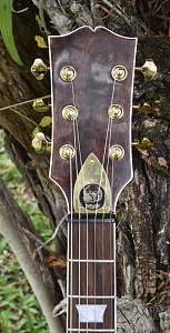

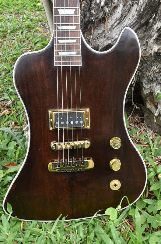

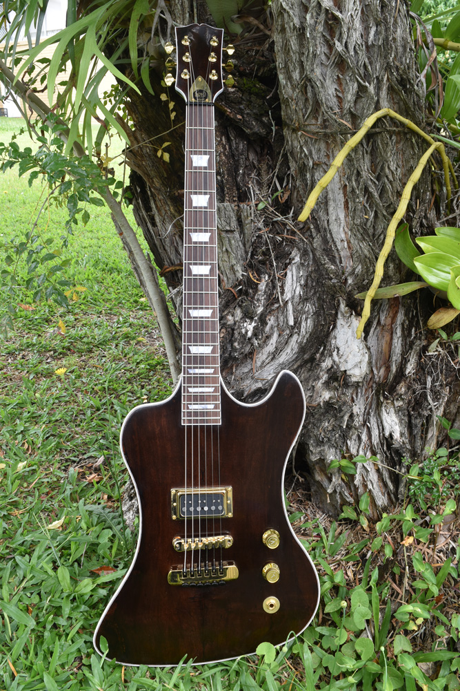

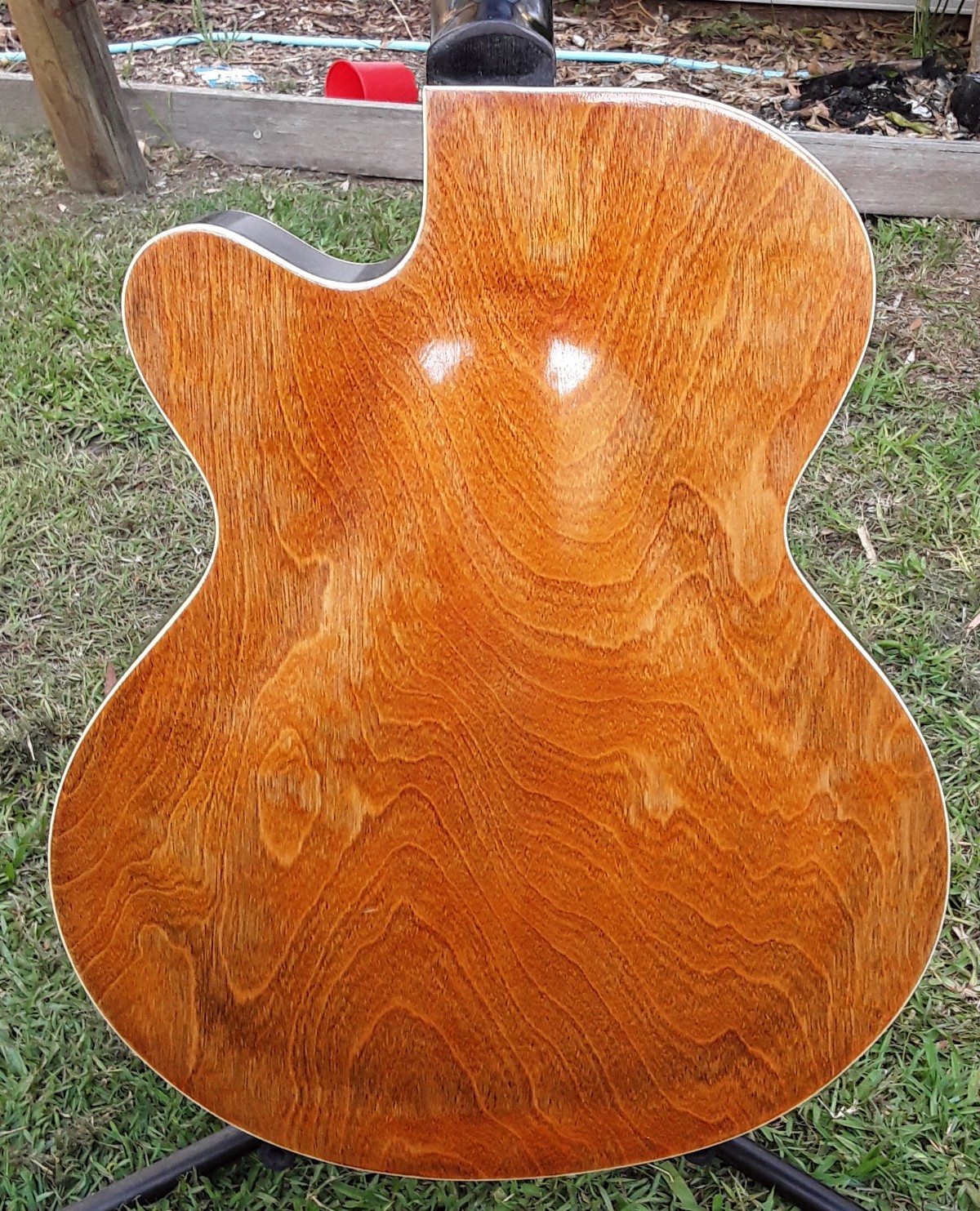

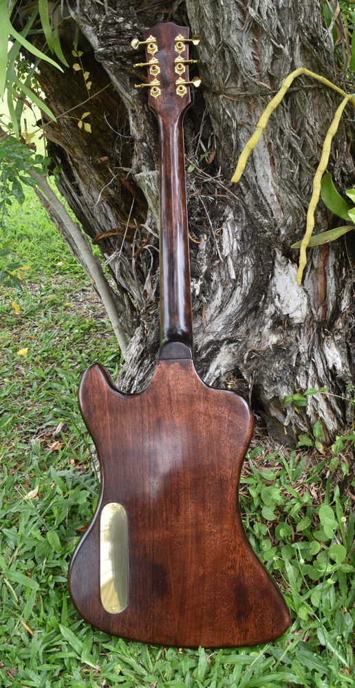

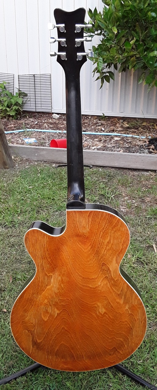

    and hot ( and humid) off the presses, finished this morning, the Bird! (it's the word ya know)
    Kustom RD ordered by someone else and the factory used the wrong veneer.
    Stained in walnut FW stain, top coated in auto acrylic clear. I didn't get it completely flat if I had more clear and it wasn't so hot and humid I may have kept going with more coats and filled the couple of deep grain divots in the top. On the back the grain is just noticeable enough to let you know its wood. Kinda suits the walnut I think.
    The kit had 2 pot holes a 3 way switch hole plus a jack socket in the edge. I filled the jack socket with a peice of meranti and moved the jack to the top. The kit came with no hardware or covers, the switch housing cavity was longer than usual so I made up a cover from brass plate and used an off cut to make the truss rod cover. Tuners are open back Wilkinsons, not exactly fine ratio but the Shcaller bridge has finer tuners. Roller bridge is a Wilkinson as well. Pick up is a GFS Dearmond Dynasonic style single coil. It sounds like a cross between a P90 and a Fender Jazzmaster. I used 250K CTS pots a gold Switchcraft jack socket and a .022 Vitamin "T" capacitor as there was heaps of room in the cavity. Gold knobs from Ebay :P I was amazed to find the intonation required very very little adjustment, it's now strung with 10 to 46 Slinky's.

  5. Liked by: Grubsta, Swanny
    Nice one, the brass looks great on the walnut colour.
    well done Deddy you are pumping out the axes ! Nice colour and hardware go well. Looks like another tough month to judge already !
    Is the TRC and control cover brass ?
    yes Wokka 2mm plate brass.

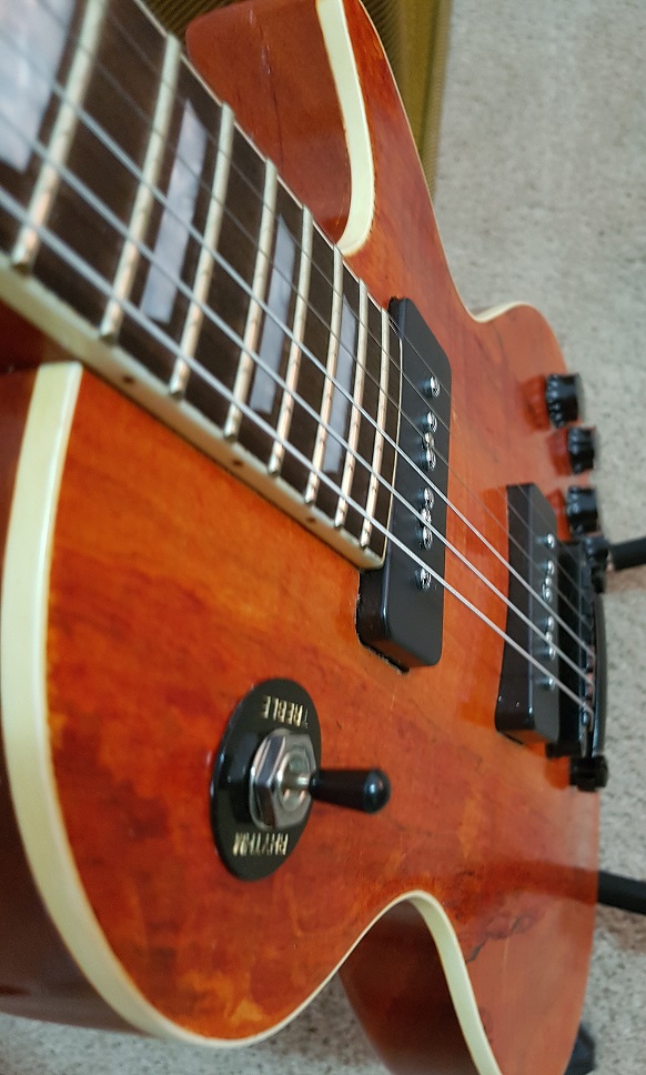

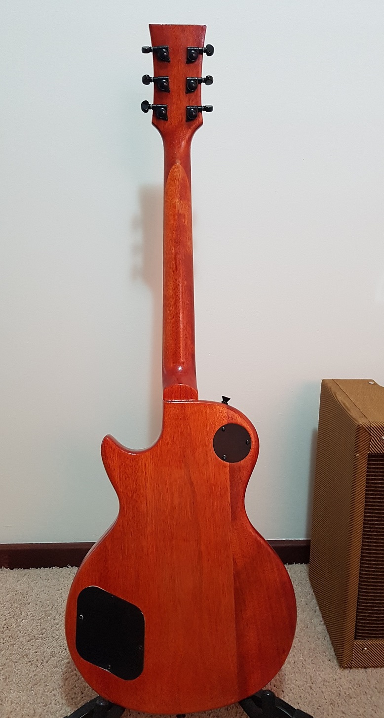

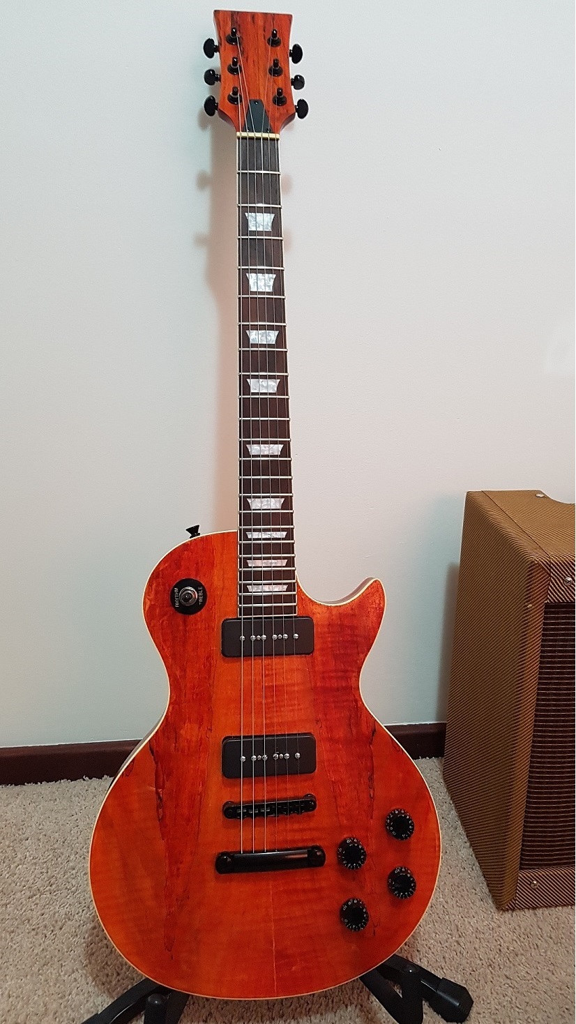

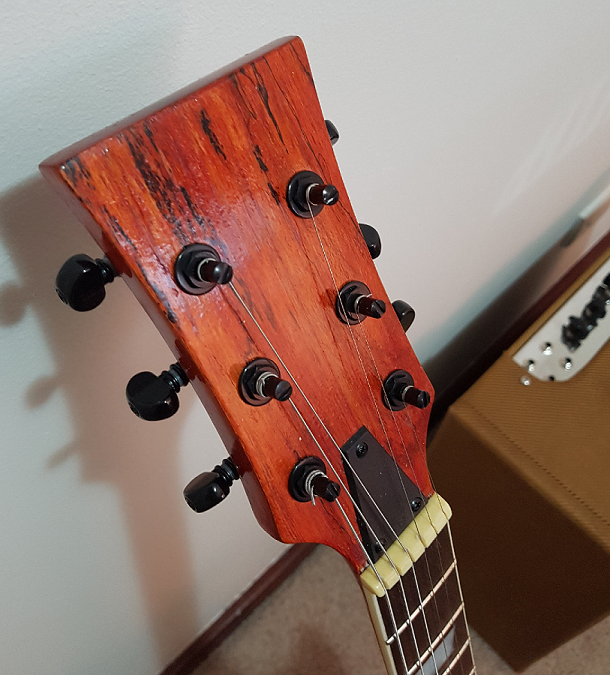

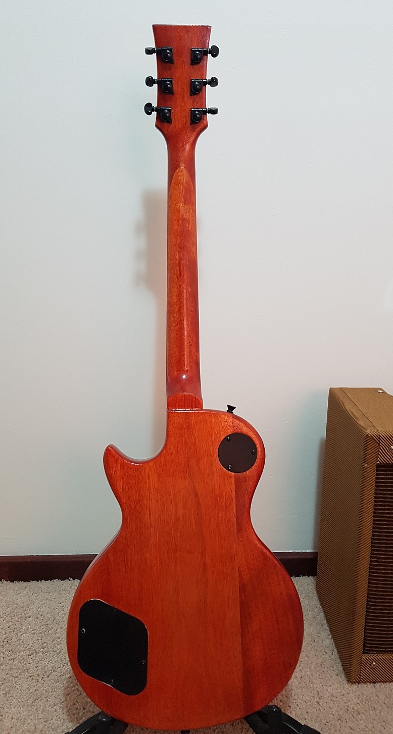

    Hi all.
    Playing my LP-1SSP now. Sounds great
    Finished in Dingotone Outback Sunset, only upgrade was to Grover tuners. All cavities Copper lined. Finish is not perfect but I suspect the weather may be playing around with the top coat a bit. I will give it another going over in a month or so.

  10. Liked by: Grubsta, Swanny
  11. #9
    looks great Buzzard but no headstock shaping ? Doesn't take much effort to put you own shape on the top of the headstock
  12. #10
    Thanks,
    To be honest, I just didn't have the heart to chew up the spalting.
    Others I have built, I have shaped the head. I've even got an oscillating drum sander to do it with
    I just didn't mind the stock shape.
