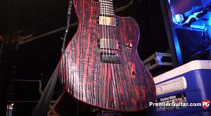

    I've been thinking about this build for quite a while now. What I really wanted to achieve was something along the lines of the Jim Root sandblasted jazzmaster. Love that look.

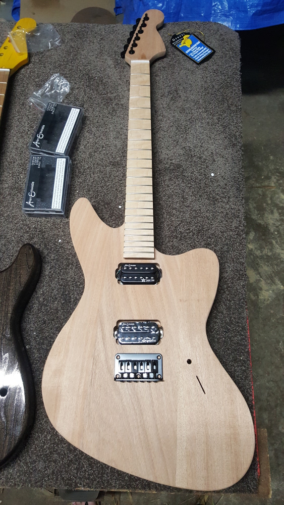

    Anyway, I ordered a custom jazzmaster kit from Ads in mahogany and it arrived recently. Both the body and neck are mahogany (3 piece body) with a maple fretboard. It's not 100% what I expected - I would have preferred a maple neck and a dark fretboard, but I'm very happy with it nonetheless. I've got a feeling that mahogany necks are just kinda the standard for mahogany bodies. Anyway, with a darker body the maple fretboard is going to look great.

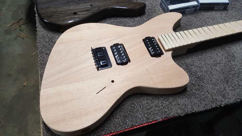

    I ordered black hardware, some grover lockable tuners, and some Entwistle dark stars. Should play and sound killer with any luck.

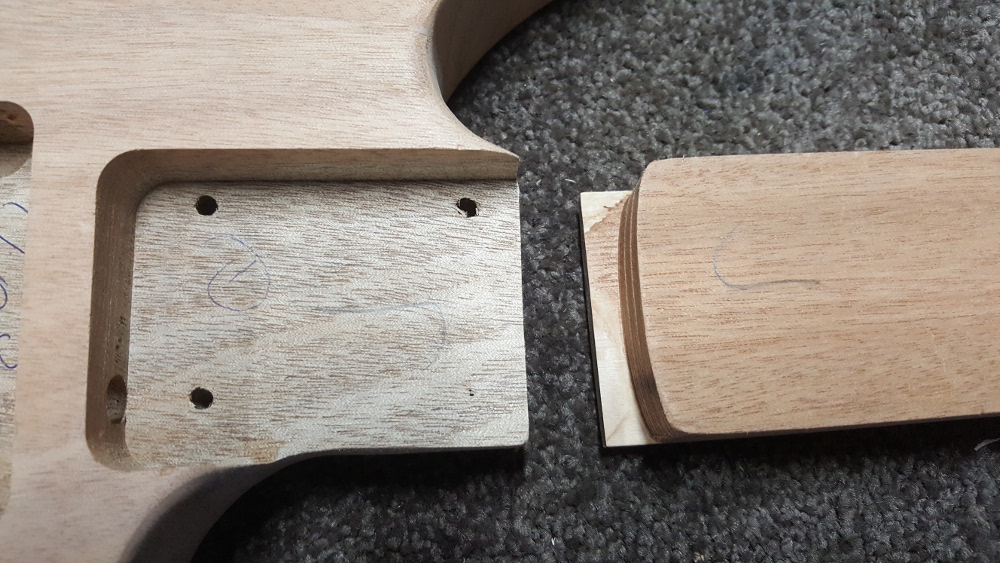

    The only issue with the kit is the heel of the neck, which is rounded and doesn't fit the squared off neck pocket. I think I'll try to square it off with the belt sander prior to installing it.

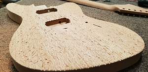

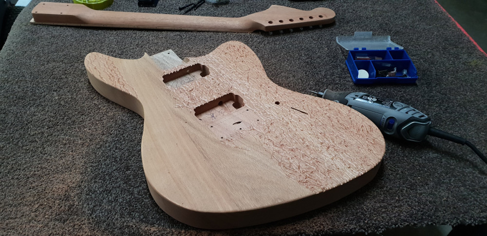

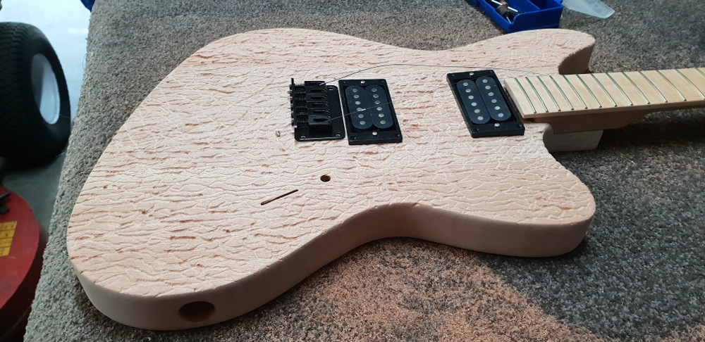

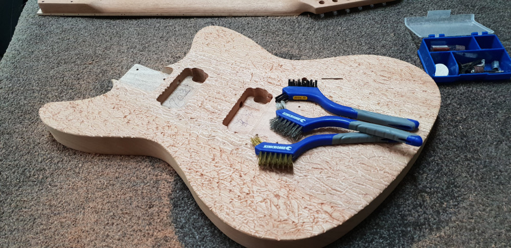

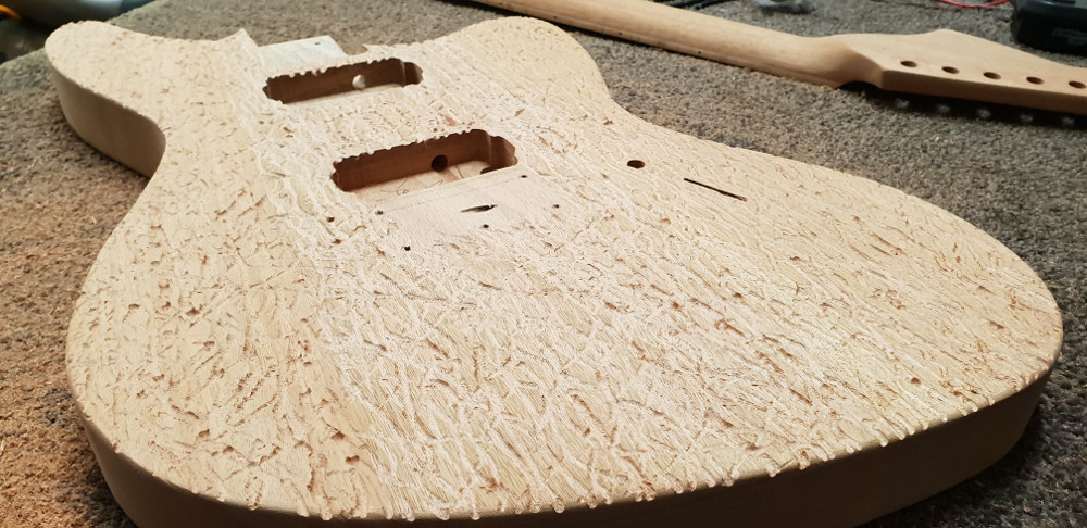

    I got back to this build today for an hour or two. I attacked the surface with my dremel and some wire brushes. It's starting to look ok. Maybe. I might need yet more. I thought I'd give it a little time to see what I thought. The idea is to fill the mess of grooves with black timbermate and stain the rest deep crimson.

    I don't have much time to build at the moment, but it was really nice to smell sawdust in my nose again! I'm hoping I can find time to continue with this one over the next month. Fingers crossed!

    Good to see you back, Gav - and good to see another creative finish underway. Look like Freddy Krueger has been into it, using a mirror as reference. Very keen to see how it shapes up with some staining and filling.

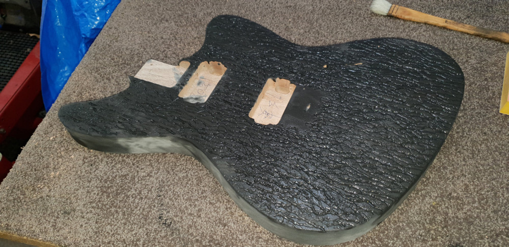

    Thanks guys, it's good to be back that's for sure. Tough love indeed Frankie! It was almost a shame to spoil all that beautiful mahogany. Nah! G-man I never thought about the Freddie likeness - but it's all I can imagine now !!

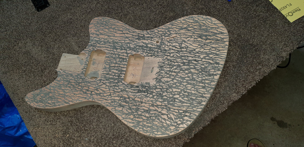

    I've filled what I've got with timbermate, so once that dries I can really see what the pattern is going to look like.
