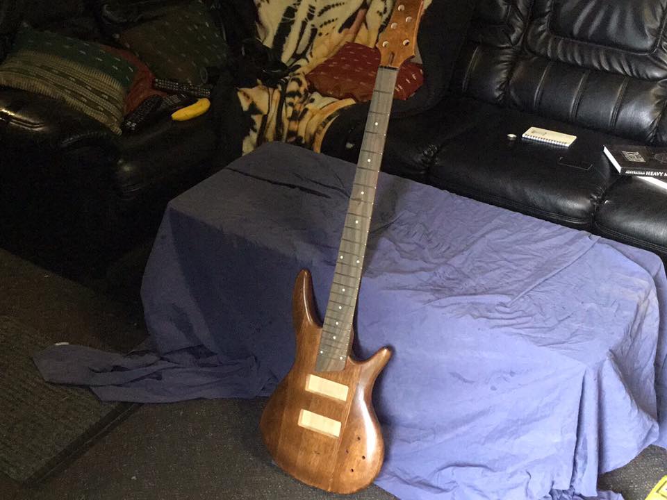

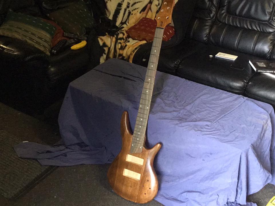

    Love it Overlander. Building my first IB5 also. Went with oak stain and 6 coats of satin poly. Should have mounted the bridge pryor to staining, but over exuberance got the better of me. The pup cavities will be black to mask any bare timber.
