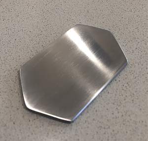

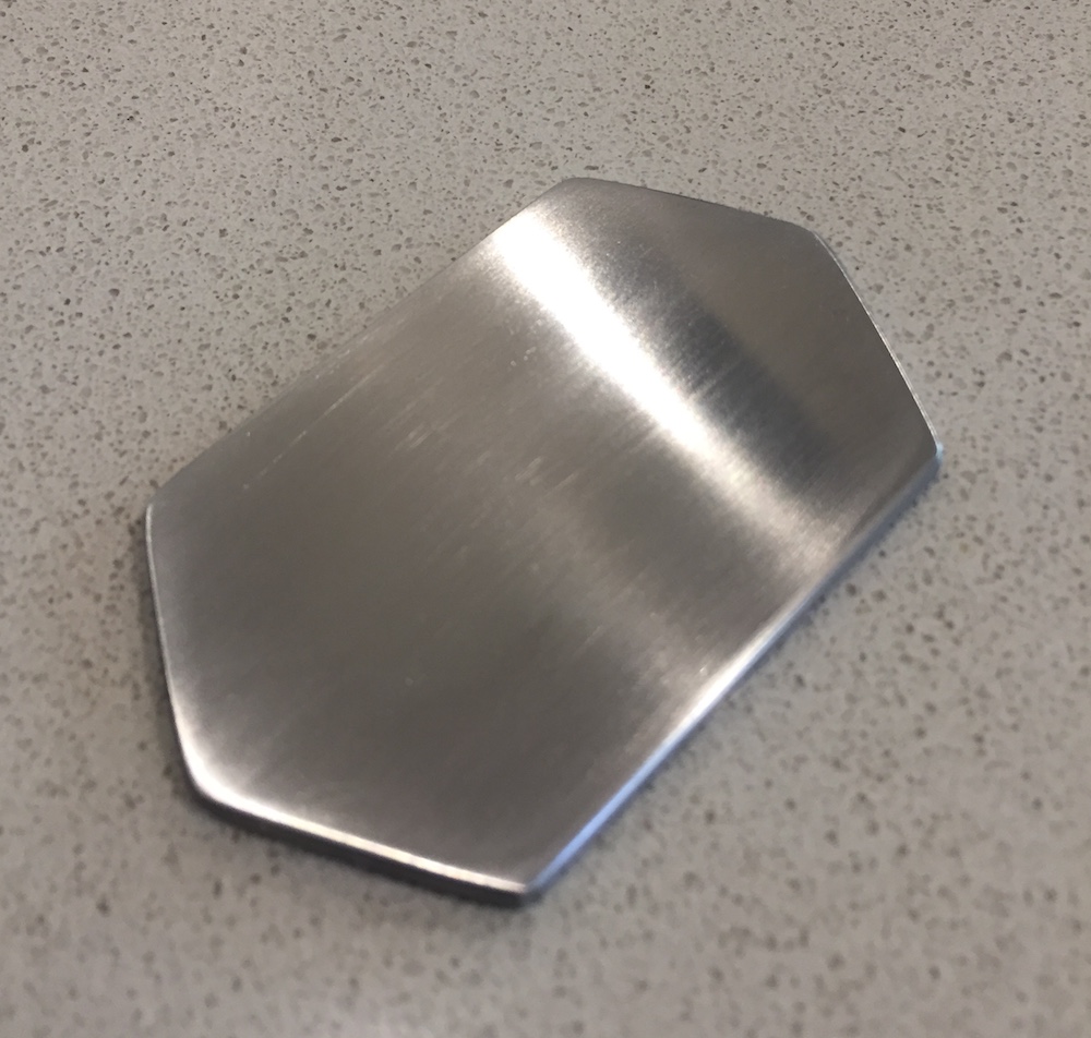

    Because I'm an impatient sod I just knocked this up from a piece of 2mm thick aluminium I had in the workshop. This is just with 600/800/1200 wet and dry sanding and a quick polish. There's potential here me thinks as I did this pretty quickly. A bit more time on the sanding and polishing, and then sealing as you suggest Dave and it could look okay. Now cutting the slot for a 5-way switch? THAT could be interesting!!

    Sorry, that's 3mm aluminium. The only frustrating thing is the largest size I can get from the Green Shed is 50mm wide. Fine for a switch or telecaster control plate, but you'd need closer to 70mm for the plates used on a Jaguar (which is what I'm essentially looking at). I guess there must be more specific suppliers where I could get larger dimensions, but hopefully without needing to order metres of the stuff.
