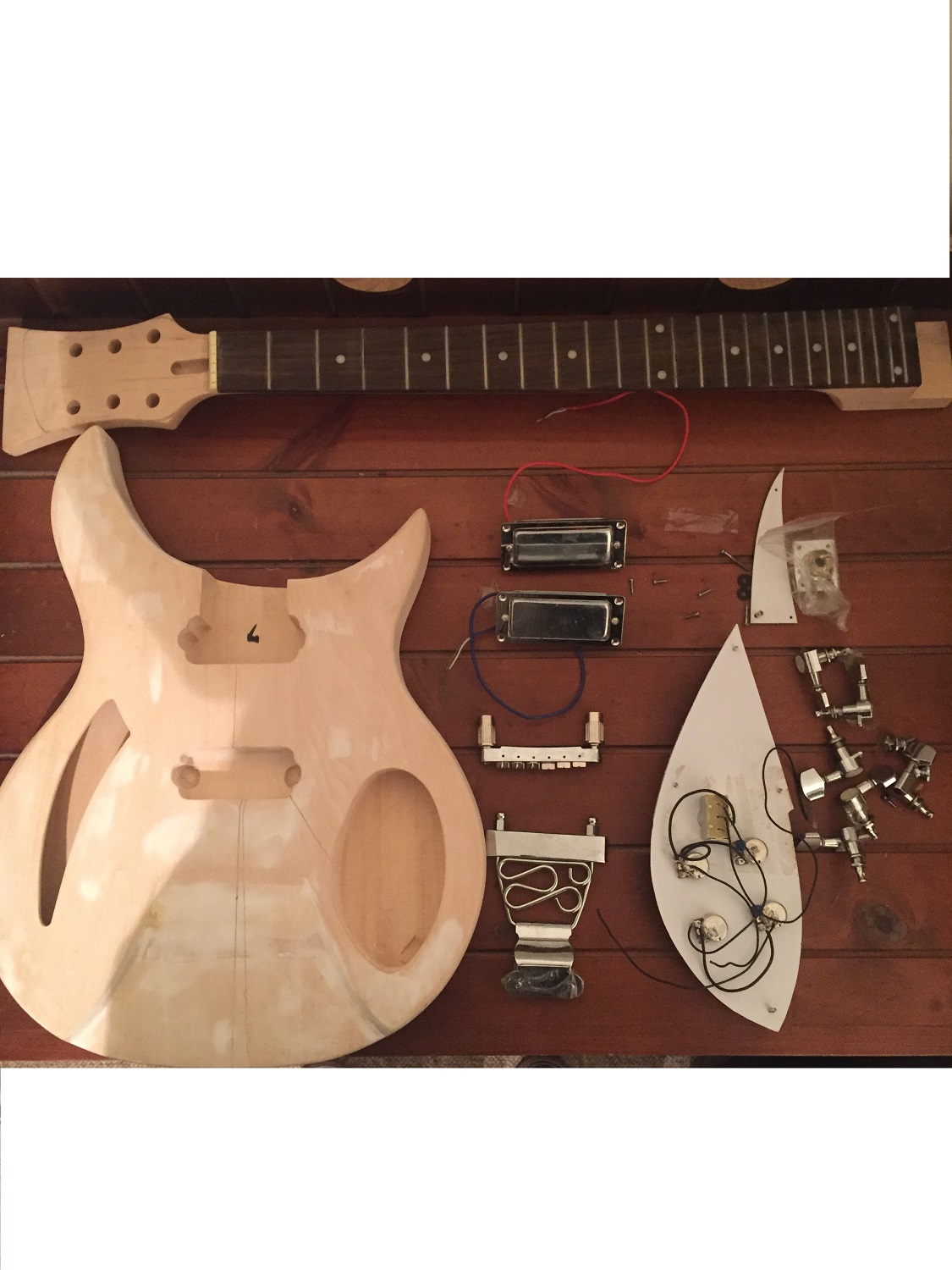

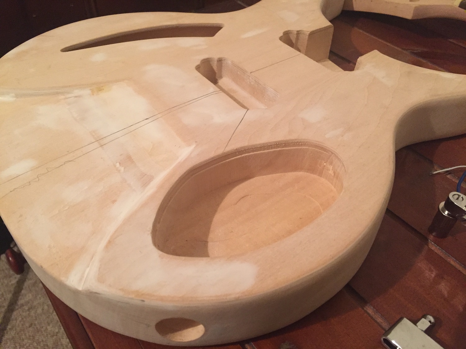

    Here are a couple of pics
ID:	19371Click image for larger version.
    nice prep Matt. So is that timbermate you have filled the grain and is the next step primer coats ?
    Make sure you sand off all the lumps/bumps in the grain filler and you will end up with a smooth finish

    Hi Wokka,
    That's all Dads work so far. I guess my next step will be drilling the holes for the bridge and wiring, then sanding and priming. I'm not overly confident working with tools (lets just say I'm not a natural) but at the same time I know that I am able to do pretty much anything I put my mind to.
    There will be so many firsts for me in this quest - eg, using a soldering iron, following wiring schematics. I really wish I had asked Dad how to do this stuff but I guess he will be with me laughing as I burn myself with solder and encouraging me to keep going.
    I think I've figured out the scale length (thanks Brendan) so I'll be able to position the bridge correctly.
