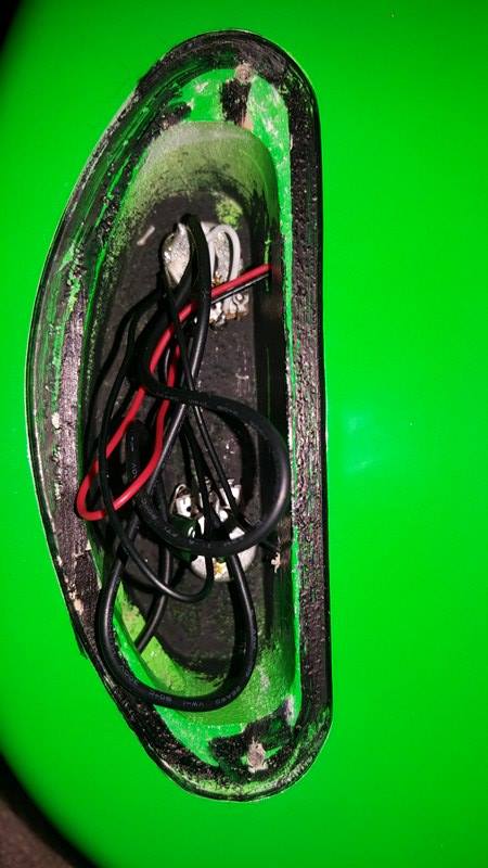

    I just purchased this bass with a P style passives on Ebay and it sounds terrible. Gotta crank the amp to hear it, no bass, all treble and heaps of amp noise. Not even the tuner is picking up the strings to tune it. So its either the pick ups or the tone pot with the cap. This bass is supposed to have 1 volume and 1 tone, but the tone pot cuts out the volume instead ! So i reckon thats my problem. I wanna replace the pot and cap and replace it with my own combination of A500K pot and .33 cap.
    Post some photos of the current wiring and we may be able to spot the issue(s). It sounds more like mis-wiring than just a tone pot problem, but it could be a couple of things.
    Yes, sounds very much like a wiring problem or a faulty pickup. If there's hardly any output from the pickup, then the tone control will knock off most of the mid and treble from it, and it will certainly reduce the volume to almost nothing.

    Here are the pics WeirdBits and Simon. Thank you for your help so far, much appreciated.

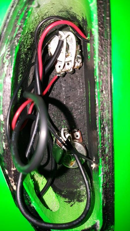

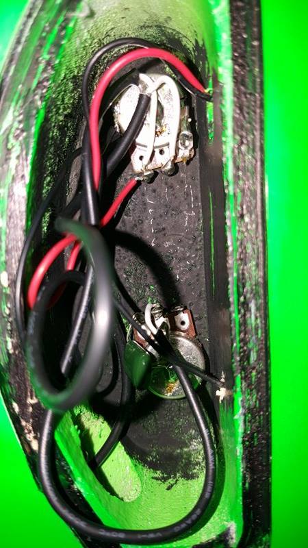

    Is it possible to take another picture (maybe more from the side) with the wiring moved so that it's easier to follow what's connected to what? With several black cables sitting on top of one another, it's not easy to follow the wiring with 100% confidence.
    Also, if you can take a photo of the wiring on to the jack socket, that would be helpful.
    Cheers.
    I finally fixed the problem Simon. It was the pick ups that were faulty. I first replaced the cap, but that did not fix the problem, so i changed the pot, still not fixed, so i replaced the pick ups with a spare i had and now the bass plays beautifully. I replaced the original pot and cap, and still works fine. I wanted to know the exact problem, wasnt sure if it was the pot or / and cap or / and pick up. so it was just a faulty pick up. So i learnt a lot from this experience, helped me to finally study on different pots and caps. But i am confused...How can the pick ups still work thru the volume pot but not the tone pot ? Pick ups still gave sound, even though they were faulty ???
