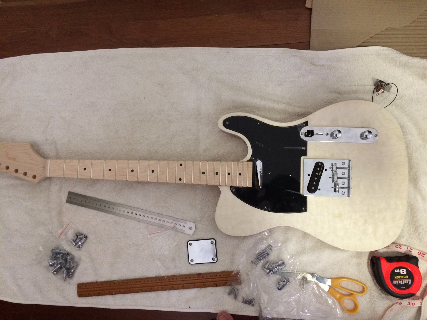

    Ok so initial inspection is complete:
    The neck fits snugly with some fantastic grain on the maple, really glad I'm planning on a clear finish.
    The Fender electronics I got fit in the selector plate which is good.
    All the parts and screws look to be here.
    The issue I have found is that the Fender pickups I have are too wide for the pickguard hole (not that big a problem) and the bridge plate hole (this is a bigger issue).
    So I guess the question is.. do I modify the bridge plate or do I buy an aftermarket bridge plate? I'm thinking the angle I'd have to use to get the strings under the pickup magnets would be more angled then the cutout on the existing one or is this not really an issue?
    Also the cavity doesn't exactly fit the bridge pickup so I guess I just take some wood off equally in either direction. Maybe I should resolve the issue with the bridge plate first...

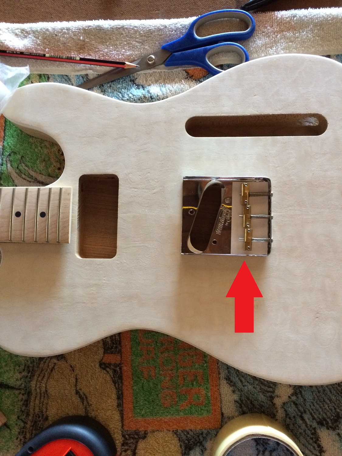

    Ok so finally got the chance to set up a work area. I've measured from inside of the nut to the middle of the 12th fret, the distance is 323mm so I guess that means the scale length is 646mm. The 646mm mark is where the red arrow is in the picture. So how is the placement of the bridge plate? I've installed two machine heads (both E strings) to look at the horizontal alignment of the bridge plate and I found the mini-grover machine heads are a bit loose in the pre-drilled holes. Is this an issue? I guess my next step is to drill the bridge plate screw holes, put the bridge plate on and then look at the neck alignment and string height from the neck? Is there a set way to measure the vertical alignment of the bridge plate, for instance can you measure off from the center of the bridge pickup route or the neck route?

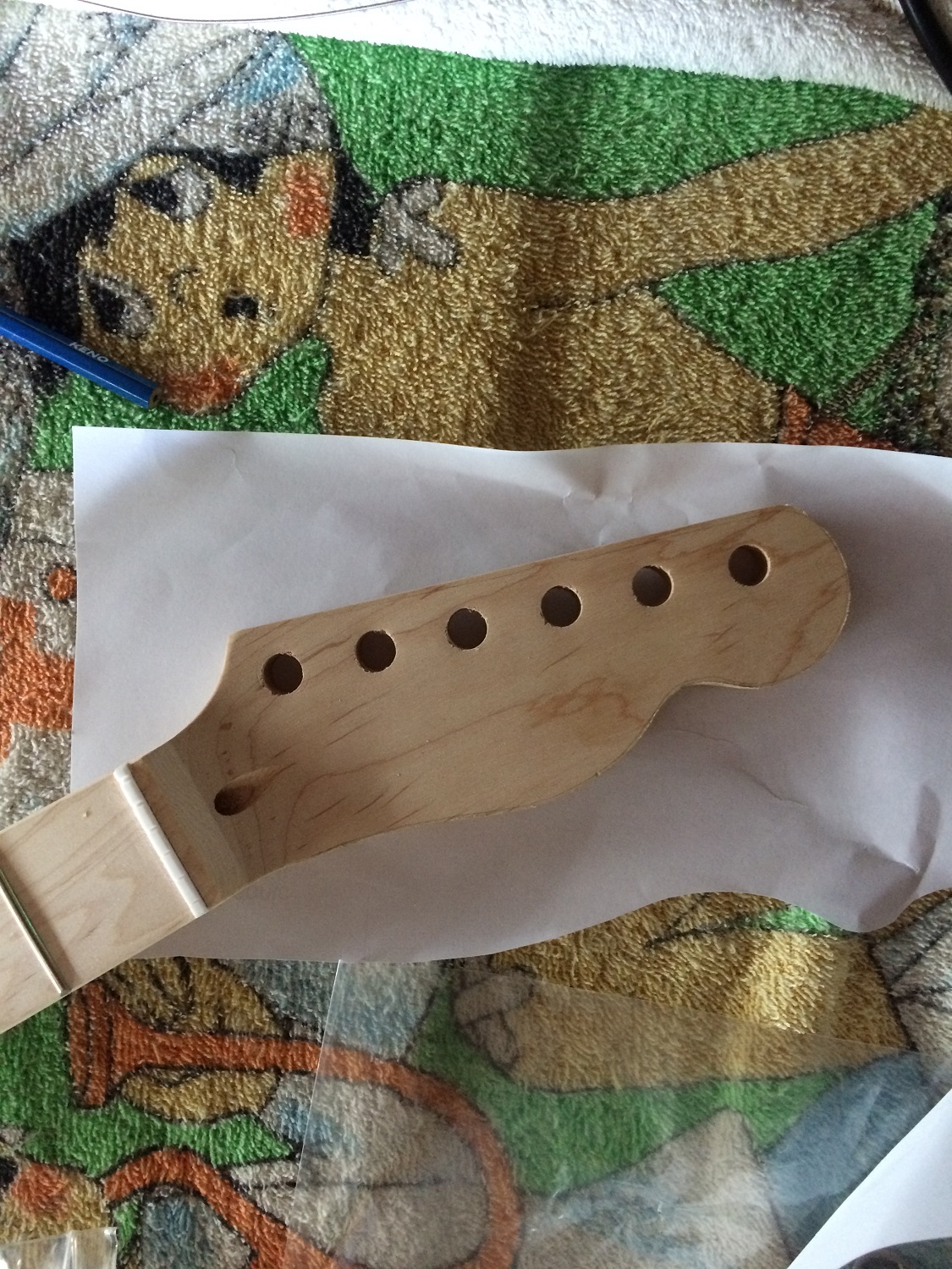

    Headstock shaping
    Ok so I've used a coping saw to shape the headstock then used a rough and fine wood file, I went for a 'telecaster' shape. The wood file was a bit old and had a bit of oil on it somehow but I'm sanding back so I figured this would be ok.Click image for larger version.

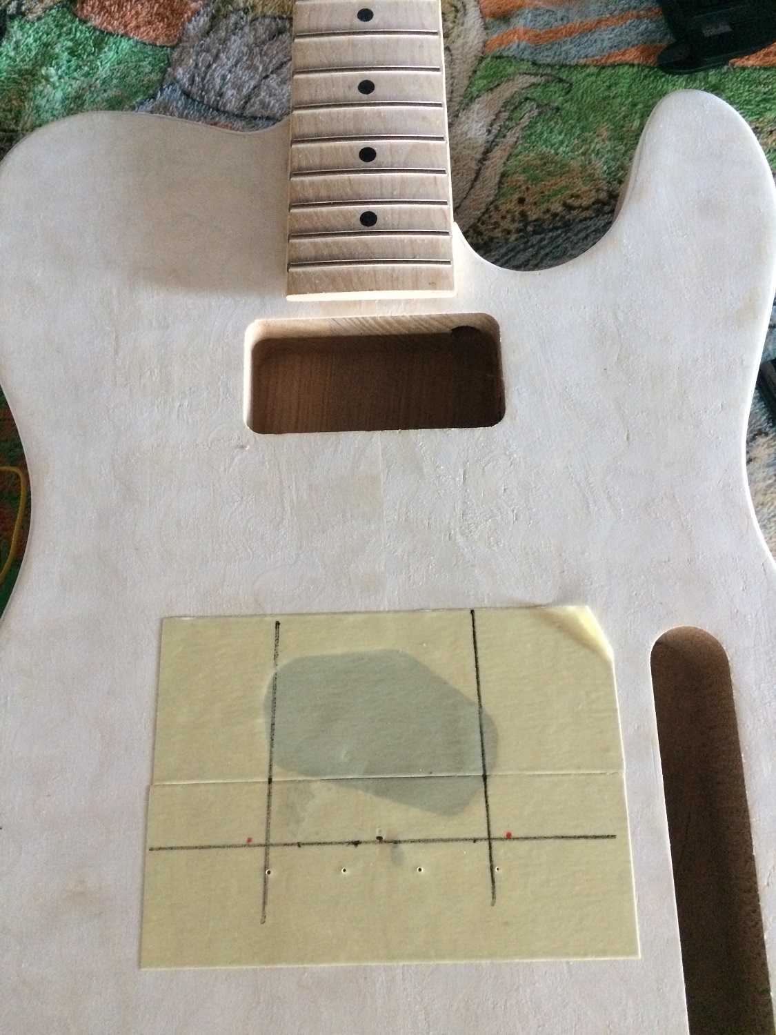

    Measuring bridge plate placement
    I've measured out the bridge plate placement and found that that I'm going to need to take some wood off to fit the new pickup/bridgeplate. The scale length ended up being 646mm, I adjusted the string compensators to about have way and lined that up with the scale length. Then I calculated the middle bridge plate placement based off the fretboard alignment Click image for larger version.
